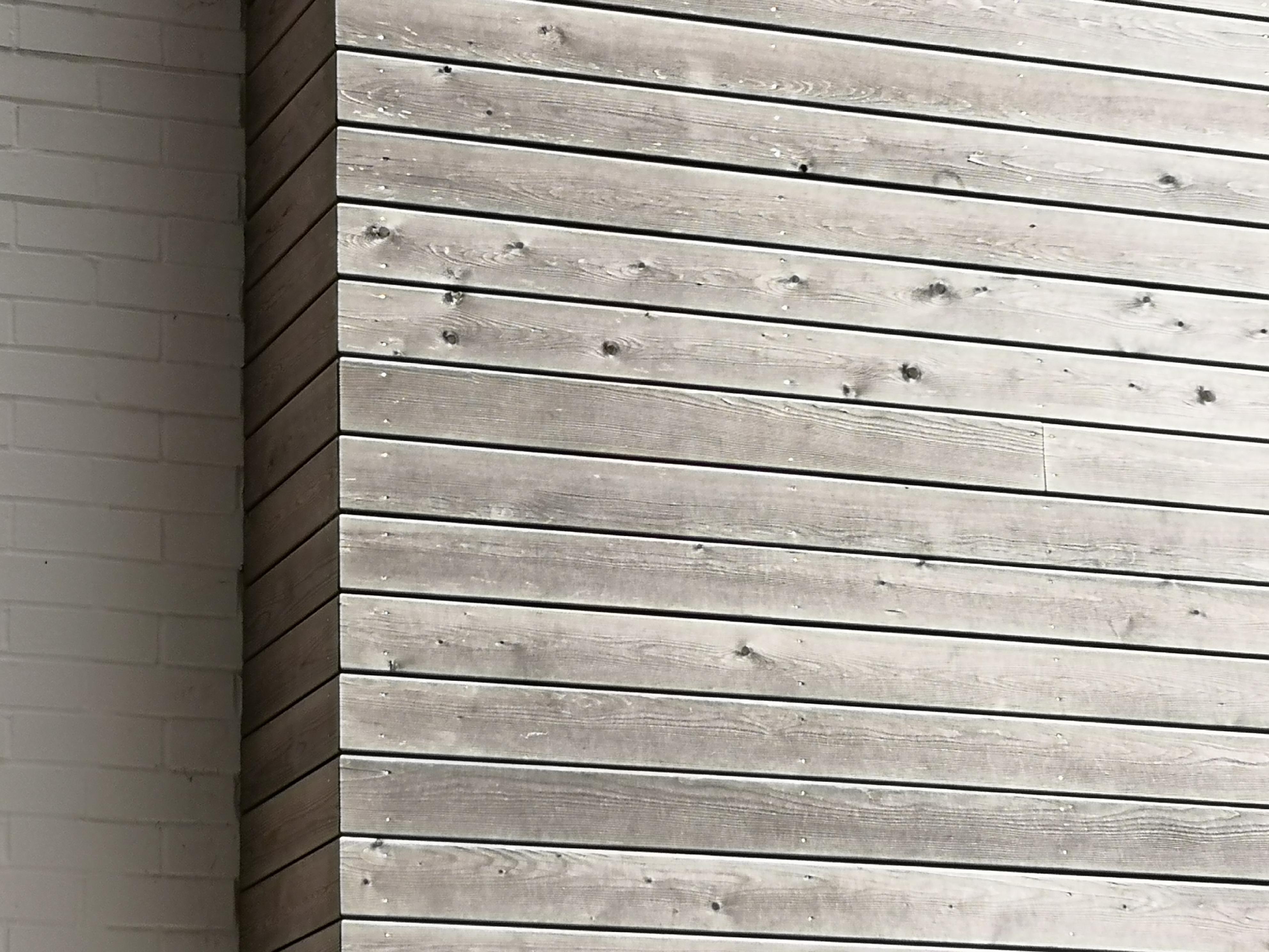

ToughButterCup Posted August 17, 2019 Author Posted August 17, 2019 5 hours ago, jack said: (...) We have 8mm gaps between our horizontal larch, (...) @jack, any chance of a photo? The reason I ask is that I don't have a clue about how big the gap should be. I'd guessed about 10 mm - busy going through cladding images looking for the shadows and trying to estimate how big the gap is ? Why not 20 mm, or 6?
jack Posted August 17, 2019 Posted August 17, 2019 I think we saw something we liked and the source mentioned an 8mm gap. Might have been something about keeping insects out too. I can't actually remember, to be honest! This is it. Siberian larch, west-facing with 4 years of weathering: 1
