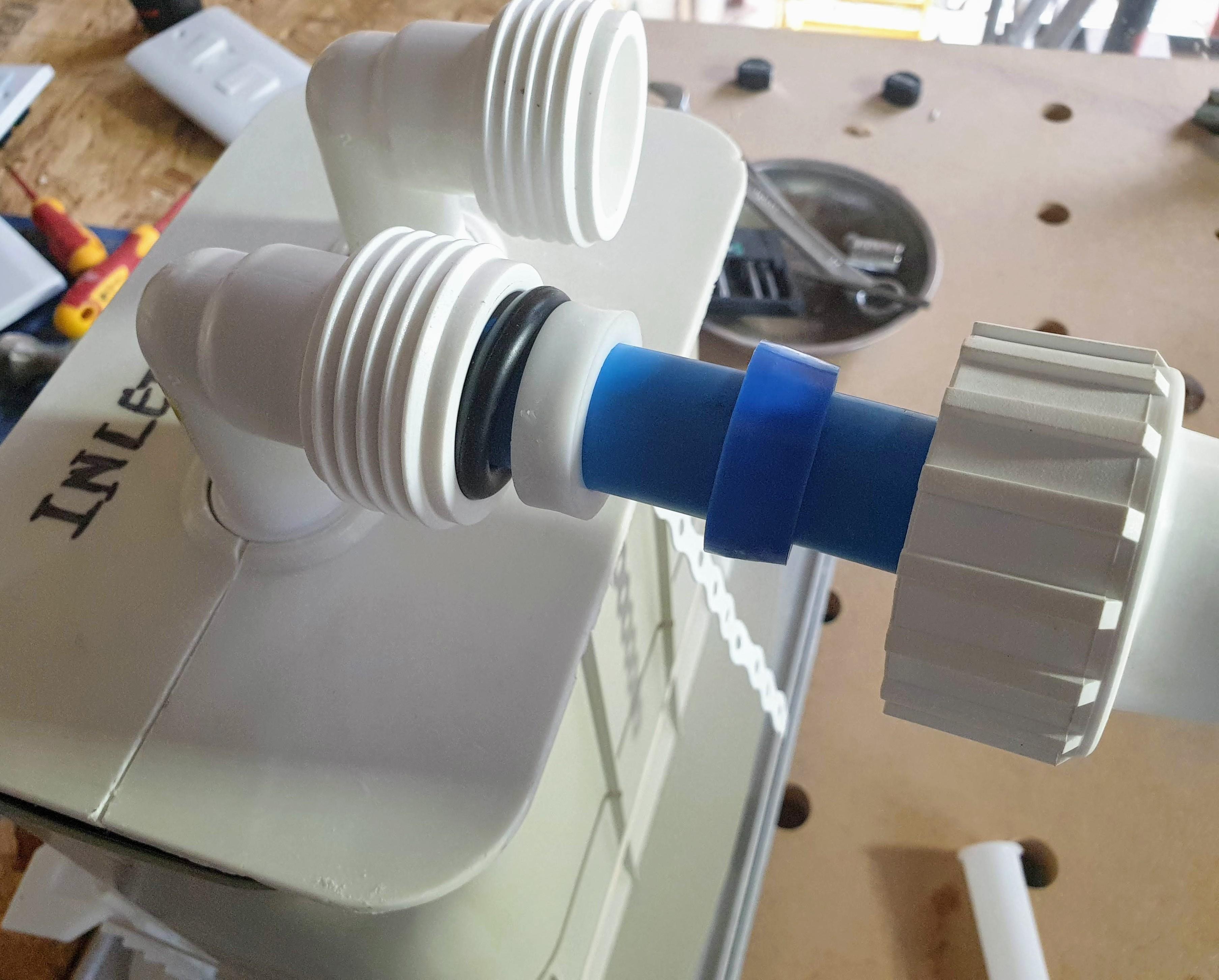

I'm installing our water meter box. Never done this before, so I'd be glad if you could give these images a quick coat of looking at, please. Comments welcome.

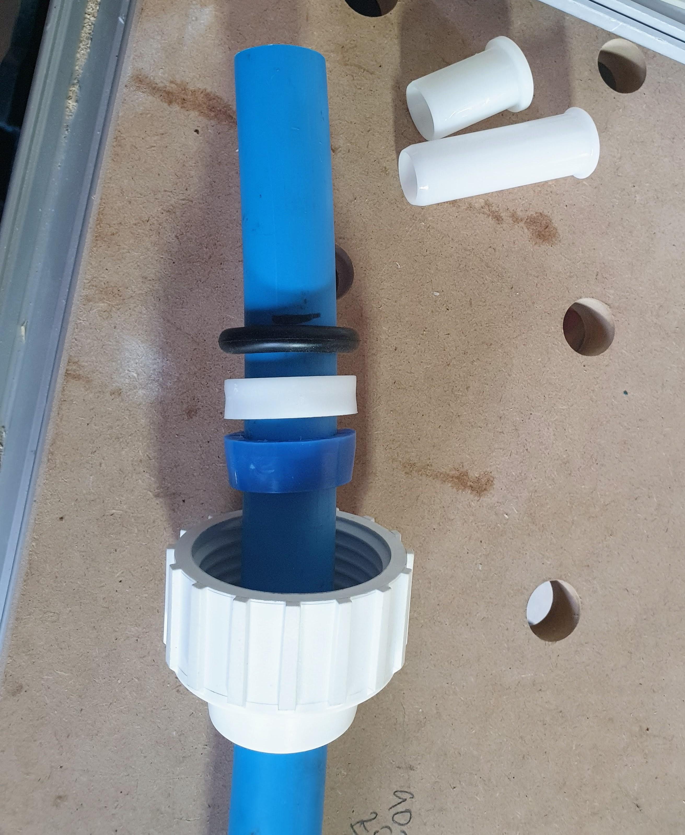

I have assembled the bits and  bobs and slid them onto a scrap piece of 25mm 'Blue' (as I now know I should call it - plumbing jargon eh?)
The bits and bobs
Quick question: use the long or the short insert - does it matter?
Inserted into the meter box in this order

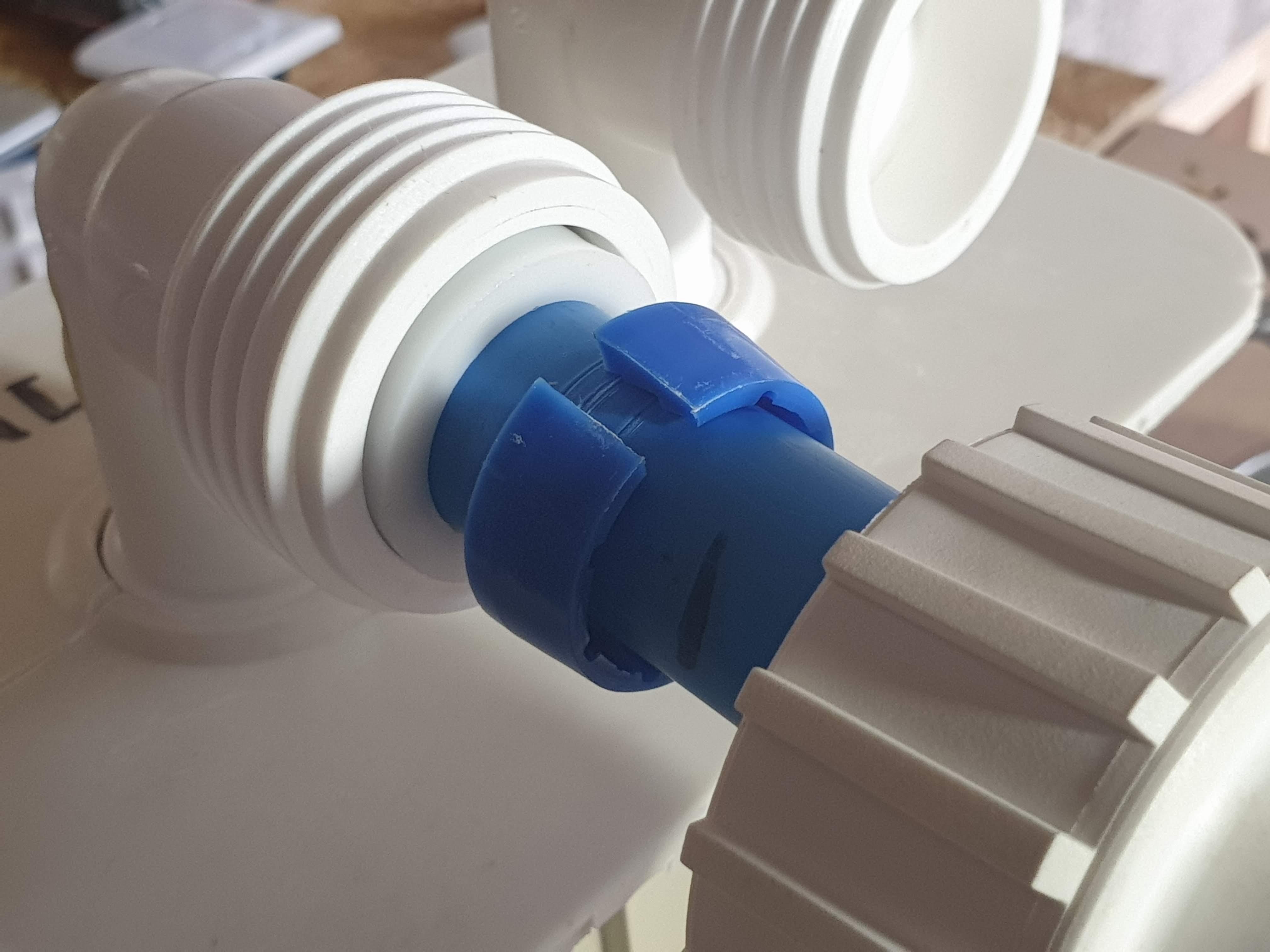

Results in this connection : do  I need that white tape stuff?
  • Which of the two sleeves above should I use ( long or short)
  • should I use Plumbers tape (? the thin white tape stuff)

Use the longer insert. Moisten everything before tightening. Don't use ptfe tape. Tighten just beyond hand tight. You'll soon know if something is wrong.

It is worth understanding the water seal is made by an O ring inside the fitting that the pipe pushes into. So debur the end of the pipe and push it in nice and square.
The blue split collar, that is clamped by the white ring that you tighten is purely there to mechanically secure the pipe to prevent it coming out.  It plays no part in making the seal, and tightening it won't stop a weep if you get one.
