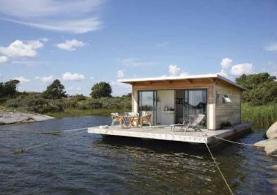

Onoff Posted August 1, 2019 Share Posted August 1, 2019 1 Link to comment Share on other sites More sharing options...
Onoff Posted August 1, 2019 Share Posted August 1, 2019 So how much buoyancy would a square metre of 300mm thick give if untethered? How about a shed cum hovercraft? Link to comment Share on other sites More sharing options...
ProDave Posted August 1, 2019 Share Posted August 1, 2019 EPS is used for floats for pontoons and houseboats. It was also used in the foundations of a car park with not quite the desired effect when it flooded Link to comment Share on other sites More sharing options...

Onoff Posted August 2, 2019 Share Posted August 2, 2019 You could incorporate a nice bottle raft in the shed base: Link to comment Share on other sites More sharing options...
