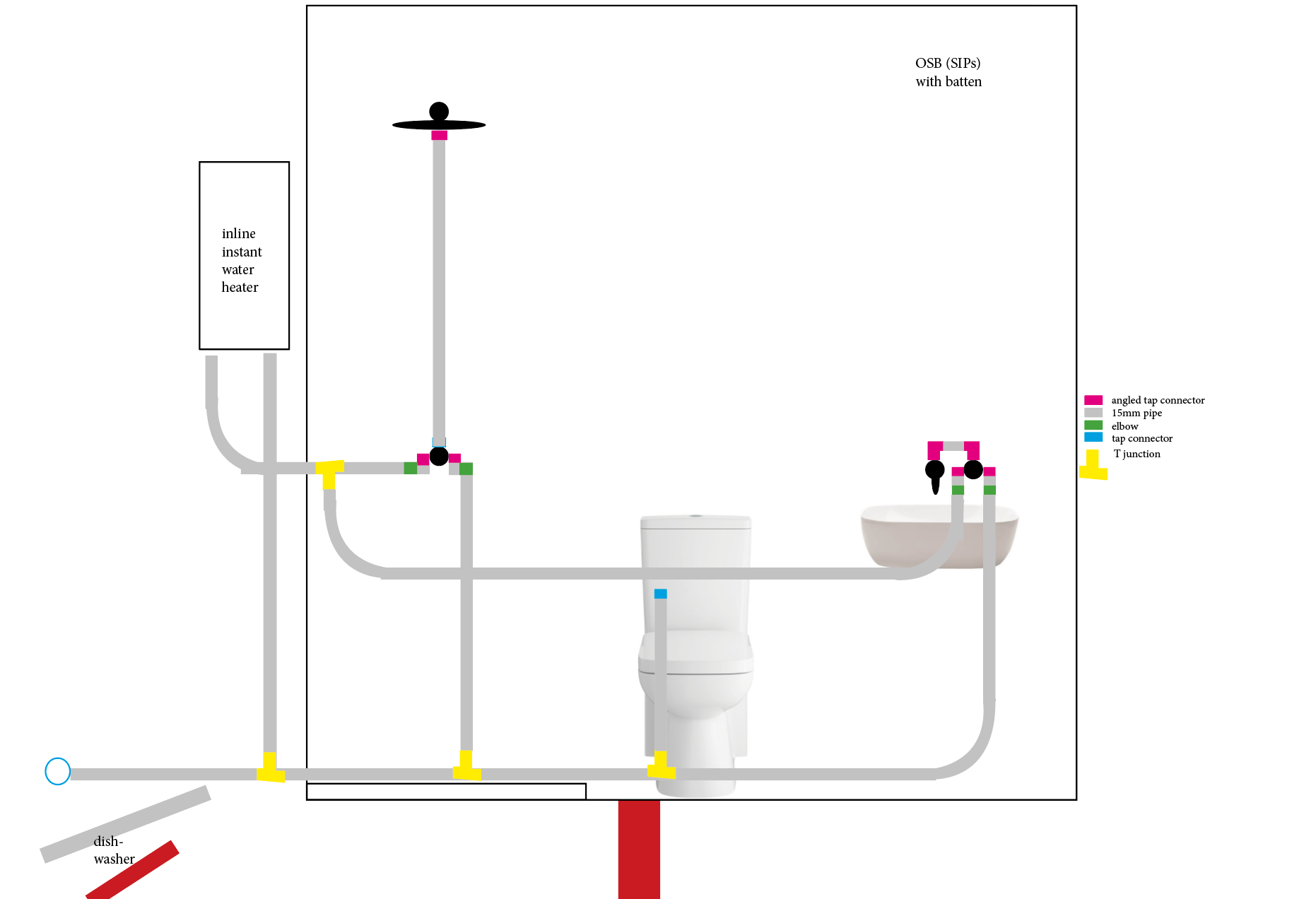

Roz Posted July 28, 2019 Share Posted July 28, 2019 (edited) So... am I mad? I stumbled upon various videos on plumbing and Hep2O got me thinking I could do the shower room in our garden studio myself........ ? I haven't figured out the waste yet, or the inline water heater stuff (does it just need a regular tap connector, etc - electrics to be done by electrician), but I started sketching what I would need on the attached. I have realised that my planned 25mm service void isnt going to be enough... which might be an issue as the stud walls are up. I left space for 25mm batten, plus 2 sides of 12mm plasterboard / tanking plasterboard. Can the plasterboard finish on top of the shower tray as that would give me the extra inch I need, or does it have to extend down the sides of the tray. Oh and I need to recess the shower and tap valves in the wall, hence the random use of multiple elbows. Is it mad to do this myself? The labour only quote I have had is about £1000 for first and second fix of this bathroom, plus a washing machine round the corner. Edited July 28, 2019 by Roz Link to comment Share on other sites More sharing options...

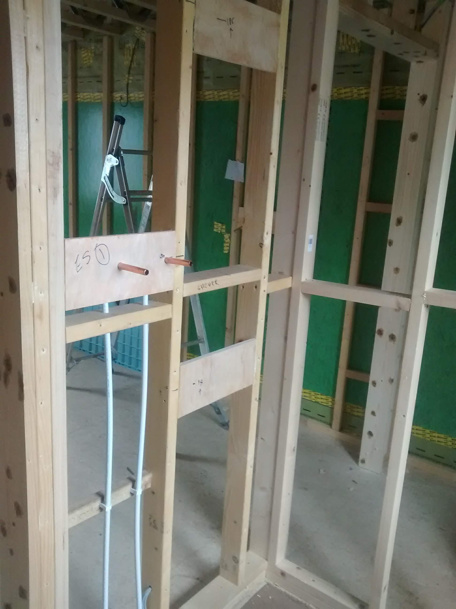

JanetE Posted August 1, 2019 Share Posted August 1, 2019 I did the hep2o plumbing in our house and with a bit of common sense and a lot of research it isn't that difficult. As @Onoff says don't forget the pipe inserts! Also the connectors are really easy to fit, just push and twist. Measure exactly where you are putting the basin, shower and toilet and bring the pipes through in the correct position. I fitted dwangs to bring them through the walls. I attach a picture to demonstrate. Bearing in mind these were stud walls. I also fitted wooden supports for the bolts on the basins. As you can see it is easy to attach copper pipe tails into the hep2o fittings. Have a look at YouTube, there are some good demos there. 2 Link to comment Share on other sites More sharing options...

JanetE Posted August 1, 2019 Share Posted August 1, 2019 @Roz the 'copper bits' are the tails that feed the hot and cold water to the shower. Link to comment Share on other sites More sharing options...
Roz Posted August 1, 2019 Author Share Posted August 1, 2019 8 minutes ago, JanetE said: @Roz the 'copper bits' are the tails that feed the hot and cold water to the shower. That makes sense. I think because our shower mixer is concealed that was why I haven't planned on using them well i will certainly post with questions when I come to tackle it... maybe over the weekend ? Link to comment Share on other sites More sharing options...

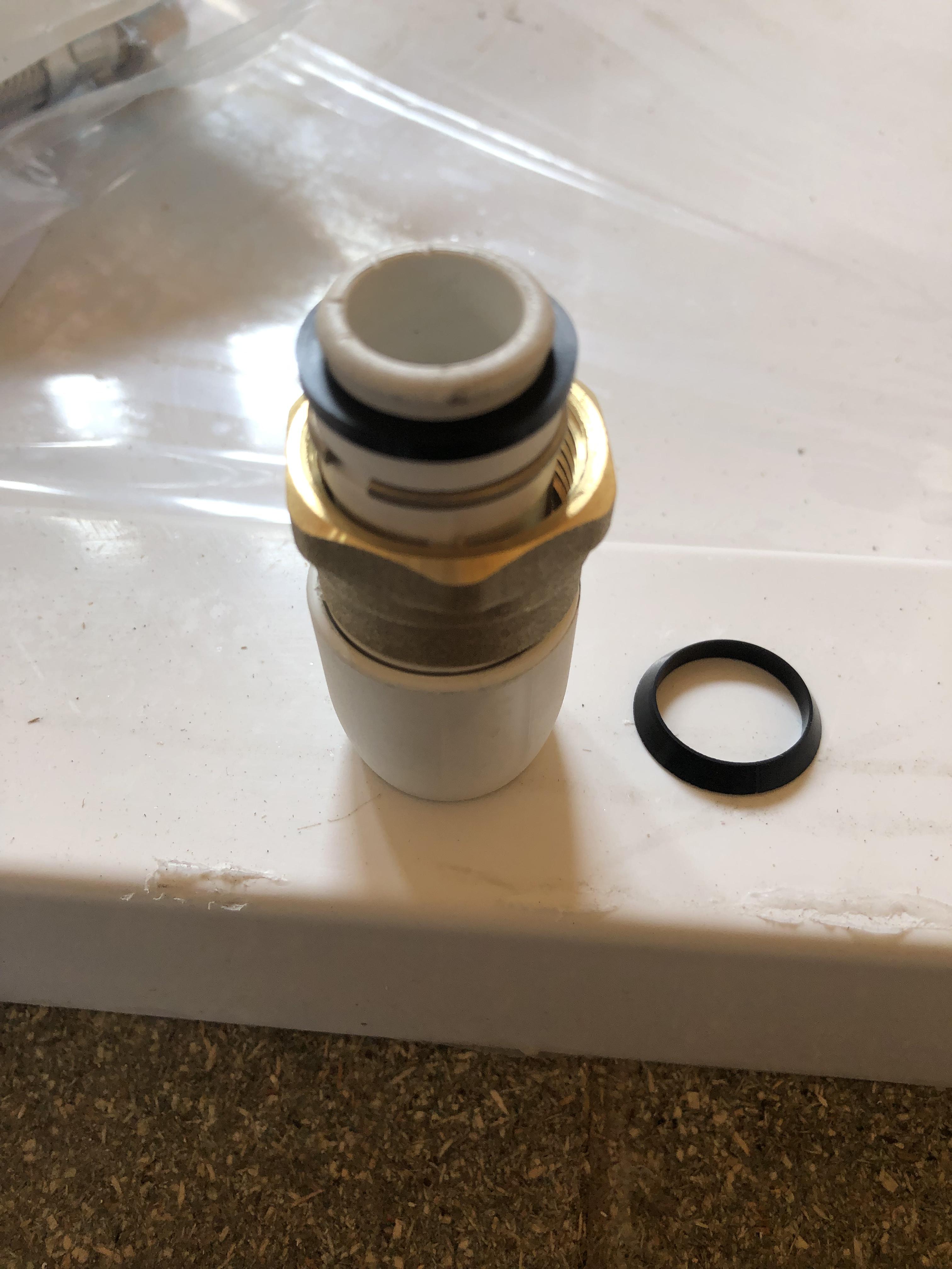

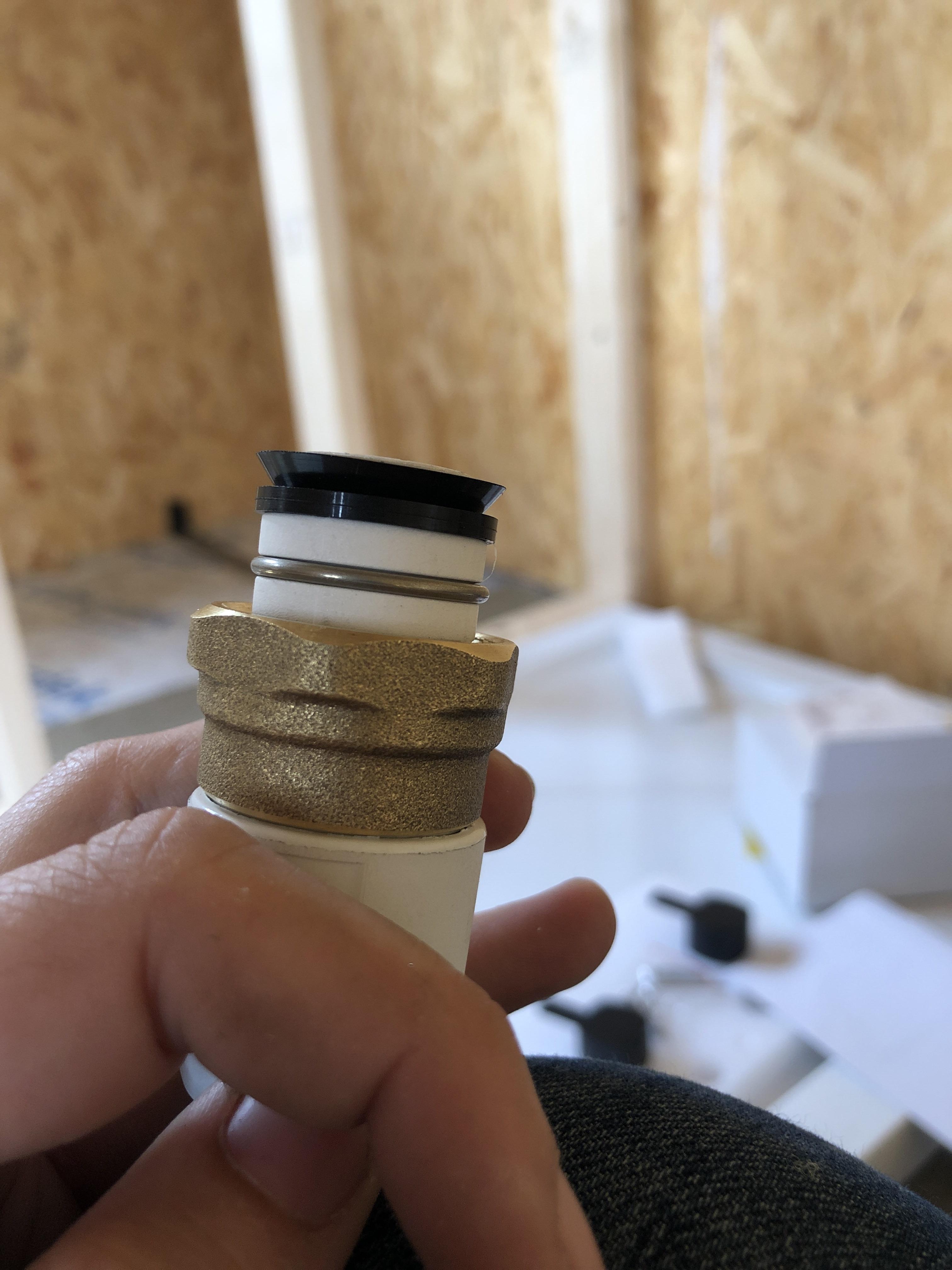

Roz Posted August 4, 2019 Author Share Posted August 4, 2019 Ok I have been taking a look at what I’ve got and have a quick question. Ive got some straight tap connectors 3/4 inch. They have an extra washer in the packet and it’s angled... Do I put it on the end? Which way up? Also the shower instructions say to use ptfe but that’s not necessary with these is it? Link to comment Share on other sites More sharing options...
Onoff Posted August 4, 2019 Share Posted August 4, 2019 Picture 1. Look on the bottom of the tap it's going onto. Might have the inside edge of the hole up it chamfered a little that the angled rubber seats against. No need for PTFE with these. Imho. Link to comment Share on other sites More sharing options...

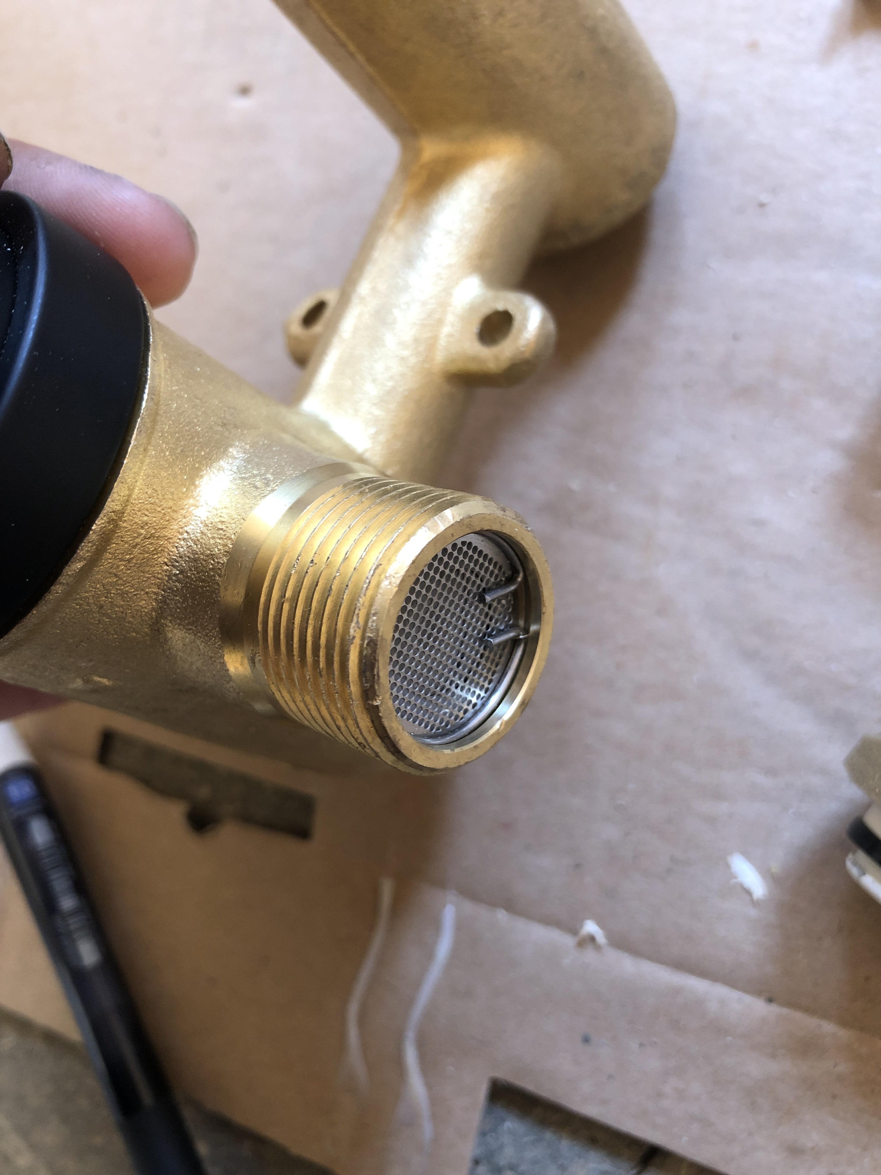

Roz Posted August 4, 2019 Author Share Posted August 4, 2019 11 minutes ago, Onoff said: Picture 1. Look on the bottom of the tap it's going onto. Might have the inside edge of the hole up it chamfered a little that the angled rubber seats against. No need for PTFE with these. Imho. Hey onoff... here is the tap it’s going onto if that’s what you mean Link to comment Share on other sites More sharing options...
Onoff Posted August 4, 2019 Share Posted August 4, 2019 (edited) 2 hours ago, Roz said: Hey onoff... here is the tap it’s going onto if that’s what you mean Ok a flat face not a chamfer. Hold the connector, with the rubber washer as in your picture 2 against this. You should see as the nut tightens up it'll squash the rubber in / against this. Hand tight plus a bit is usually all you need. Have read once hand tight then tighten a 6th of a turn more so one flat face more round. Edited August 4, 2019 by Onoff 1 Link to comment Share on other sites More sharing options...
