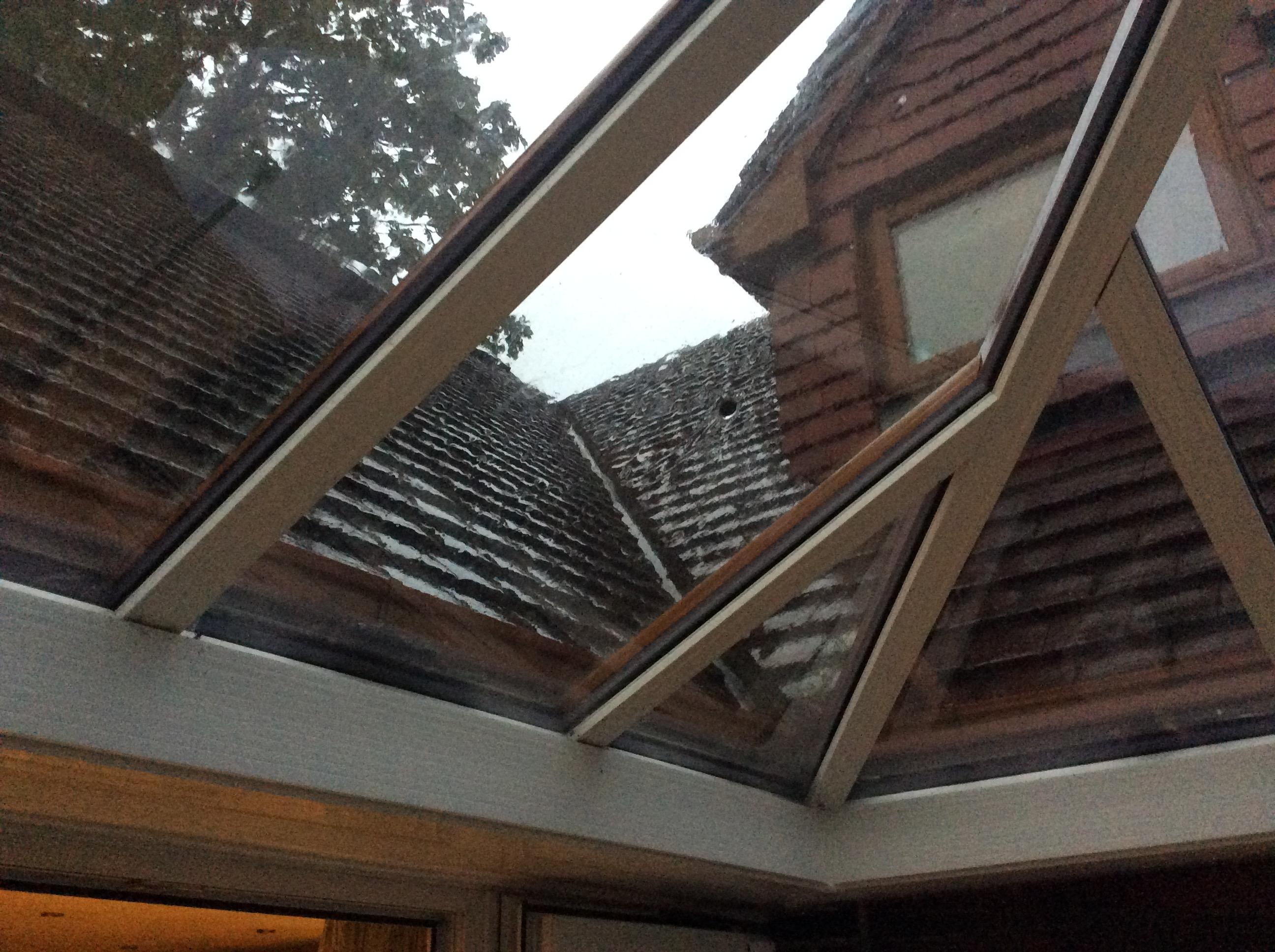

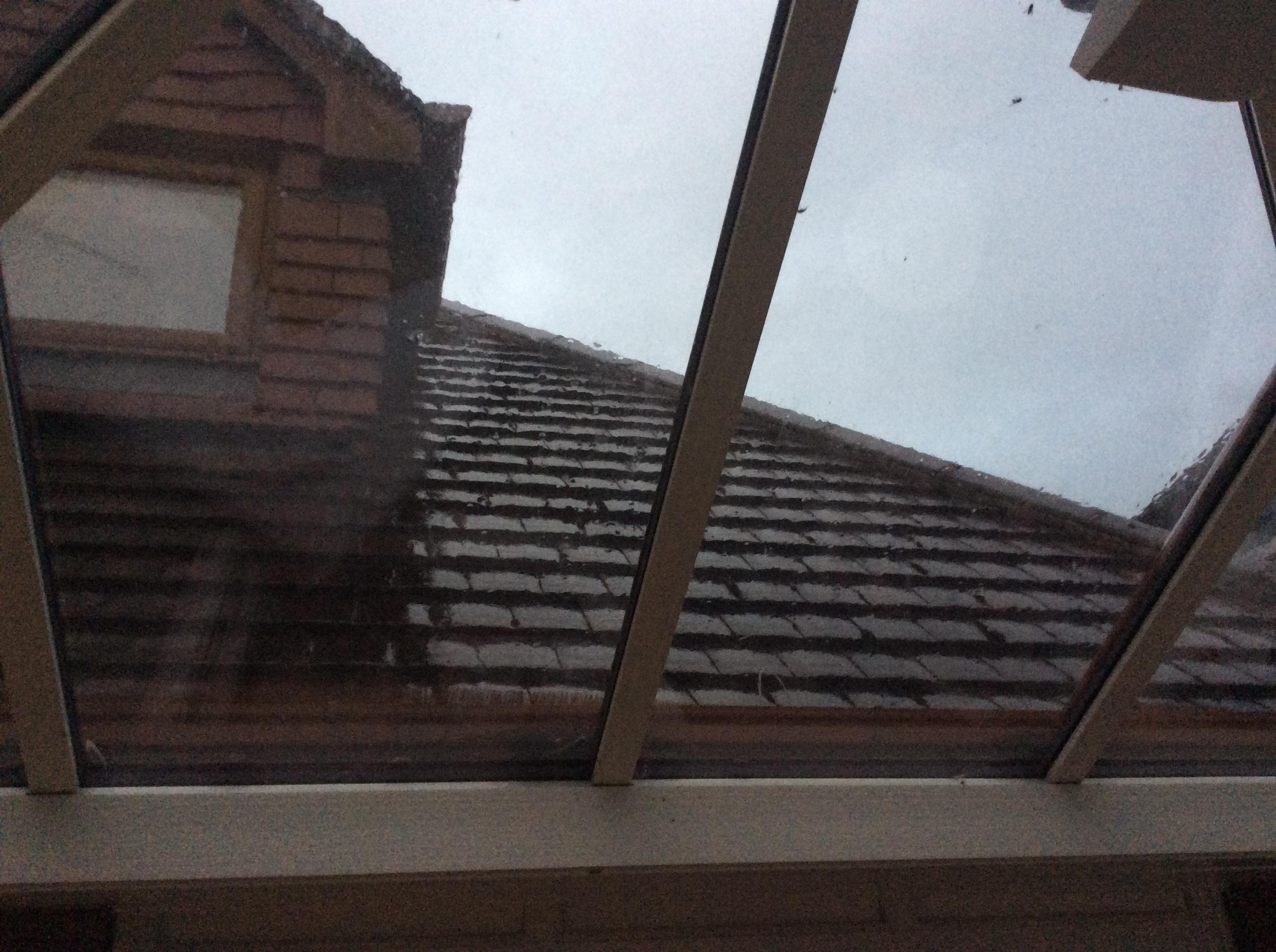

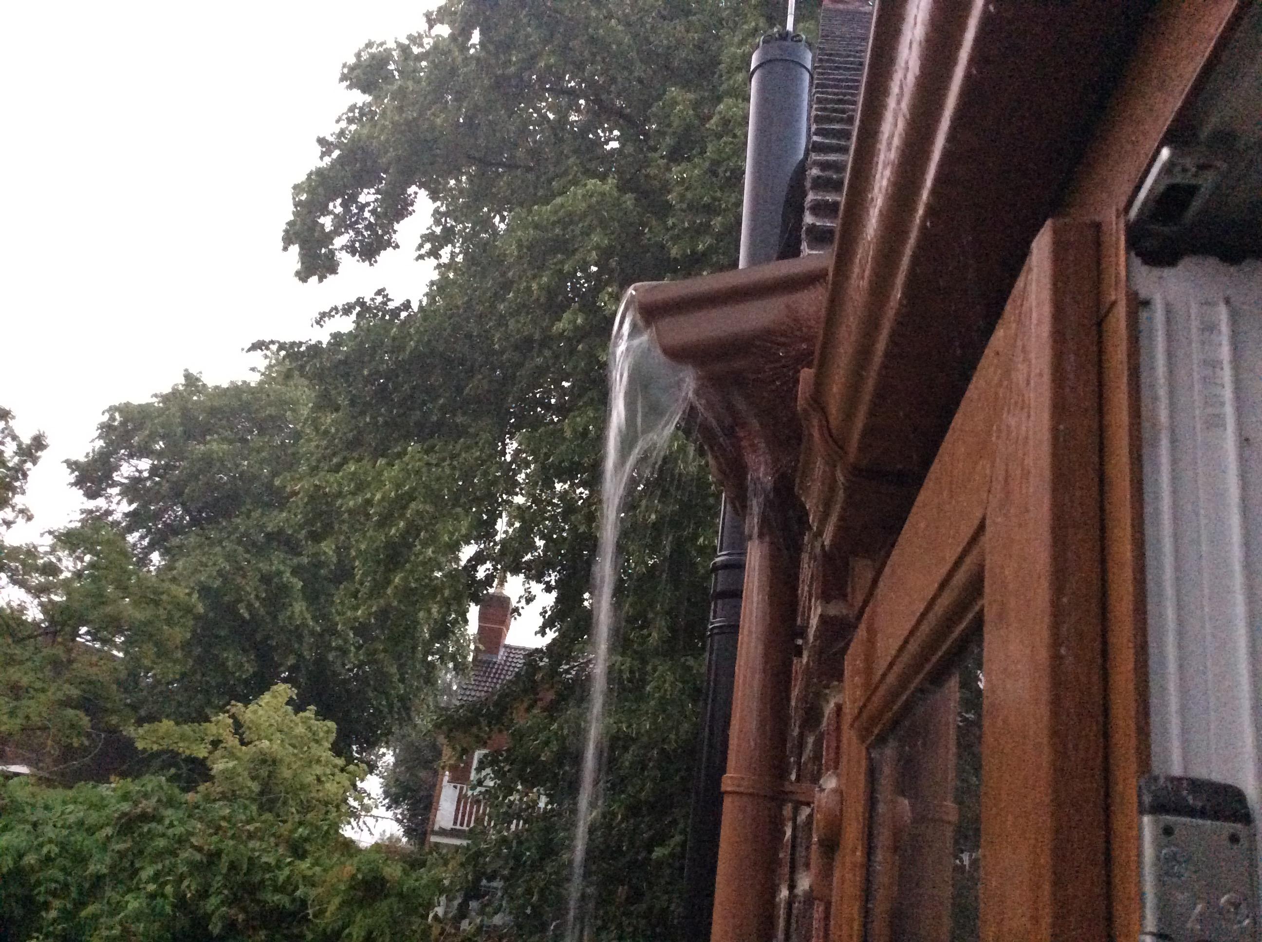

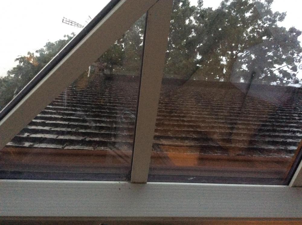

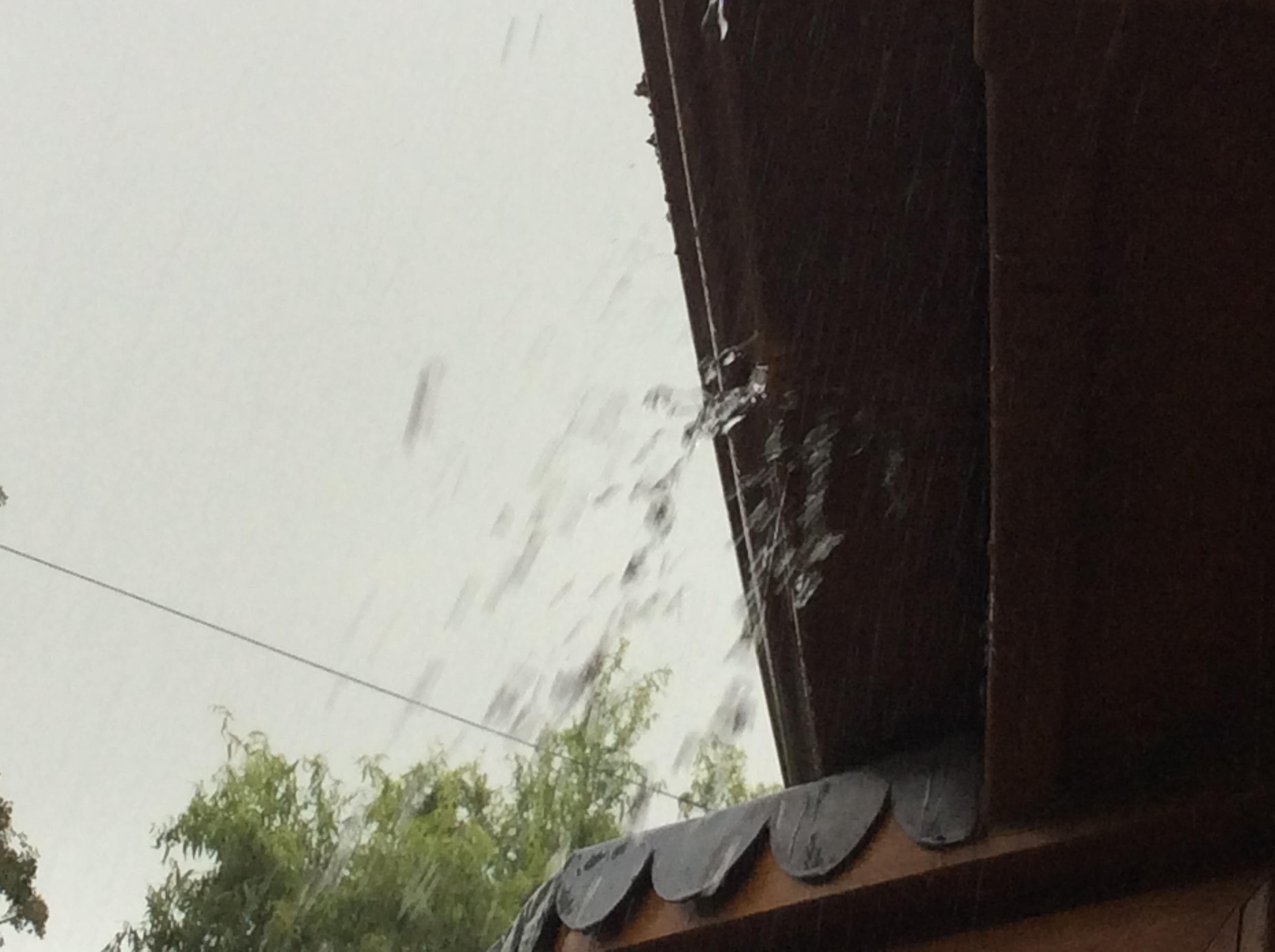

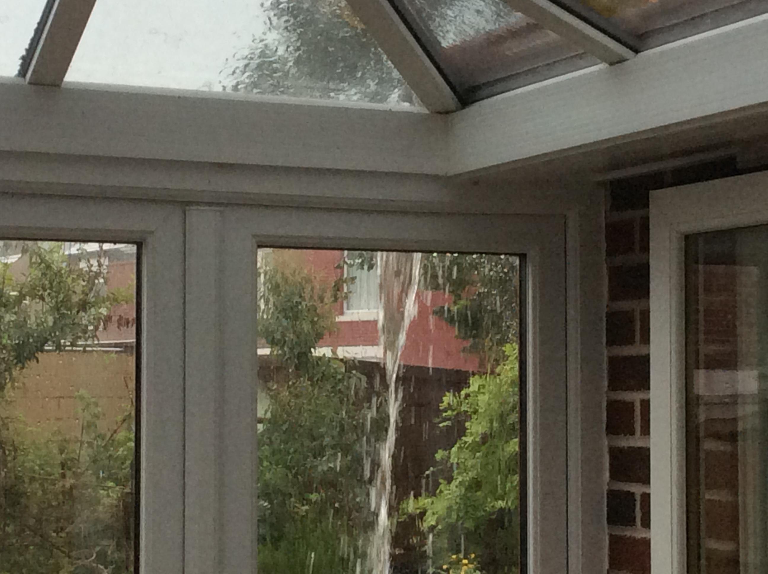

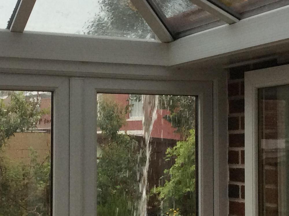

Ferdinand Posted July 28, 2019 Share Posted July 28, 2019 (edited) I have this problem both front and back. Here are a couple of piccies of the gutters overflowing. The core issue istm is that both gutters carry the runoff from about 40sqm of roof, and it comes 80% down a single valley as it is a large roof with big gables. Here is one: I would say that the answer is 1 - Deep flow gutters on the sections to catch the heavy flow. 2 - A couple of extra downpipes. Untidy. 3 - Something to slow the velocity of flow n the valley some distance up the roof. Thoughts welcome. Ferdinand Edited July 28, 2019 by Ferdinand Link to comment Share on other sites More sharing options...

lizzie Posted July 28, 2019 Share Posted July 28, 2019 I had pieces of lead used as diverters to slow the the flow but that was on a tiled roof and have no idea what sort of roof covering you have. It was very successful for me on a large roof. Link to comment Share on other sites More sharing options...

lizzie Posted July 28, 2019 Share Posted July 28, 2019 17 minutes ago, Ferdinand said: it is Marley something tiles. I had that sort of tile. Tried to find a pic to show diverters on main roof but not much luck. Attached is an old pic back of garage see small piece of lead shaped to divert and slow flow as it comes down On the other side of the house I had some big steep valleys with several diverters, roofer placed them. When I had some cleaning work done on guttering outside my front porch they unknown to me removed diverters going into gutters and when it next rained we had a waterfall over the front door....queue roofer to reinstate lead diverters. Any experienced roofer will know how and where to place these. Link to comment Share on other sites More sharing options...
lizzie Posted July 28, 2019 Share Posted July 28, 2019 @Ferdinand If you blow up pic and look above parasol in corner where glass roof joins tiles you can just see lead diverter taking the water down into the gutter and away from the glass roof. We had normal gutters and downpipes and a huge roof and no problems with these diverters in place. 1 Link to comment Share on other sites More sharing options...
ragg987 Posted July 28, 2019 Share Posted July 28, 2019 It looks like you are overflowing at the end of the run - where the downpipe is. Suggests either that the gutter slope is too high so water is rushing down it, or perhaps the hole in the gutter connecting to downpipe is too small or obstructed. You gutter supplier should have some documentation on slope as well as number of downpipes for the area of roof. If the single downpipe is not adequate then you might have to use a larger diameter pipe - slowing / diverting water on roof or deeper gutters will not solve it, only delay it. Link to comment Share on other sites More sharing options...
Ferdinand Posted July 28, 2019 Author Share Posted July 28, 2019 (edited) 1 hour ago, ragg987 said: It looks like you are overflowing at the end of the run - where the downpipe is. Suggests either that the gutter slope is too high so water is rushing down it, or perhaps the hole in the gutter connecting to downpipe is too small or obstructed. You gutter supplier should have some documentation on slope as well as number of downpipes for the area of roof. If the single downpipe is not adequate then you might have to use a larger diameter pipe - slowing / diverting water on roof or deeper gutters will not solve it, only delay it. My original gutter supplier was the @#£&*()’l self builder who did the conversion before I bought it. ? TBf there have not been many problems. I think the issue is really speed of water hitting the gutter on one side, and as you say the other. Roof angle is 5x degrees iirc, and the roof length on the slope is about 6-7m. The gutter run around that conservatory is slightly complicated, and at pr3sentvtg3 corner a5 the bottom F th3 valley has debris. I think the only way to clear that one is to go up on the conservatory with a crawler whenever it happens. Separate issue. F Edited July 28, 2019 by Ferdinand Link to comment Share on other sites More sharing options...
Temp Posted July 28, 2019 Share Posted July 28, 2019 We have two places where the gutter sometimes overflows. It's because gables and dormers create a lot of roof area feeding water to only a short length of gutter and one down pipe. Nothing we can easily do without fitting an enormous wide custom made gutter/hopper that would look ridiculous. Fortunately it only overflows in really heavy rain not the usual showers. Link to comment Share on other sites More sharing options...
