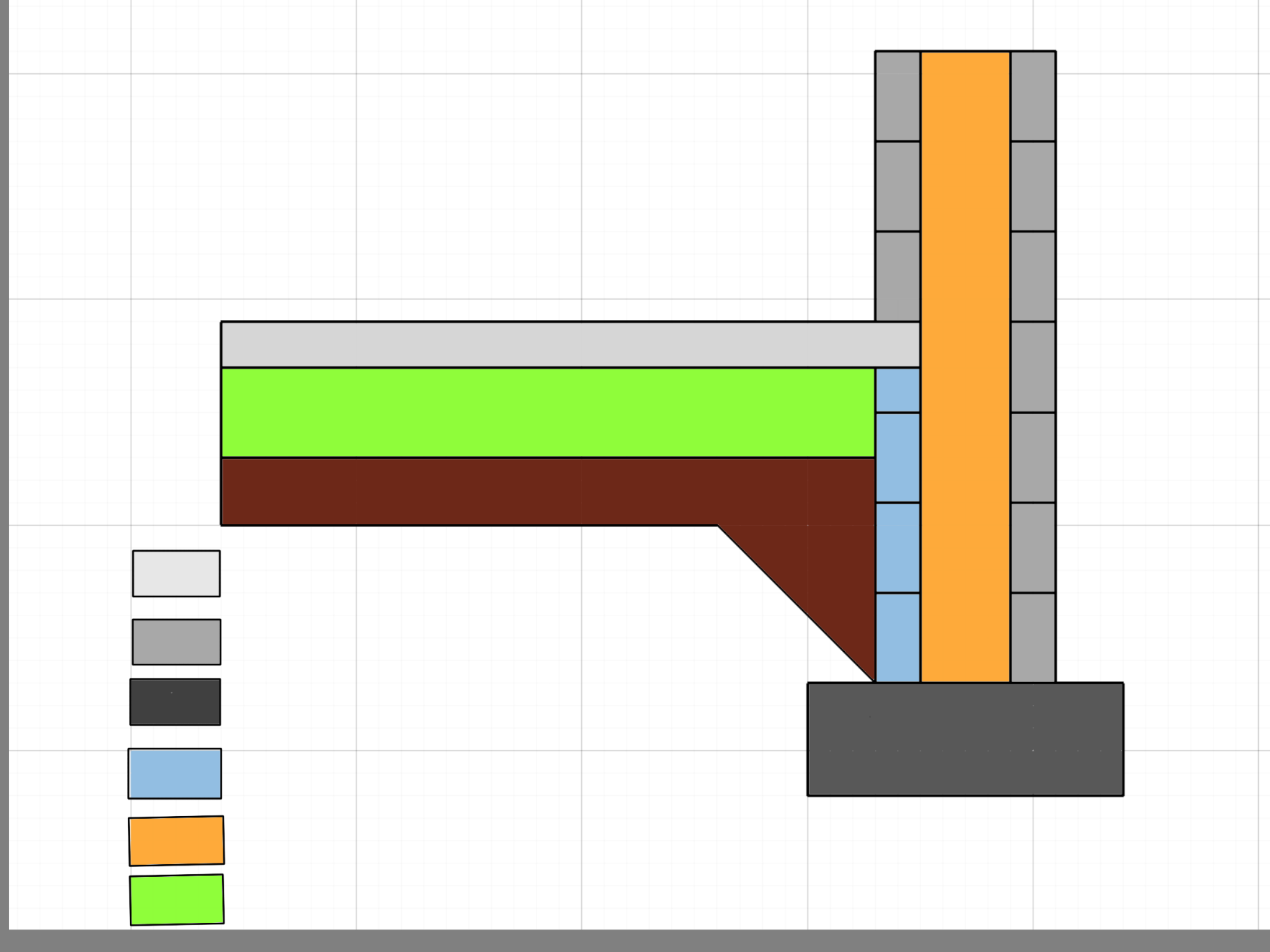

K78 Posted July 24, 2019 Share Posted July 24, 2019 What is the best value cavity wall insulation at 200mm? The kingspan boards are too expensive. Would 200mm of earth wool be a good idea? Thanks Link to comment Share on other sites More sharing options...
Visti Posted July 24, 2019 Share Posted July 24, 2019 Below or above DPC? We went with EPS below for waterproofness, and cellulose above. Link to comment Share on other sites More sharing options...
K78 Posted July 24, 2019 Author Share Posted July 24, 2019 Just now, Visti said: Below or above DPC? We went with EPS below for waterproofness, and cellulose above. Above DPC. I’m using eps blow ground level on walls and foundation. Link to comment Share on other sites More sharing options...
PeterW Posted July 24, 2019 Share Posted July 24, 2019 Use EPS board below DPC and EPS blown beads above DPC. 1 Link to comment Share on other sites More sharing options...
Visti Posted July 24, 2019 Share Posted July 24, 2019 If you want to blow/inject it, you could go for technitherm by isothane which is an expanding polyurethane. Great u value and quick to install but is expensive compared to blown beads As you have to get it installed by a licenced installer. There are other less expensive polyurethane foams out there, but depend on whether they are above or below DPC 1 Link to comment Share on other sites More sharing options...

joe90 Posted July 25, 2019 Share Posted July 25, 2019 (edited) I am another who used 200mm earth wool above DPC and extruded poly below as per golcar https://www.greenbuildingstore.co.uk/golcar-passivhaus-ground-floor-foundations/ bricklayers were good (no snots in the cavity) and inserted it as they went. Edited July 25, 2019 by joe90 1 Link to comment Share on other sites More sharing options...
PeterW Posted July 25, 2019 Share Posted July 25, 2019 35 minutes ago, epsilonGreedy said: Indeed and as photos posted here previously demonstrate, voids in fitted of cavity batts occur. Thinking about this some more I reckon the risk of voids in blown beads reduces in cavities wider than 100mm. How much faster would a brickie team work if not fitting insulation cavity batts as they go? A lot quicker - just make sure they keep snots out of the cavity. 150mm is ok, 175mm gets you more and 200mm is ideal but needs longer wall ties. I’ve got the name of an excellent company in Sheffield if you want an installer. Link to comment Share on other sites More sharing options...
