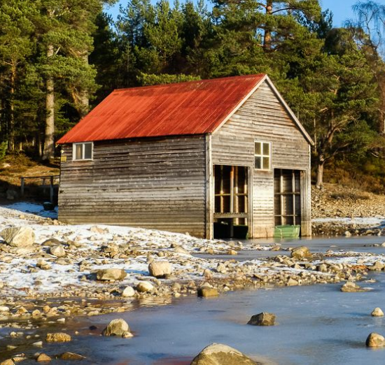

ultramods Posted July 24, 2019 Posted July 24, 2019 As my current self build is concluding I have started thinking again about building a holiday house near Aviemore. I really like the idea of building a house using materials that looks like the boat house below: Reclaimed Corrugated metal sheets for the roof and weathered Larch. Would it be possible to use reclaimed metal corrugated sheets for the roofing if underneath the reclaimed sheets the actual watertight roofing was one of the materials used for flat roofs? Or could the reclaimed sheets be bonded onto thin plastic corrugated sheets of the same size and profile? I have looked into the options of using Cor-ten steel, however it would be far too expensive.
Ian Posted July 24, 2019 Posted July 24, 2019 (edited) There's quite a few proprietary systems on the market for roofing that would allow you to do exactly what you asked eg: https://www.kingspan.com/gb/en-gb/products/insulated-panel-systems/roof-panel-systems/slate-tile-support-roof-panels-ks1000-ts Edited July 24, 2019 by Ian 1
ultramods Posted July 24, 2019 Author Posted July 24, 2019 5 minutes ago, Ian said: There's quite a few proprietary systems on the market for roofing that would allow you to do exactly what you asked eg: https://www.kingspan.com/gb/en-gb/products/insulated-panel-systems/roof-panel-systems/slate-tile-support-roof-panels-ks1000-ts Thank you. Do you know what a rough cost psm of such a system would be?
Ian Posted July 24, 2019 Posted July 24, 2019 Sorry I don't know the cost of it. I've only used it once which was on a commercial project a while ago. It worked very well and was very quick to install. I also used this product on a large domestic extension quite a few years ago. https://onduline.co.uk/products/ondutile/ I couldn't meet the minimum roof pitch for an interlocking roof tile so installed the Onduline under the tiles. As far as the Building Inspector was concerned the Onduline was the roof that gave the weather protection and the concrete roof tiles were purely cosmetic. 1
ultramods Posted July 24, 2019 Author Posted July 24, 2019 8 minutes ago, Ian said: Sorry I don't know the cost of it. I've only used it once which was on a commercial project a while ago. It worked very well and was very quick to install. I also used this product on a large domestic extension quite a few years ago. https://onduline.co.uk/products/ondutile/ I couldn't meet the minimum roof pitch for an interlocking roof tile so installed the Onduline under the tiles. As far as the Building Inspector was concerned the Onduline was the roof that gave the weather protection and the concrete roof tiles were purely cosmetic. Thanks again for this, I will contact both companies to try and get rough pricing.
