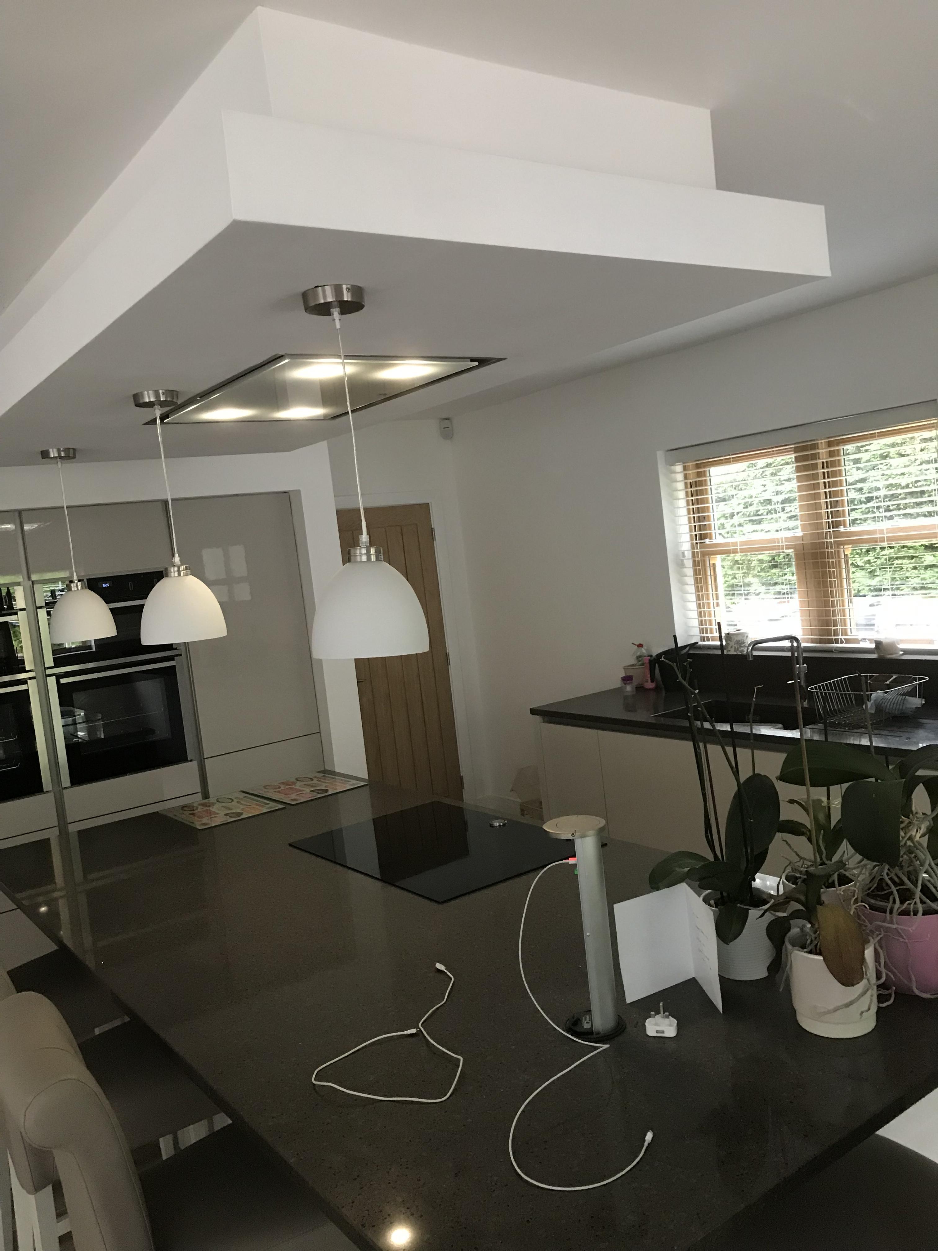

I did this if it’s any help
All singing all dancing Italian extractor To be dare we have only used on the lowest setting
That does look awesome. Unfortunatly my ceilings are not that height and with the beams something like that might look silly. I would much prefer a ceiling extract...is that luxair?
Out of interest, what it the distance between your island top and the extractor?
I build quite a lot of these and always line them with the door openings 2110 Giving about 1200 from extractor to worktop
Building these bulkheads is only really needed to get around joists etc. In a new build there is no reason why these extractors shouldnt go flush into the ceiling.   Ceiling hoods are great for extracting odours but not necessarily to remove grease.
On a downdraft hood, your grease filter should be catching most of the grease and very little getting into the ductwork.
