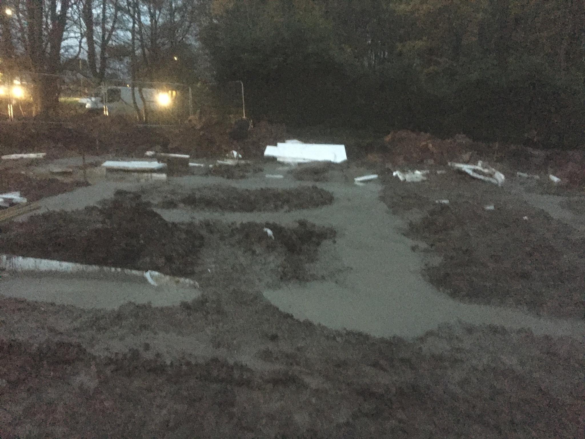

nod Posted July 17, 2019 Share Posted July 17, 2019 12 hours ago, gwebstech said: Hi all Im getting ready to pour my concrete into the trench weve dug. The trench is about 1m deep, the building notes say 700mm conrete into that, then build the substructure from either 7n concrete blocks and or engineering bricks. Seeing as laying the initial first courses in the superstructure is slow and time consuming (ie expensive as i cant lay bricks well) im wondering what the maximum depth of concrete i can pour in? i know the engineering bricks/blocks have to be filled with concrete to strengthen them, but am i determined by where the DPC will be and the concrete cavity fill has to be a certain depth below the DPC? Can i put more concrete in and save a couple of courses of bricks? thanks Our footings were between 1500 and 1800 deep There was a delay in starting which meant a November start The whole site was flooded So I took the decision to full fill the trenches This saved me time and money 1 Link to comment Share on other sites More sharing options...
