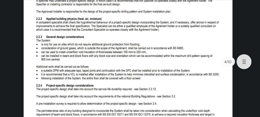

S2D2 Posted January 30, 2023 Posted January 30, 2023 15 hours ago, ADLIan said: Only for new build. Not sure how you’d retrofit a dpm under an existing b&b floor?? Under existing Appr Docs and British Standards adding the insulation layer under b&b floor makes it a ‘solid’ floor which requires a dpm. Yes, still no luck for retrofitting unfortunately, from the technical docs:

S2D2 Posted January 30, 2023 Posted January 30, 2023 1 minute ago, MikeGrahamT21 said: What is the issue with just sticking some PIR on top of the slab, and then float a chipboard floor on top of that? Appreciate you'd lose a bit of height, but surely worth it? From what I've seen this issue mostly applies to 90's houses where the common build up is block and beam, 50mm EPS, floating chipboard floor. Worse, like mine, big gaps are often left in the EPS to run ground floor heating pipes... So the insulation is okay (read: better than nothing), but there's a bunch of space under the beam and block that won't be on show that it feels like there should be a solution to add a boatload of insulation to. The lack of a DPM is a key limitation though as ground gases can't be ignored.
