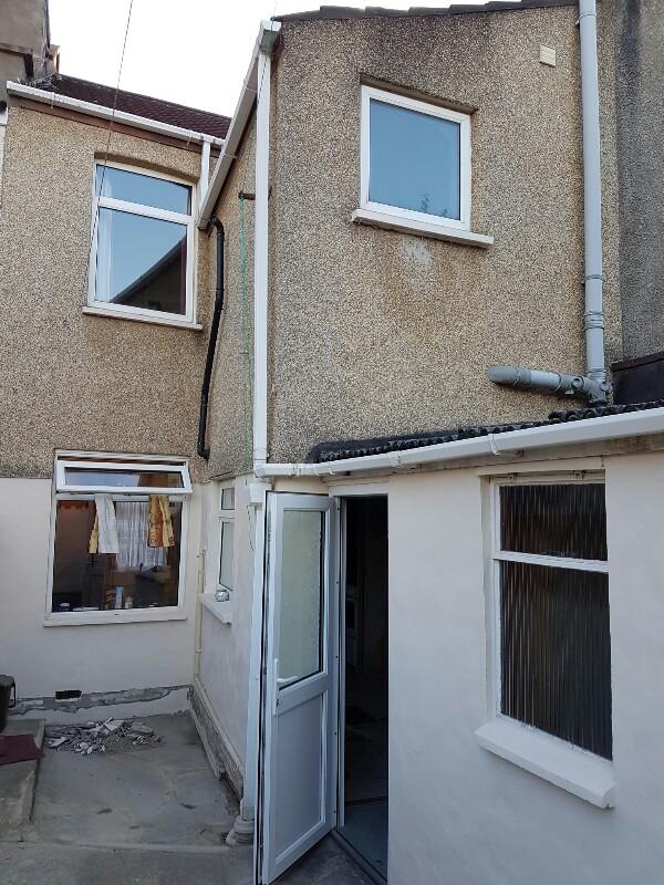

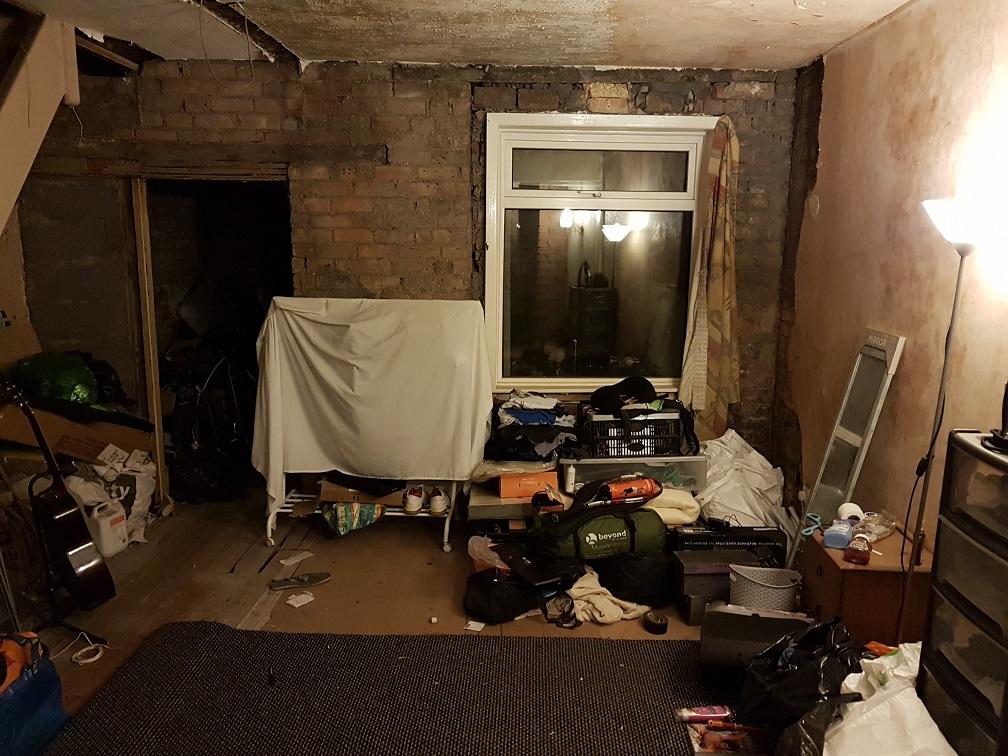

Student Posted July 9, 2019 Share Posted July 9, 2019 Hi I'm hoping to convert a downstairs, rear window into a set of french doors out into my garden, I'll leave the opening the same width or maybe even go narrower. It's a Victorian terrace and the existing lintel is the original timber one. The image I've attached is an old photo showing the lintels in that room, though those wall are now plastered. Do you see any reasons structurally why the brickwork at the bottom of the window can just be cut and knocked through? I've also attached a view of the window from the outside (it's the downstairs window on the main house, not any of the extensions). Appreciate any advice. Link to comment Share on other sites More sharing options...
Mr Punter Posted July 9, 2019 Share Posted July 9, 2019 Normally the answer would be no problem, go ahead, but the inside picture does not show a lintel above the window and it looks like the top has been infilled with brickwork built off the top of the window. I may be that there is a proper lintel above this, but it is hard to tell. Link to comment Share on other sites More sharing options...
Patrick Posted July 9, 2019 Share Posted July 9, 2019 Just now, Mr Punter said: Normally the answer would be no problem, go ahead, but the inside picture does not show a lintel above the window and it looks like the top has been infilled with brickwork built off the top of the window. I may be that there is a proper lintel above this, but it is hard to tell. Agreed. I ve done the exact same at my semidetached, just took the window out and cut down to the floor with a concrete cutter, but there was a lintel above the window, so this might be a problem. If there's is none at yours, you want to stabilise the ceiling first, then knock the window out and put a lintel in before doing the door Link to comment Share on other sites More sharing options...
Student Posted July 9, 2019 Author Share Posted July 9, 2019 Thanks guys. There is a lintel there, it's almost at ceiling level so hard to see. You can probably see it if you look closely, the left end of it is level with the right side of the doorway lintel and the right side of the window lintel is about 100mm away from the corner of the room. It's by no means the most substantial looking lintel but it's the same size as others in the house. I've since replaced the doorway lintel with a concrete one as the plasterer thought it looked damaged. Had I been able to replace the window lintel without damaging the ceiling, I would have. The simplest, non-invasive solution would be to add a concrete lintel below the timber one but I'm hoping I can get away with just cutting the bottom of the window away! Link to comment Share on other sites More sharing options...
