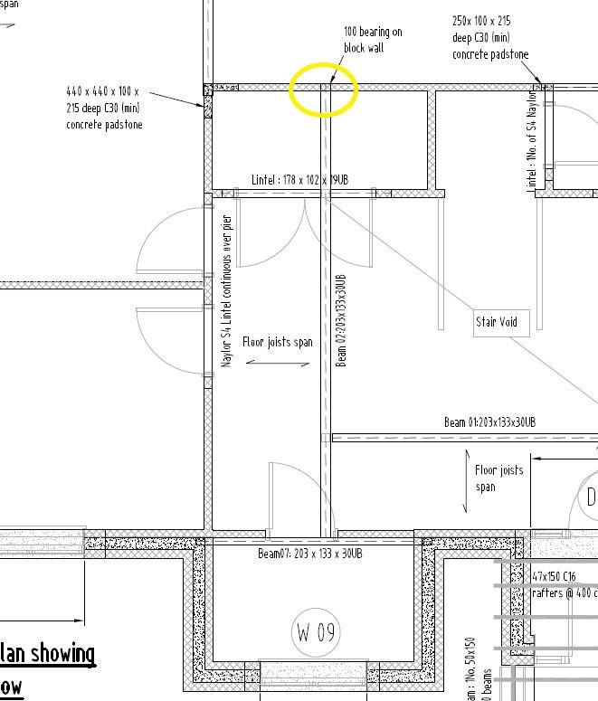

Vijay Posted July 7, 2019 Posted July 7, 2019 Should a padstone always be used under an RSJ in load bearing walls? The S.E I've used (regrettably) keeps overlooking so much that I'm totally fed up with them. It's a pretty long steel (5m odd IIRC) so I'm might surprised he states it sits directly on the block wall
Mr Punter Posted July 7, 2019 Posted July 7, 2019 I would normally expect to use a bit (450mm ish) of concrete lintel under the steel. Cheap and will not crush.
Chablais Posted July 7, 2019 Posted July 7, 2019 The SE we used was adamant, that every steel sat on a padstone, we are using either cut down lintels or casting insitu. Speaking to the blocklayer helping me, he has seen many a cracked block when a padstone has not been used.
MikeSharp01 Posted July 7, 2019 Posted July 7, 2019 1 hour ago, Vijay said: Should a padstone always be used under an RSJ in load bearing walls? Broadly yes in brick / soft block situations you need to spread the loads out. There is some good stuff here: http://nhbccampaigns.co.uk/landingpages/techzone/previous_versions/2011/Part6/section5/appendix.htm
