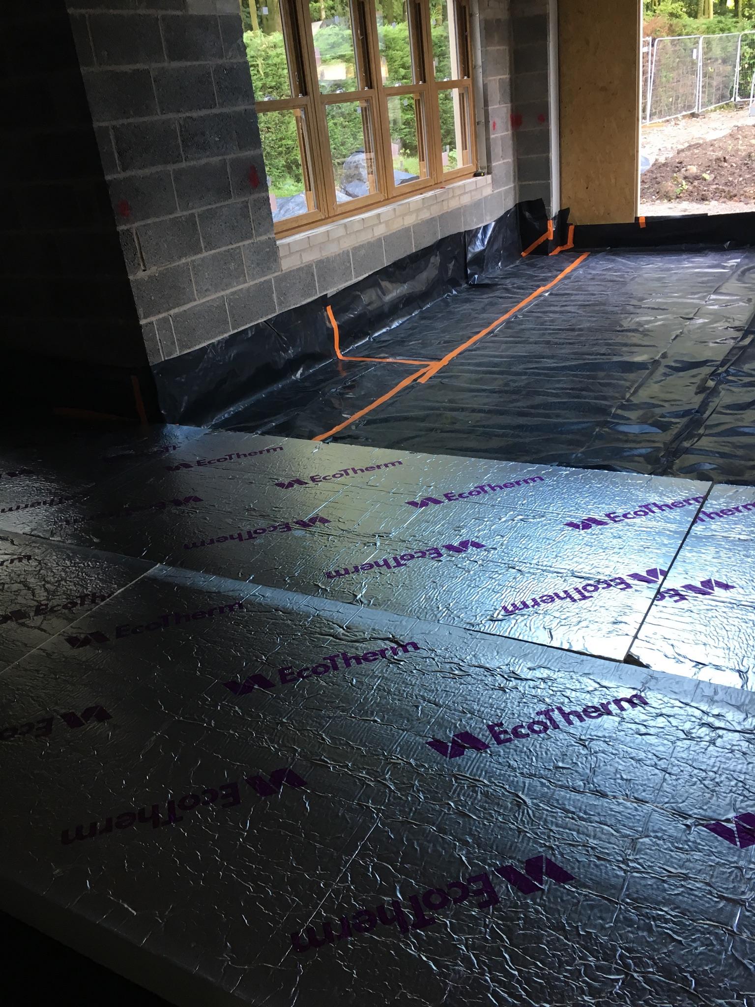

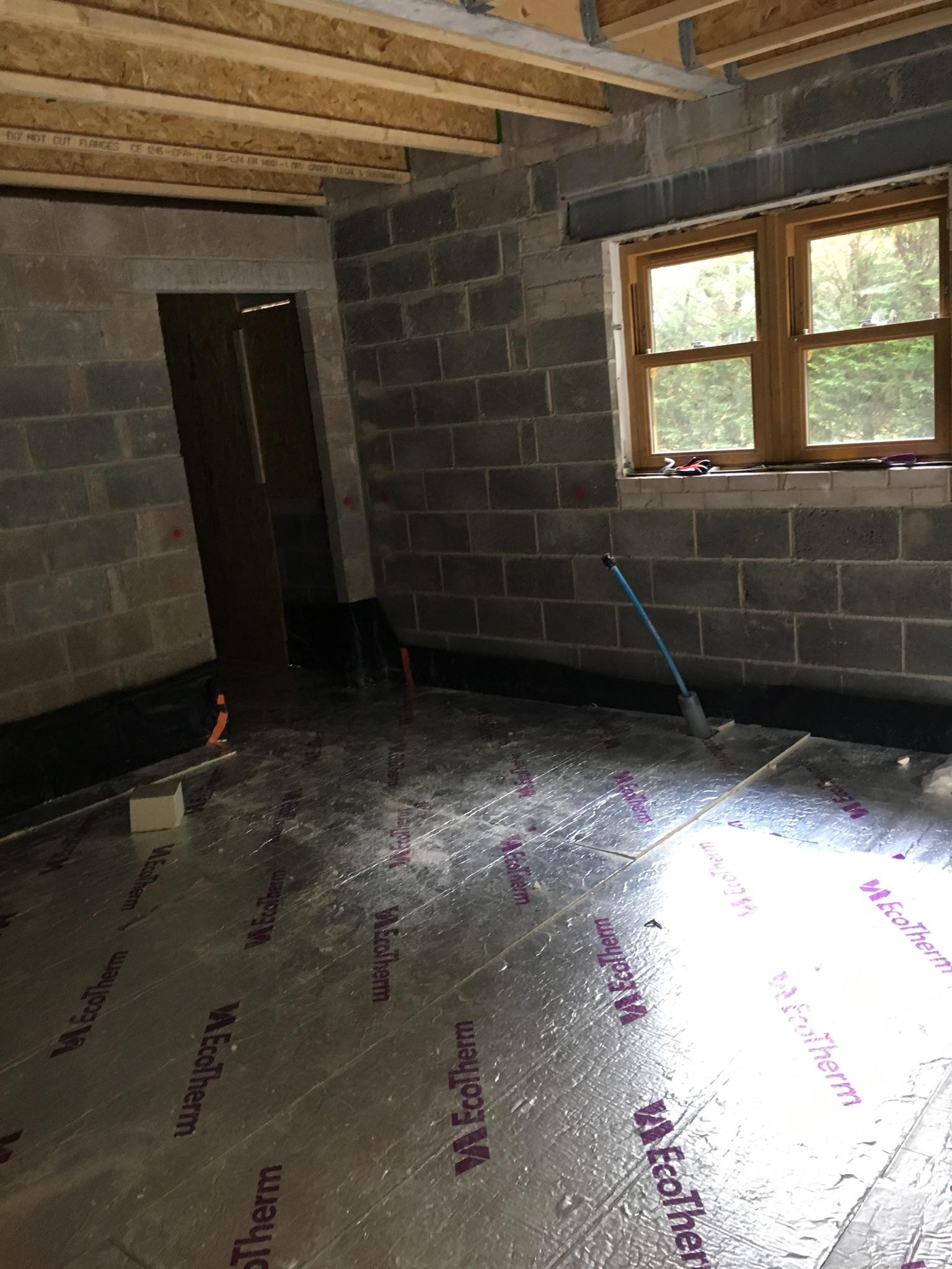

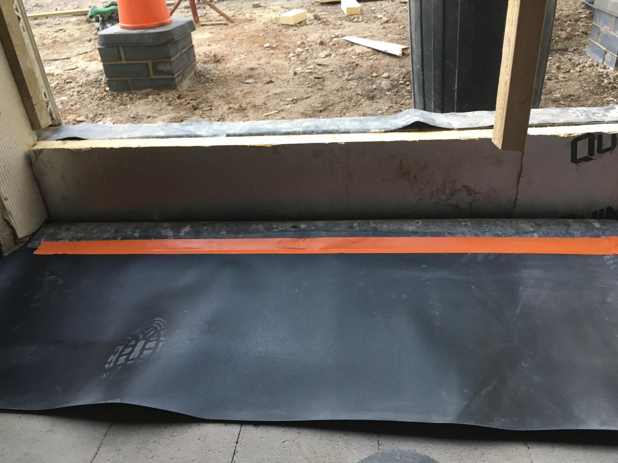

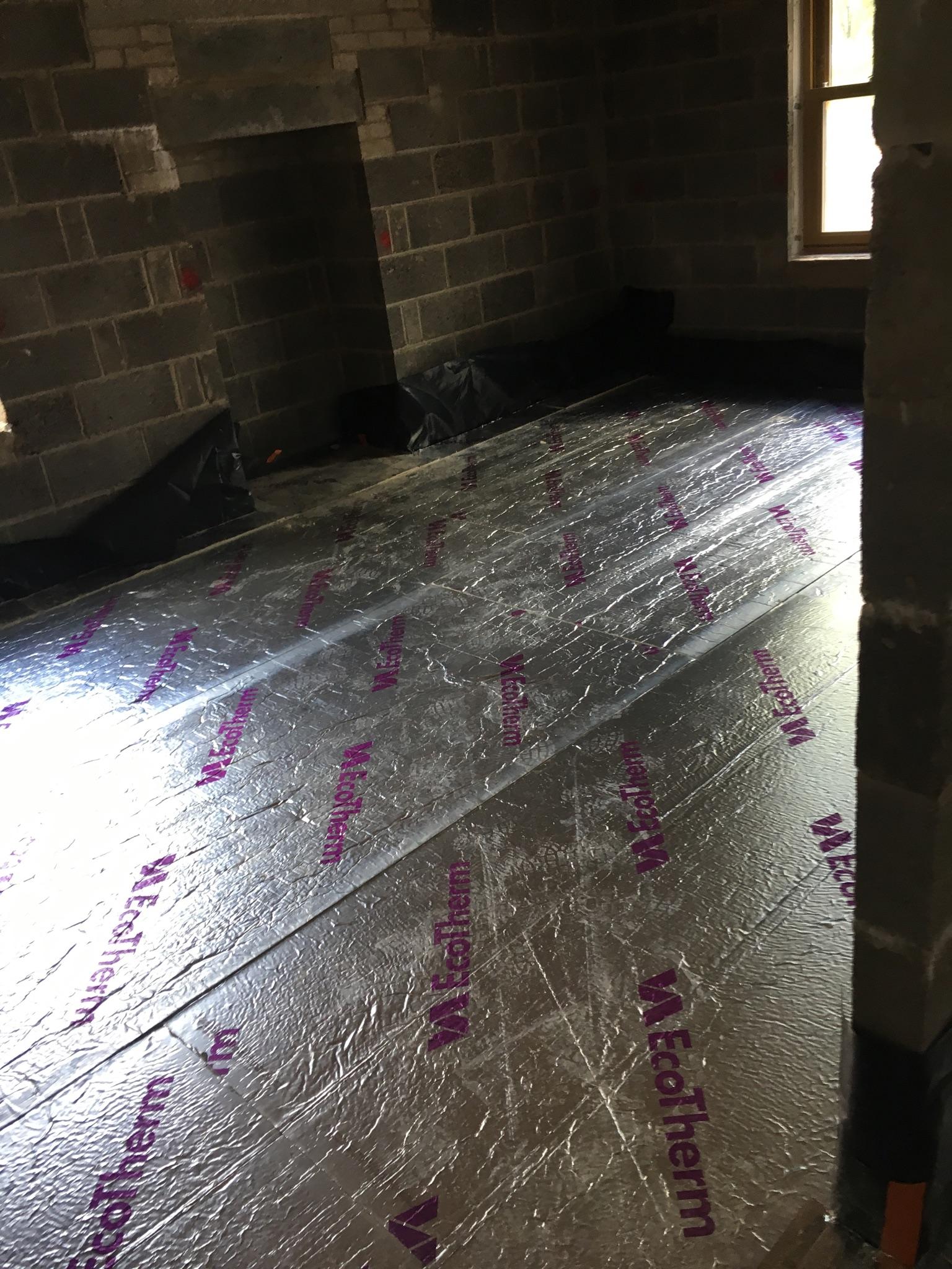

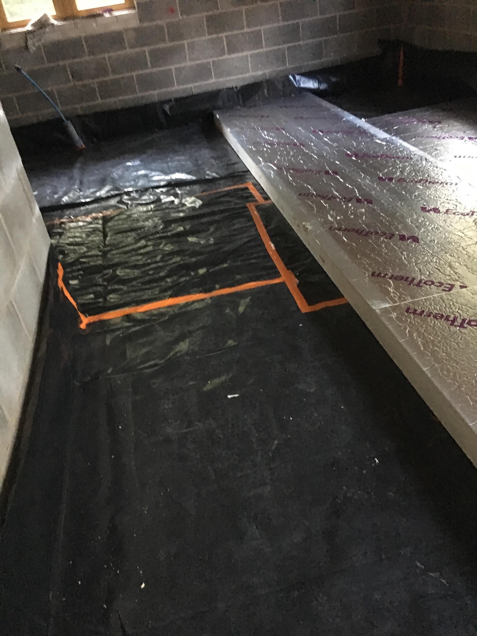

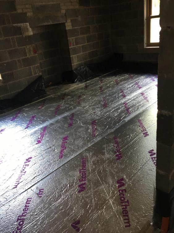

nod Posted July 5, 2019 Share Posted July 5, 2019 These are a few of the pics that I took for BC 1 Link to comment Share on other sites More sharing options...

nod Posted July 5, 2019 Share Posted July 5, 2019 Just a point the tape pictured is one we use for Rendering protection It’s called Jaffa tape Will stick sheeting to bare block and stone No residue At £4 a roll It’s the best I found 1 Link to comment Share on other sites More sharing options...
