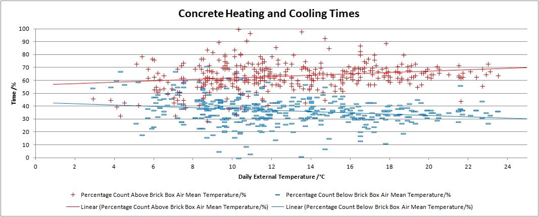

SteamyTea Posted July 6, 2019 Posted July 6, 2019 (edited) Right, got the correct data this time. I think this interseasonal storeage is a statistical problem. There are just not enough times when it is cold to replenish a store sufficiently to be of any use. The below chart is shows the amount of time that a concrete brick is either above external temperature or below it. The trend lines, withing the 1 standard deviation limit, show that as the external temperature gets hotter, there are more times that the block is hotter still. The reverse is true for the cooling side of the equation. There are the odd outliers that pop into the 'the other side', but these are probably rare weather events i.e. snow (had some twice), rain (it can cool things quickly), extra sunny days (had a few last year), very windy days (again, there has been a few, not many this last 12 months). Edited July 6, 2019 by SteamyTea
