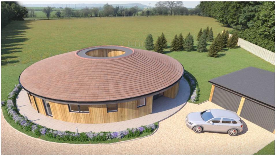

In terms of fixing the cladding is even more interesting as it is a round house :)
I haven't decided yet but I am considering couple different options.
One of them is to lay some battens on top of the insulation let's say 25 -38mm thick
This will make the wall unnecessarily thicker but then having a bit of air gap between cladding and insulation maybe would be a good think....
I've attached architect vision image below.
Posted
I think tiling the roof will be more of a challenge!
If you are doing vertical cladding as shown you will need vertical battens fixed to the timber frame, then horizontal battens fixed to the vertical.  I did some 25mm x 50mm horizontal battens on a radius of 3800mm. I soaked the battens and pre-bent them.  They were for render board finish.
Thank you for sharing.
I have 10m radius so should be able to bend the battens.
Tiling roof will be interesting :)
