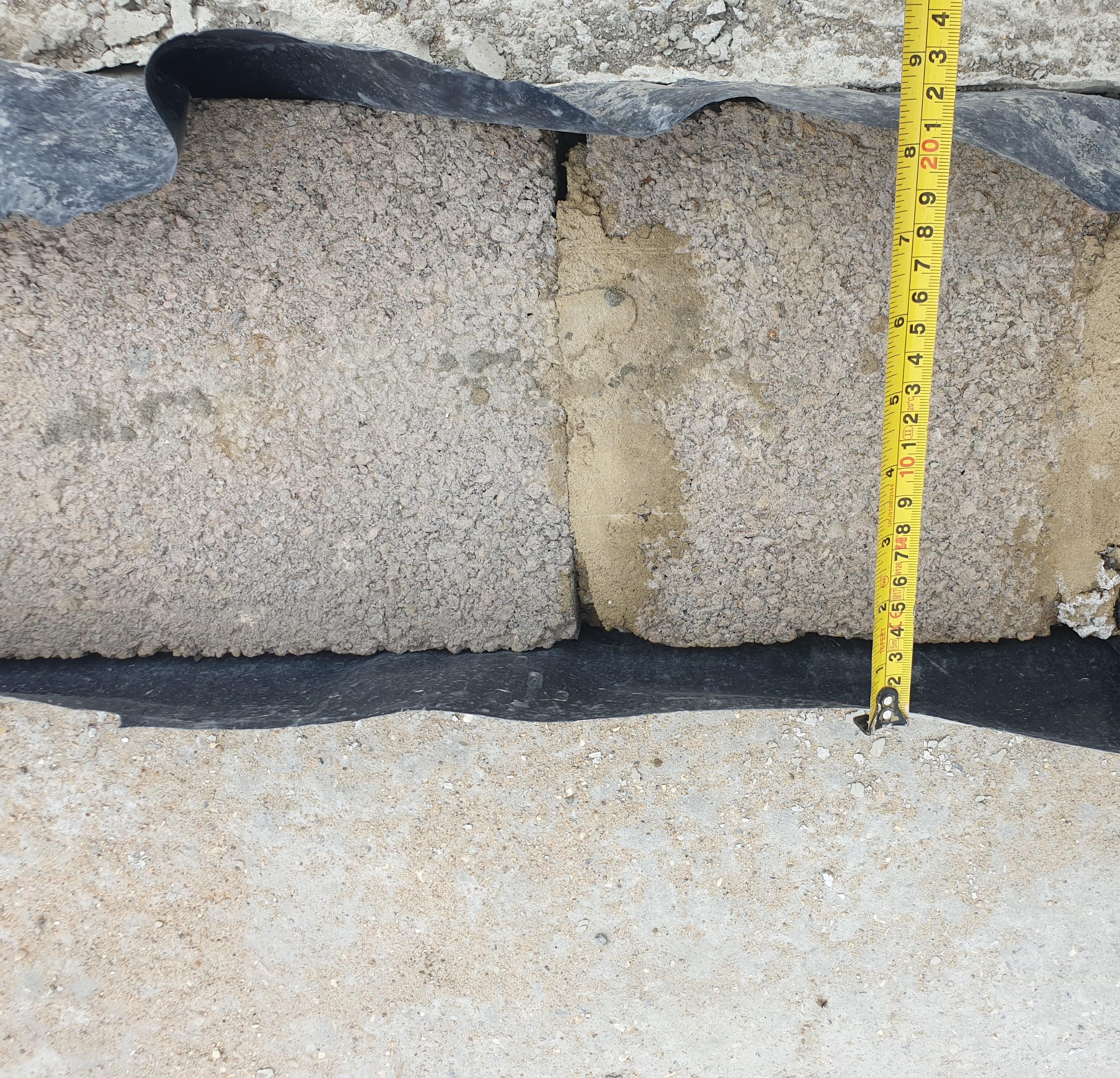

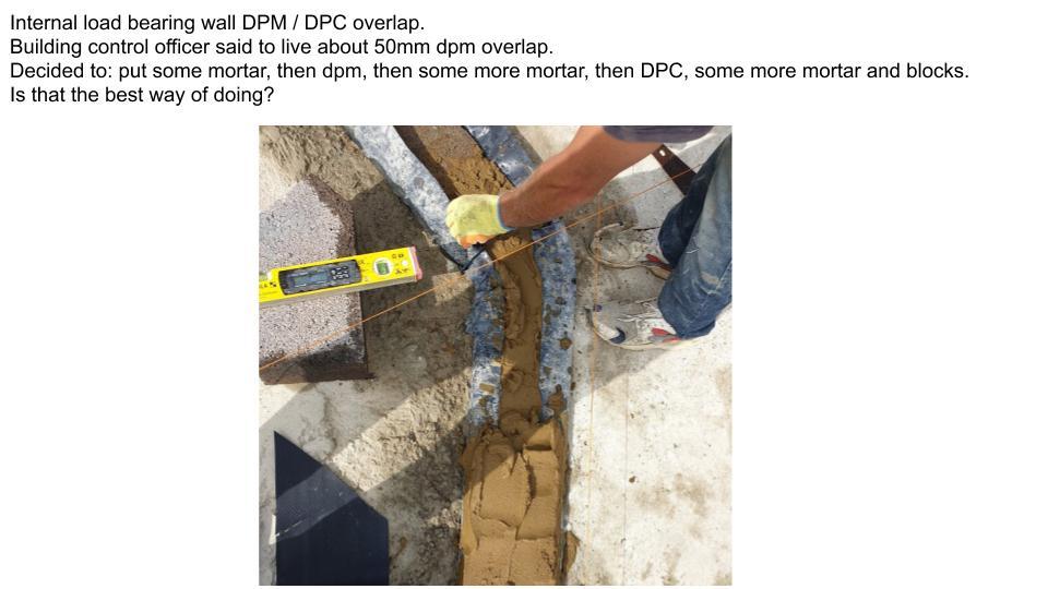

romario Posted June 24, 2019 Posted June 24, 2019 I am starting first layer of blocks above DPC and I wanted to ask other people for opinion about DPM / DPC overlap best practise. I've seen many diagrams showing the overlap but I haven't seen one peace of information of the actual best way of doing. It is an internal 215mm load bearing wall. Building control officer said to live about 50mm dpm overlap during oversite inspection. I decided to: Put some mortar on the blocks Then bend on it 50mm dpm, Then some more mortar, Then DPC, some more mortar and blocks. Is that the best way of doing? Please see attached photo? Am I being to cautious? Thank you in advance.
Declan52 Posted June 24, 2019 Posted June 24, 2019 When you say an internal wall do you mean the internal wall of the cavity or an actual wall inside the building.
romario Posted June 24, 2019 Author Posted June 24, 2019 1 minute ago, Declan52 said: When you say an internal wall do you mean the internal wall of the cavity or an actual wall inside the building. Hi Declan, I mean actual internal wall inside the building but it is load bearing on top of the footings.
Declan52 Posted June 24, 2019 Posted June 24, 2019 I would leave at least a 100mm of an overlap on each side. Easy to trim it back much harder to add more.

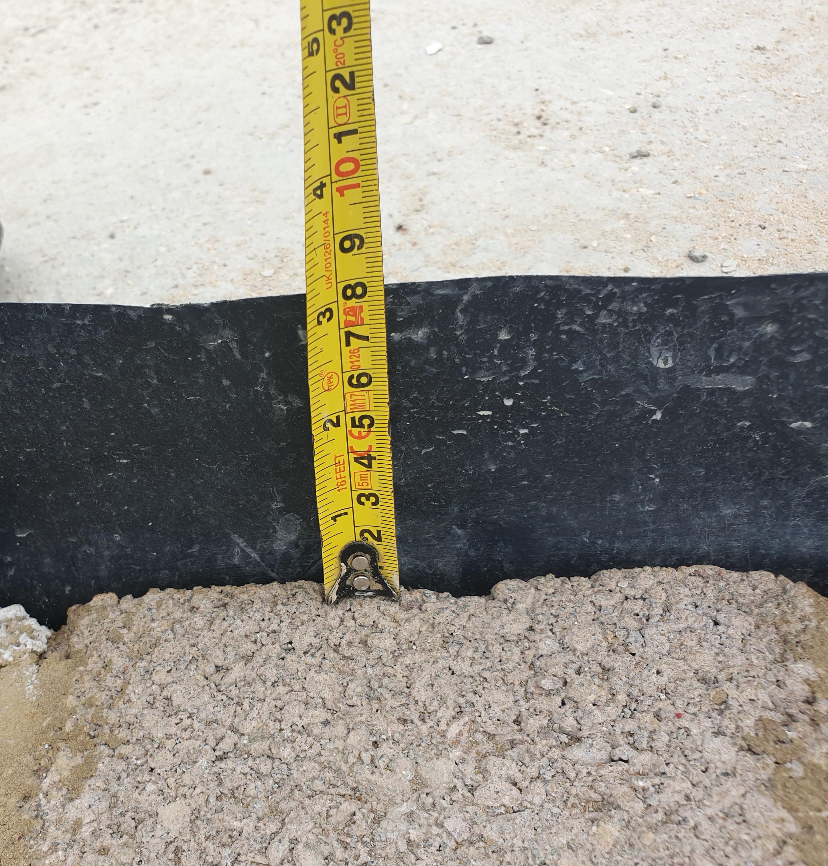

romario Posted June 24, 2019 Author Posted June 24, 2019 3 minutes ago, Declan52 said: I would leave at least a 100mm of an overlap on each side. Easy to trim it back much harder to add more. Thanks Daclan for your reply. I agree with you but I may have also confused you. I have left more of DPM but now I am at the stage of actually laying the blocks above and I need to trim the DPM. I am kind of trying to find the best practise in terms of how much overlap to leave when you put the mortar and also should you put the mortar between DPM and DPC. I am probably to cautious but at the same time don't want to make silly mistake.... Thank you.

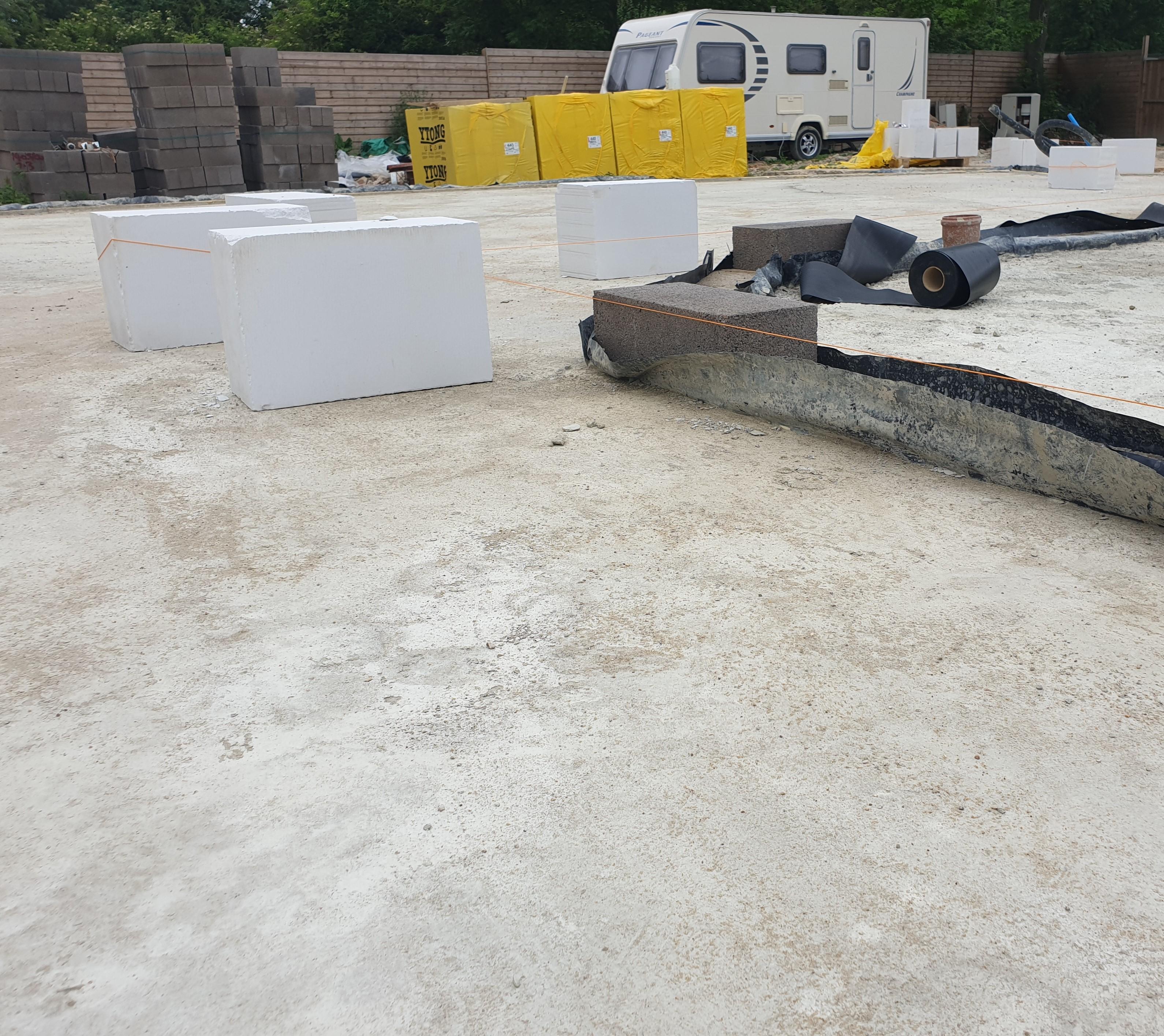

romario Posted June 24, 2019 Author Posted June 24, 2019 11 minutes ago, Declan52 said: Can you take a pic of how it sits at the moment. Yes, please see attached photos
epsilonGreedy Posted June 24, 2019 Posted June 24, 2019 (edited) 15 minutes ago, Declan52 said: Can you take a pic of how it sits at the moment. Yes @romarioa diagram or picture would help. I am about to do the same on my build yet I am struggling to picture what you intend to do. For a conventional brick/block cavity wall construction a 200mm or more excess flap of dpc will be left on the inside wall to be tucked in with the dpm when the floor screed is added once the roof is on. Edited June 24, 2019 by epsilonGreedy
romario Posted June 24, 2019 Author Posted June 24, 2019 6 minutes ago, epsilonGreedy said: Yes @romarioa diagram or picture would help. I am about to do the same on my build yet I am struggling to picture what you intend to do. For a conventional brick/block cavity wall construction a 200mm or more excess flap of dpc will be left on the inside wall to be tucked in with the dpm when the floor screed is added once the roof is on. Please see one more photo showing where I am at the moment. The DPM, insulation and cocnrete slab has been layed down. This is a 215mm solid internal wall. It is kind of free standing internal square that's why structural engineer required 215mm thickness.

PeterW Posted June 24, 2019 Posted June 24, 2019 @romario fold over both sides, stick a 215mm DPC on top then lay your mortar and blocks. You don’t need mortar under a DPM or DPC. If its difficult to get it to stay, use some lengths of duct tape to join both sides together and then get the DPC on top. 1

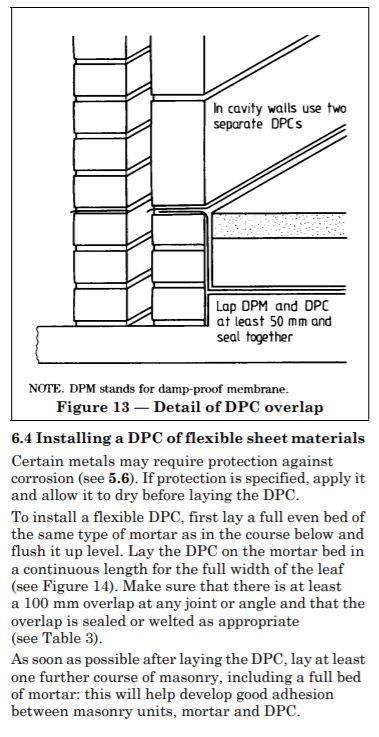

Ian Posted June 24, 2019 Posted June 24, 2019 (edited) 13 minutes ago, epsilonGreedy said: Really pleased to read this confirmation, any idea what motivates the notion of mortar below dpc and/or dpm? Is it a concern the brick below might puncture the dpc? its to avoid creating a slip plane in a masonry wall. Edit: Extract from BS 8215 Edited June 24, 2019 by Ian 1
epsilonGreedy Posted June 24, 2019 Posted June 24, 2019 20 minutes ago, Ian said: its to avoid creating a slip plane in a masonry wall. Right I now get the motivation, far more value in your single post than the other ding/dong thread between practicing brickies. I guess material scientists have tested the relative friction between a dry brick/dpc joint plane and a brick/mortar/dpc joint plane.
