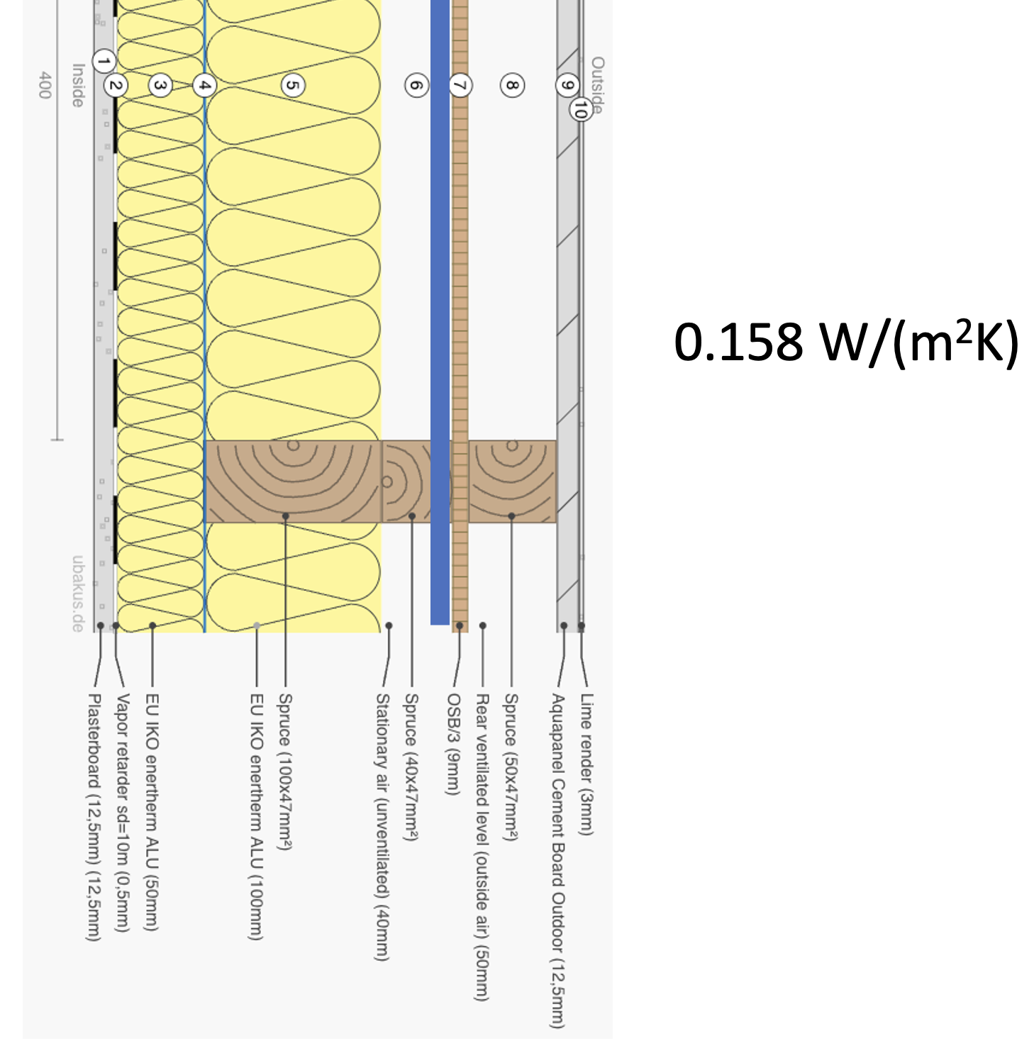

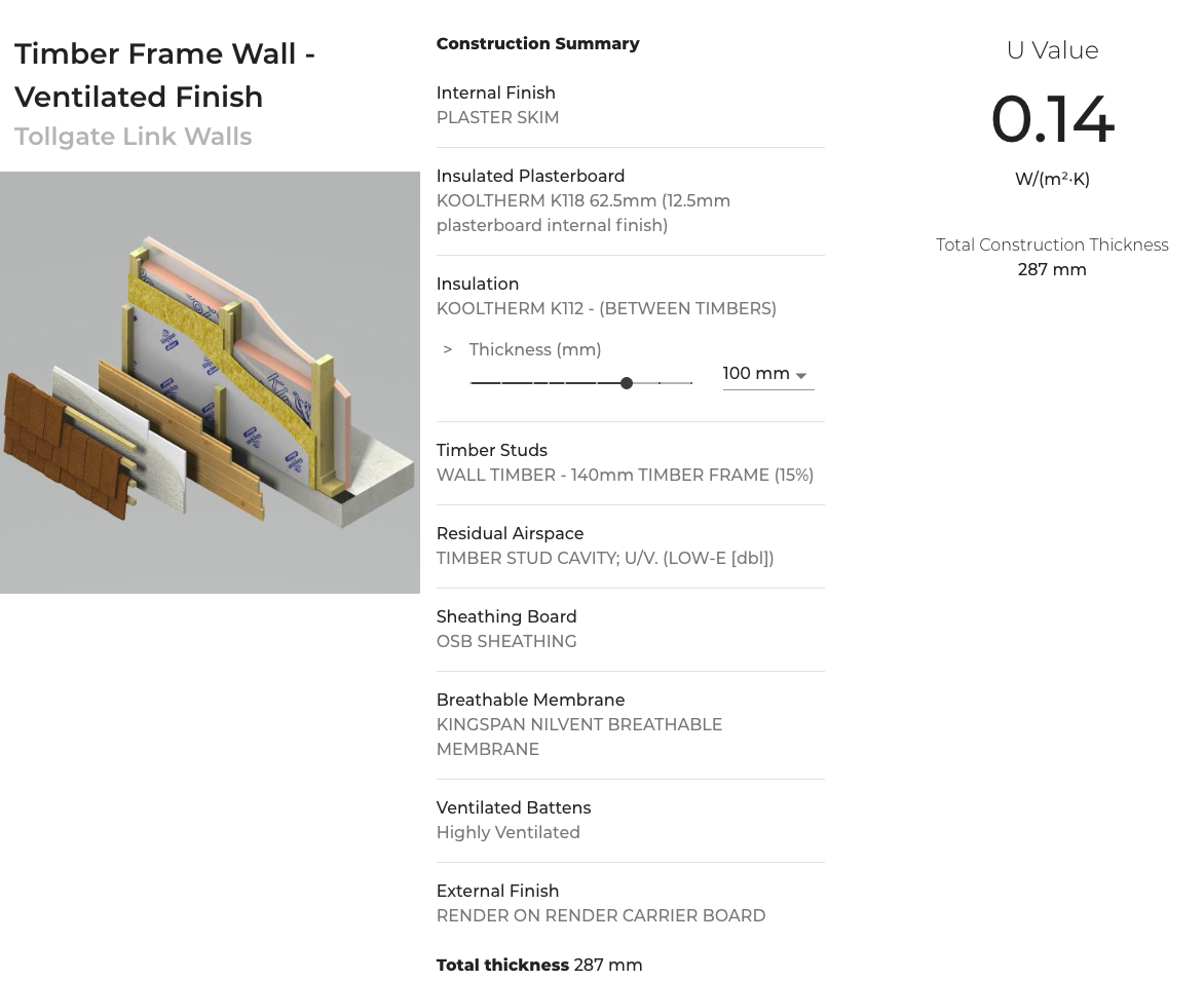

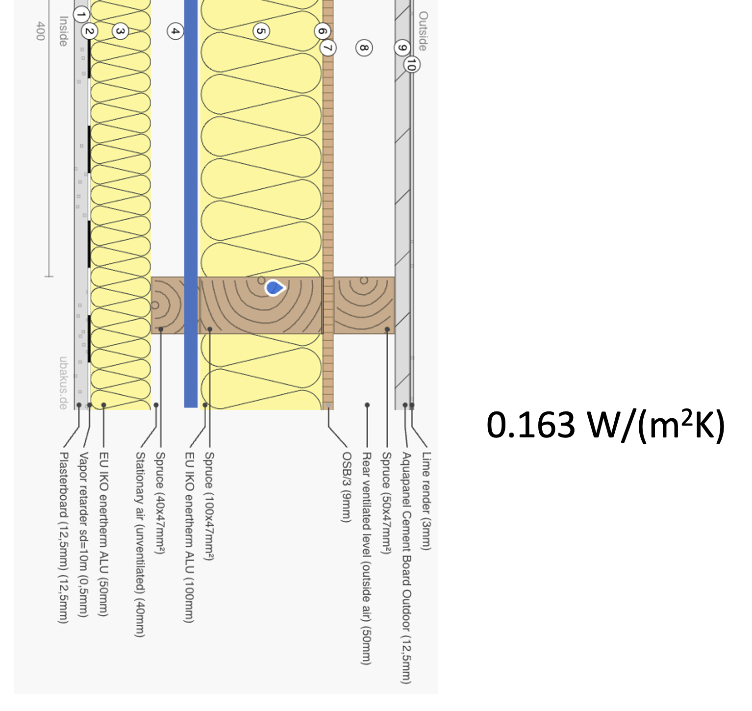

I'm building a small timber frame extension and planning the insulation and cable position currently. The studs are 140mm x 47mm C24 timber. First question is am I ok to notch cables (4mm T+E and 1.5mm 3 core and earth) into the studs which form the outer walls of the extention? I can see loads of info on notching joists but very little on studs. I have two options in terms of placement of the insulation (100mm PIR + 62.5mm Insulated plasterboard) which have an effect on the u-values according to the wonderful Ubakus. 1. Service void below the level of the insulated plasterboard (blue line is position of the cable notched into the studwork, inside to left) giving a u-value of 0.163 2. Service void behind both sheets of insulation (blue line is position of the cable notched into the studwork, inside to left) giving a u-value of 0.158 Which is better or does it not really matter and I go for best u-value?
