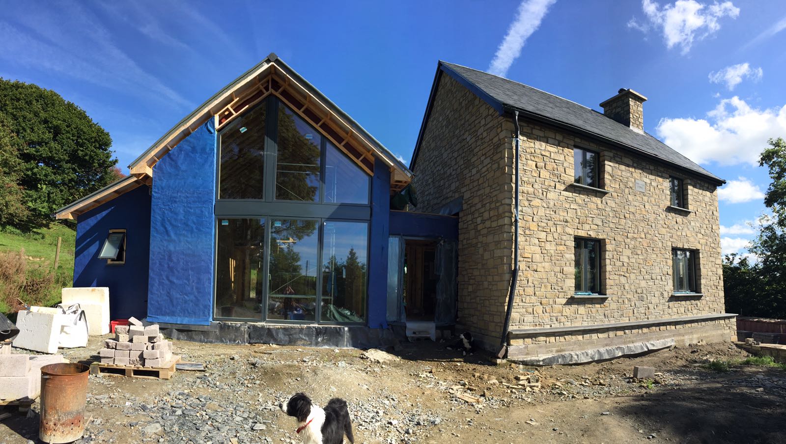

Windows from Velfac, Blue now turning a lighter shade of Siberian Larch (old photo)
