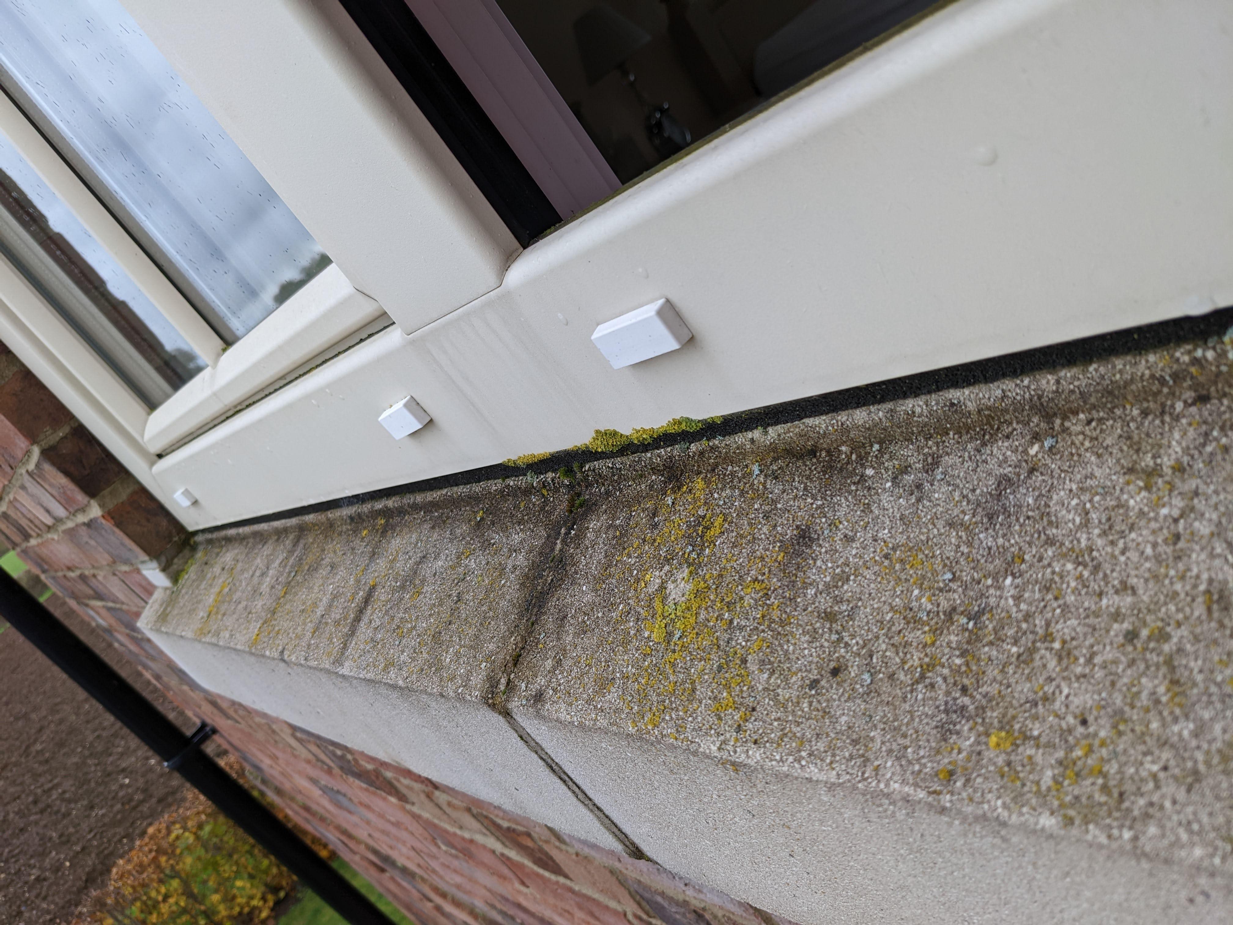

Beware this is very tedious Each window has 9 or more lubrication points, some hard to get too to be done every 6 months the manual says. I love the look of our internorm windows and the triple glazing is amazing for thermal and noise insulation but the whole point of the alu-glad solution was for low maintenance, so it is mega annoying the additional maintenance need to lubricate them so often and in so many places. Surely there is a better solution?

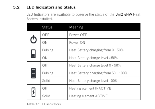

Ha ha. Well how many people do you know that have a temp sensor in their airing cupboard that they check on to see if the immersion tank is full of heat? I know one. Me! So yes I find the new Sunamp LEDs very useful/interesting. Whether my holiday cottage guests will be quite as interested as I am is another matter?!!

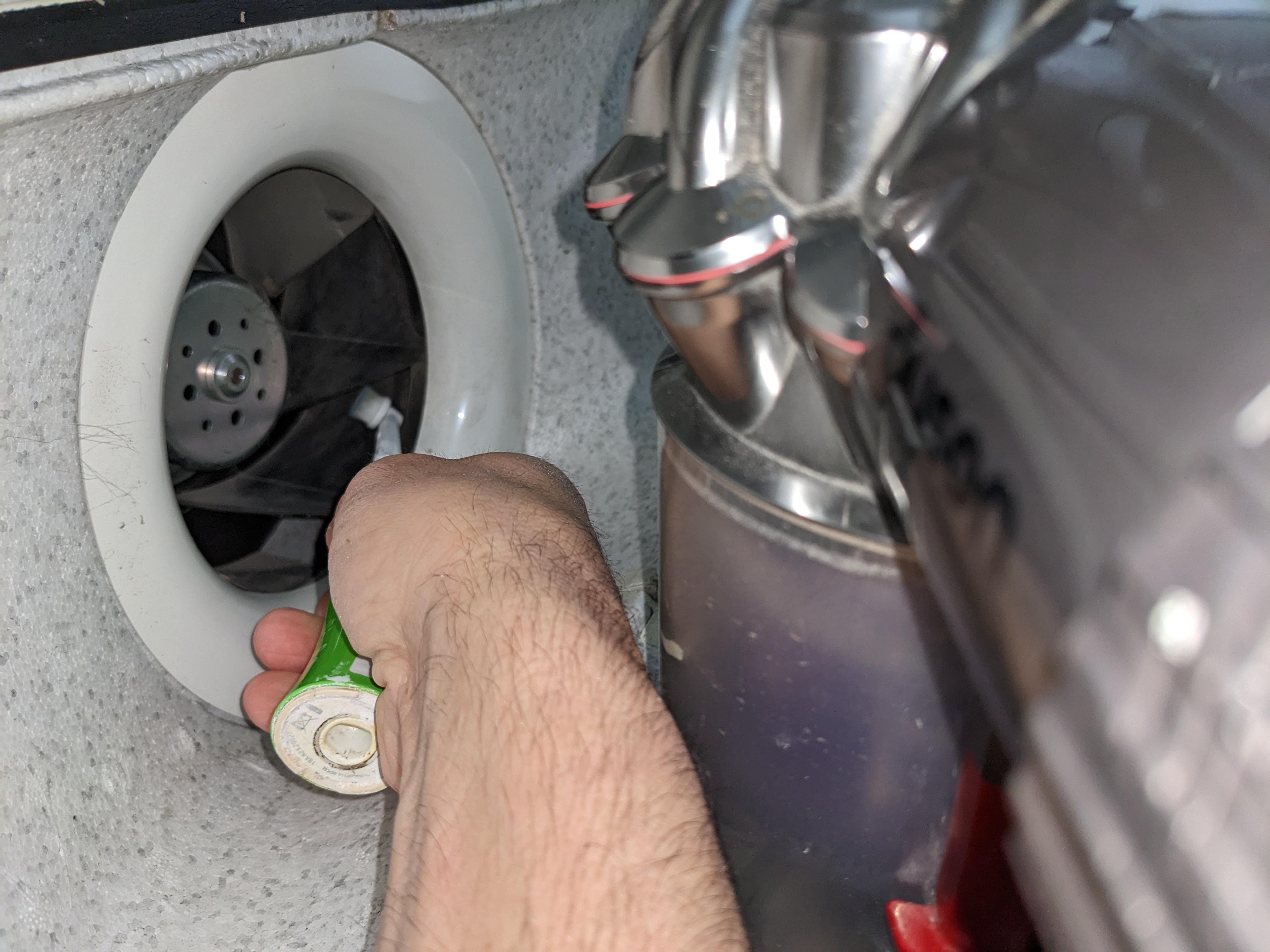

Just wondering since I last asked ( ) if anyone has found a neat way to clean the MVHR fan blades. Mine get a thin film of dust on them, which the manual says should be removed and I hope it will quieten it a little too. Paintbrush/toothbrush and hoover is my current method. Someone in the forum suggested a can of compressed air - anyone doing that/does it work? Many thanks Paul

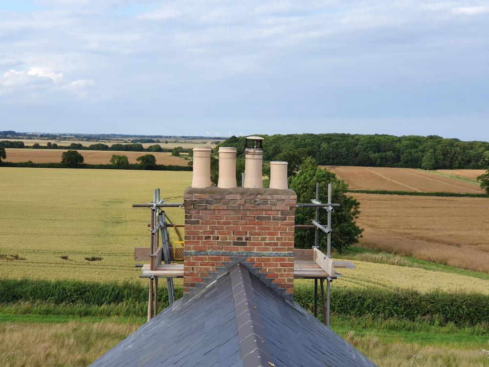

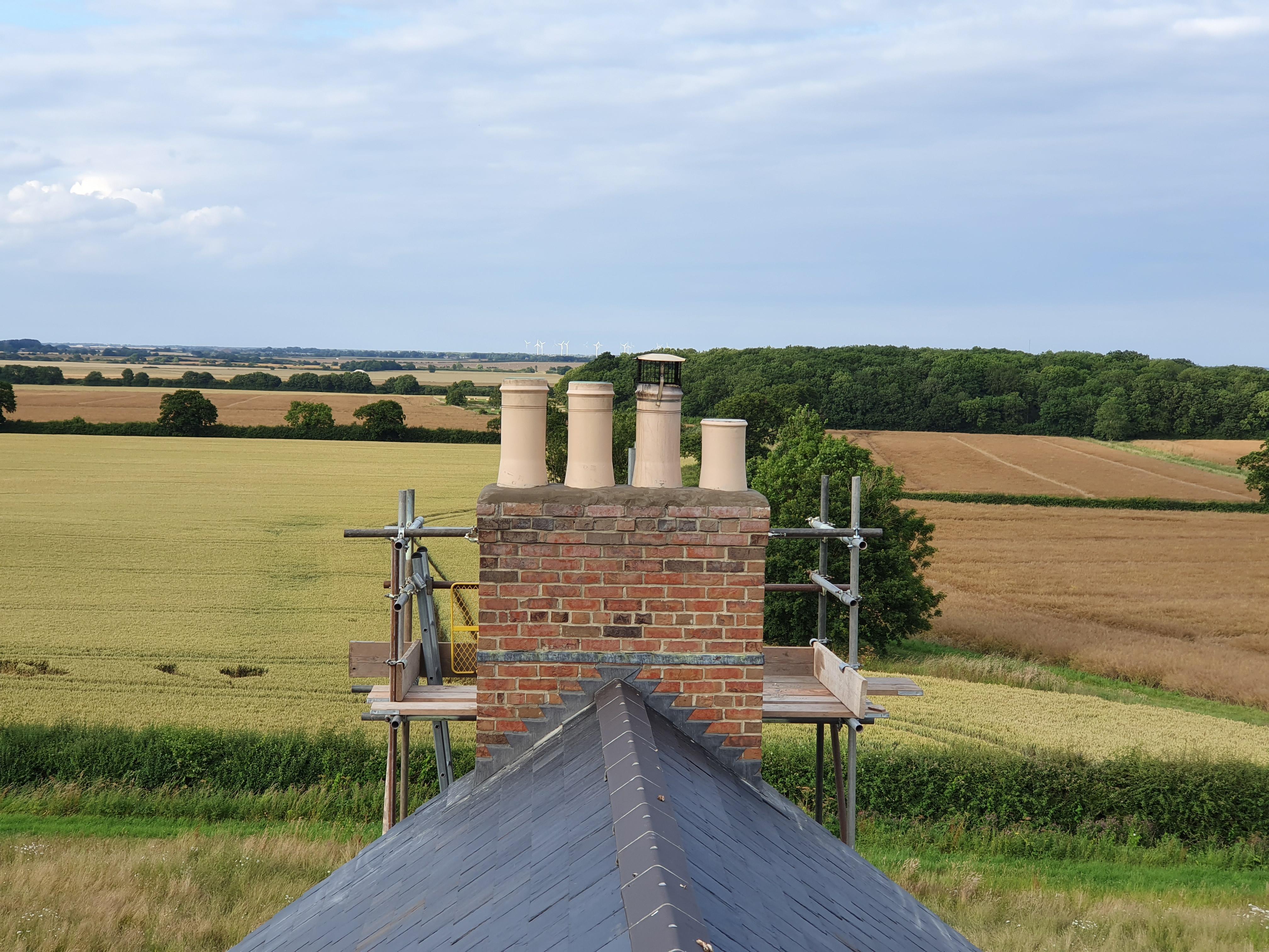

Brickwork damp patch after prolonged heavy rain
readiescards replied to readiescards's topic in General Construction Issues
Thanks @mjsx it is still ongoing and indeed is the source of waking up in the night 'thinking WTF did I use that builder'? We have had the chimneys rebuilt by another builder after lots of investigations and expensive reports, this seems to have made the situation better - with only minimal drips in the recent November storms. (It certainly has improved the log burner having removed the damp vermiculite). -

Further to: Both my stacks (above the lead apron) seem to gather considerable moisture (a separate thread). This moisture then exits via the above lead apron weep-holes and drains onto the bricks below the lead. The weep-holes are only on the gable ends (none on the roof side of the stacks). Question is it normal practice to have weep-holes on the gable ends rather than the roof side? I ask, as I'm wondering if the weep-holes had drained on to the roof, then the considerable moisture would be hit the non-porous tiles and be quickly removed via the guttering etc. Instead it appears to me that the moisture is feeding the bricks below the lead apron. Thanks Paul
Further to my builder is now this damp on condensation due to my late decision to insulate the attic. Can anyone recommend a condensation consultant/firm who via studying photos, drawings etc can advice if there is a chance condensation is the cause please? Happy to pay for a detailed report. Thanks
3 litres since in 12 hours since 7am ?
