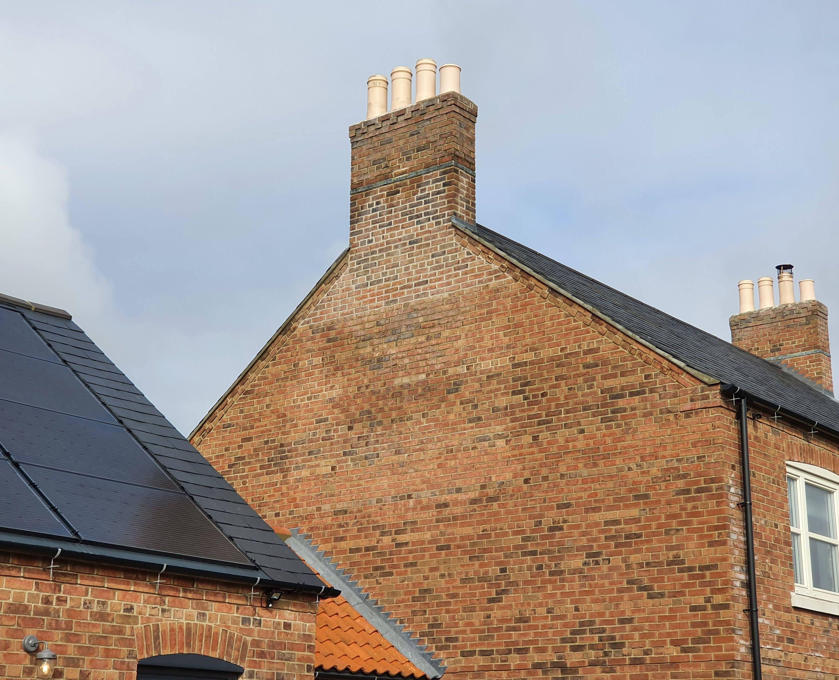

  2. Well after rebuilding both stacks, with new lime mortar and applying a water sealant in early 2020 - it now looks mighty ugly (on both stacks) and I still have concerns of internal damp - hoping to get an expert out and will see how it fairs this winter

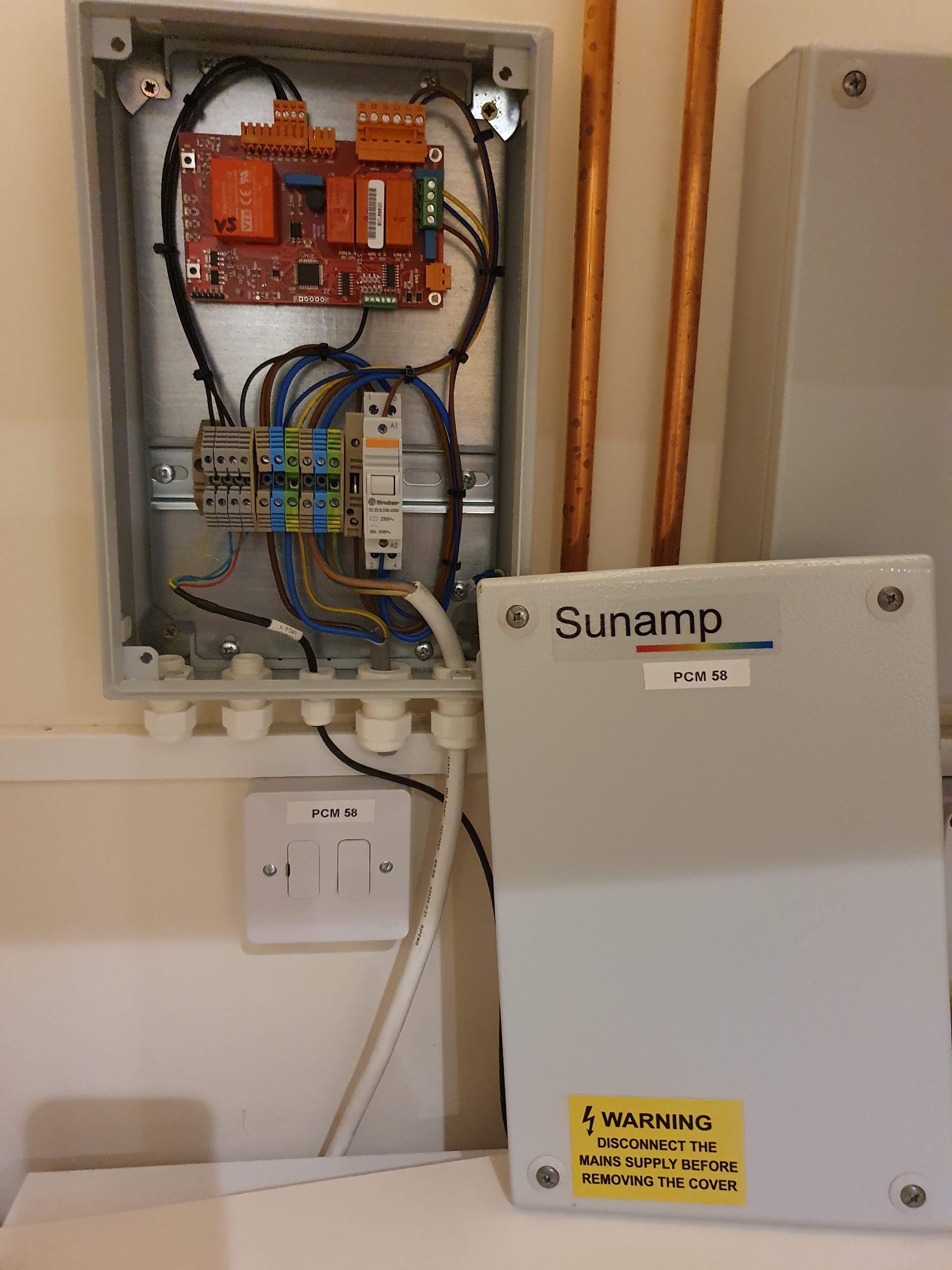

  5. Cheers if I have to get an electrician to disturb this box again I'll pass on the comments - for sure cable markers or even a scribble on the inside of the box lid would have been very handy recently!

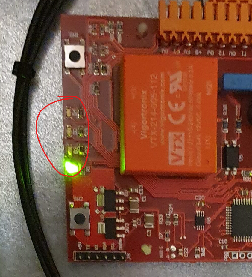

  6. Like the PCM58 I have the PCM34 has a series of 4 led lights on the left of the control board, located between two buttons. What do these lights mean when on/off Thanks Paul Read Rigsby Wold Holiday Cottages

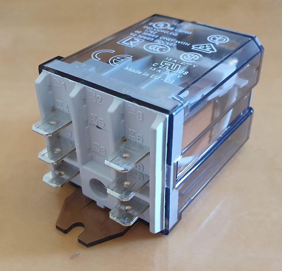

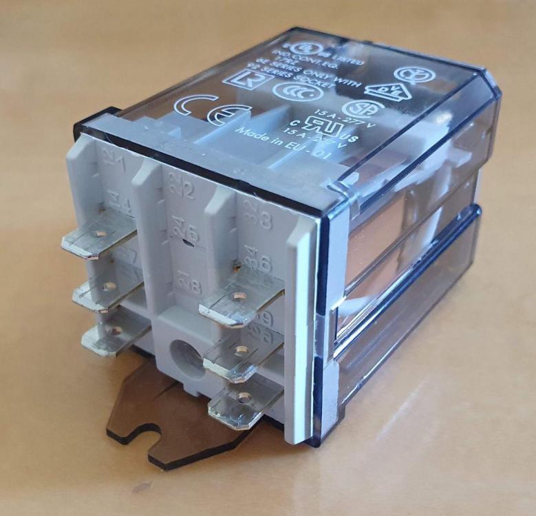

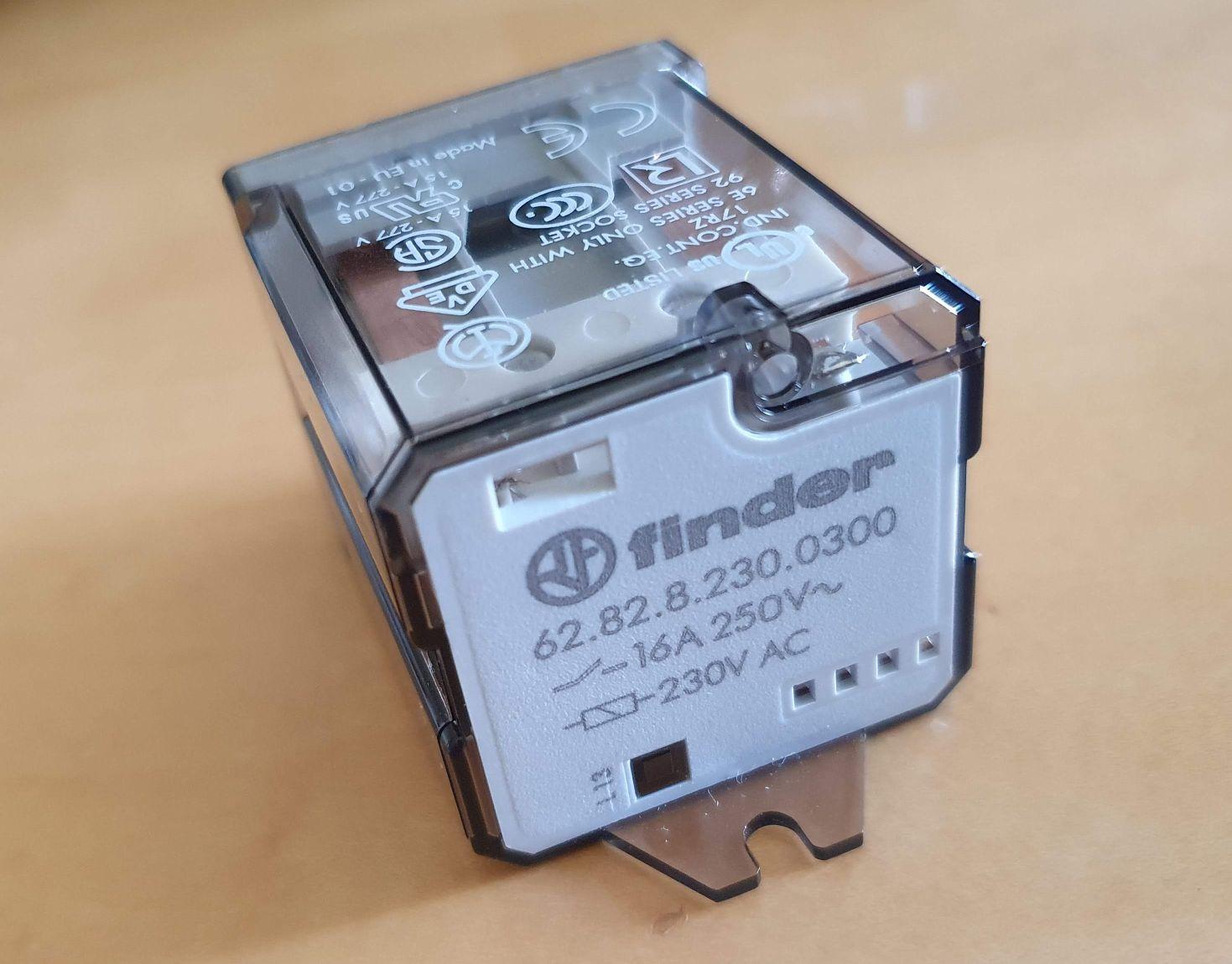

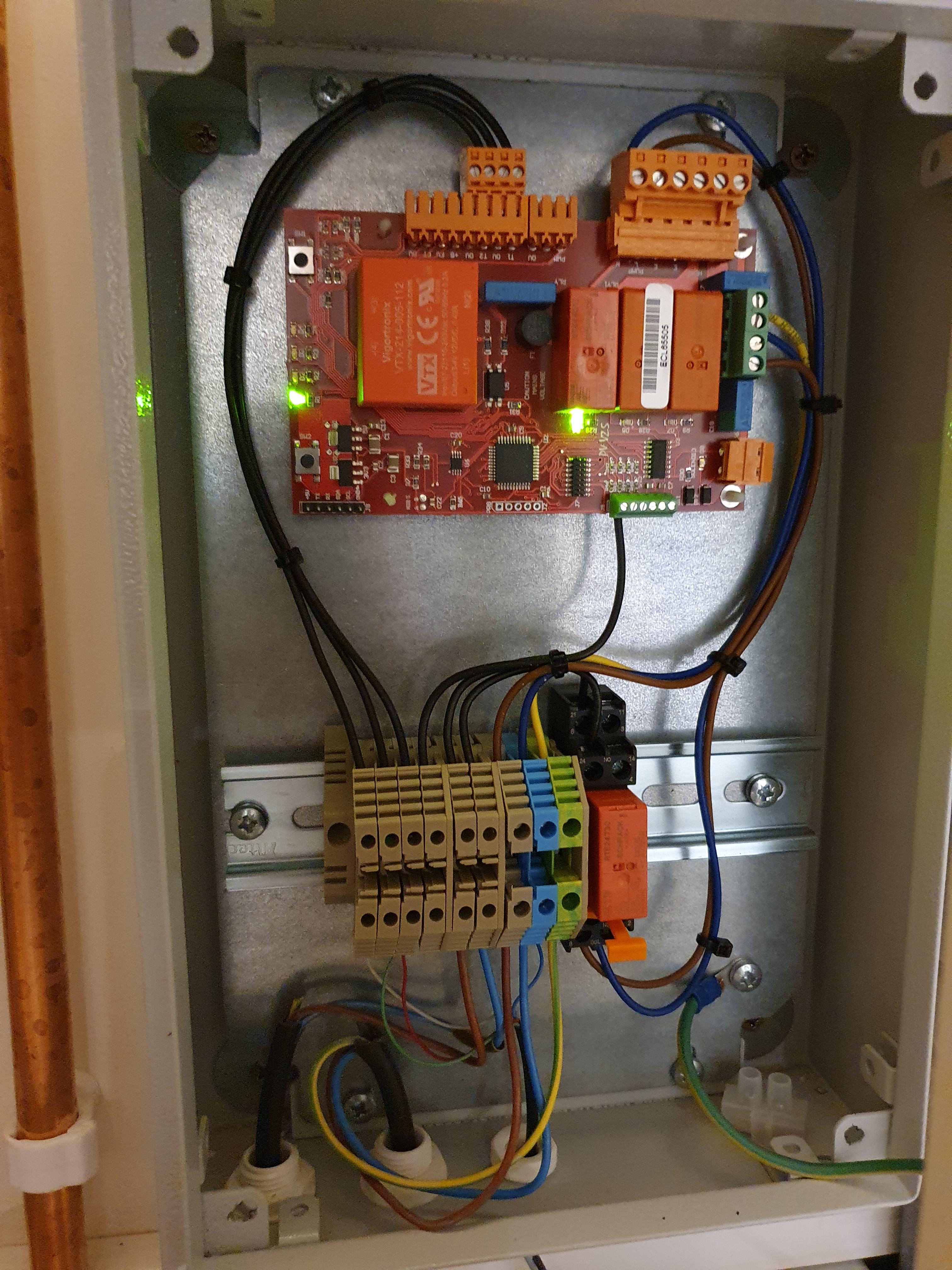

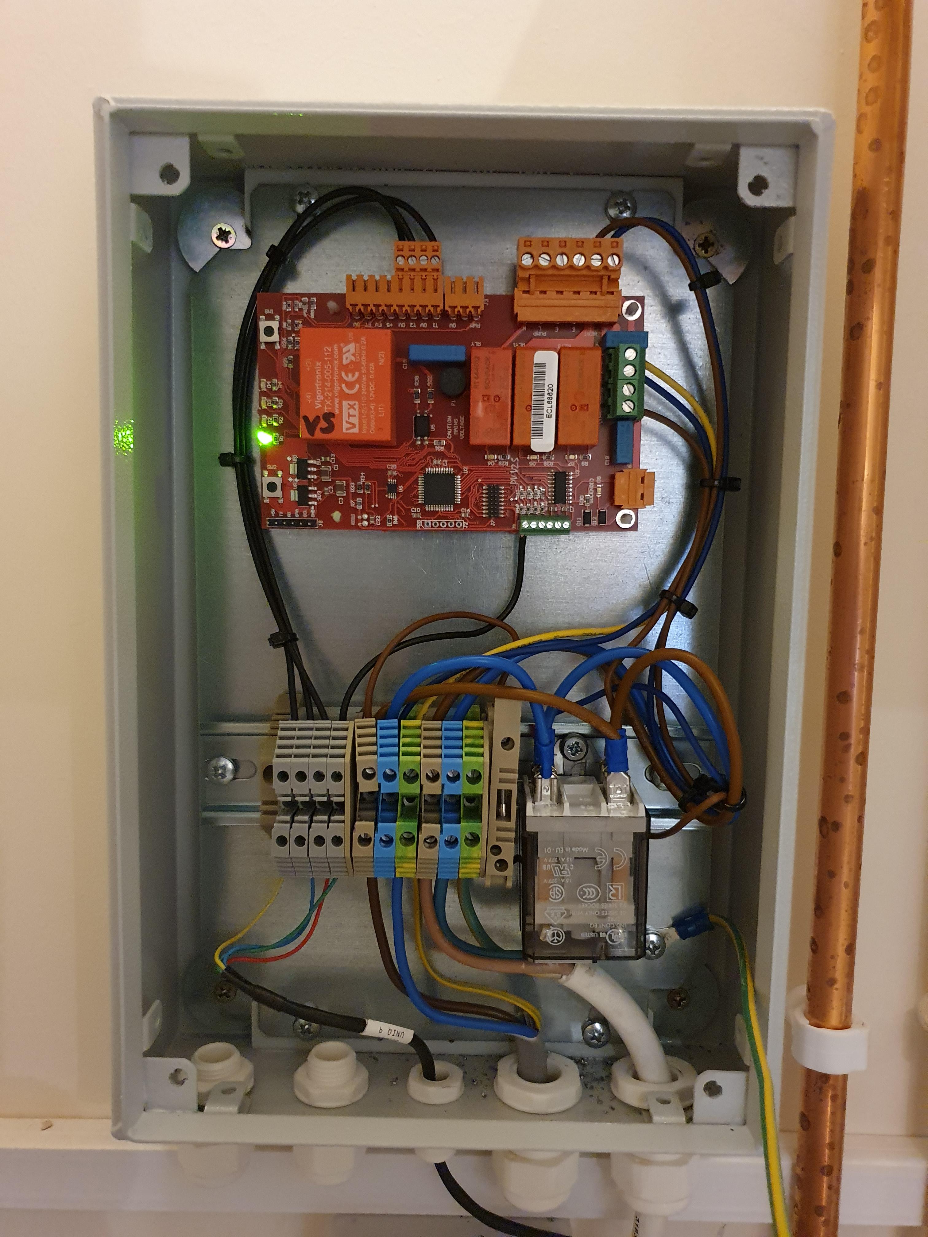

  7. Upgraded relay installed, seems to be working fine.
  8. Thanks @Andrew Bissell - Sunamp much appreciated. Not sure I count the invoice date as the start of the warranty period but however I appreciated the upgrade part being sent - which my electrician has just swapped the unit over too. My primary concern is not having my future customers experiencing a loss of hot water (and potentially leaving a negative review) in two or three years time I'm assuming the upgrade relay resolves that.
  9. With spade connectors, Sunamp warn me this one also has visible sparks from the internal contactors
  10. Upgraded relay received from Sunamp, now need to get electrician back out to install it.
  11. Correct, having spoke to Sunamp they say that is normal!
  12. Sunamp say they are going to send me a new relay, they say they considered the Finder relay fine and therefore no need to contact existing customers! I'll be sent the latest spec - though it was unclear what that is going to be. @Jeremy Harris Have you a picture of your replacement relay please ?

  14. Got a call from our holiday cottage - guests no hot water. Thanks to @Nickfromwales support was quickly able to identify control main relay failure exactly as @Jeremy Harris I believe - with the neutral line remaining open. Horrified to see it spark through the relay body and very annoyed no proactive input from Sunamp telling me to replace the relay so now got an expensive electrician call out for a short term replacement relay to get hot water flowing again - argh!

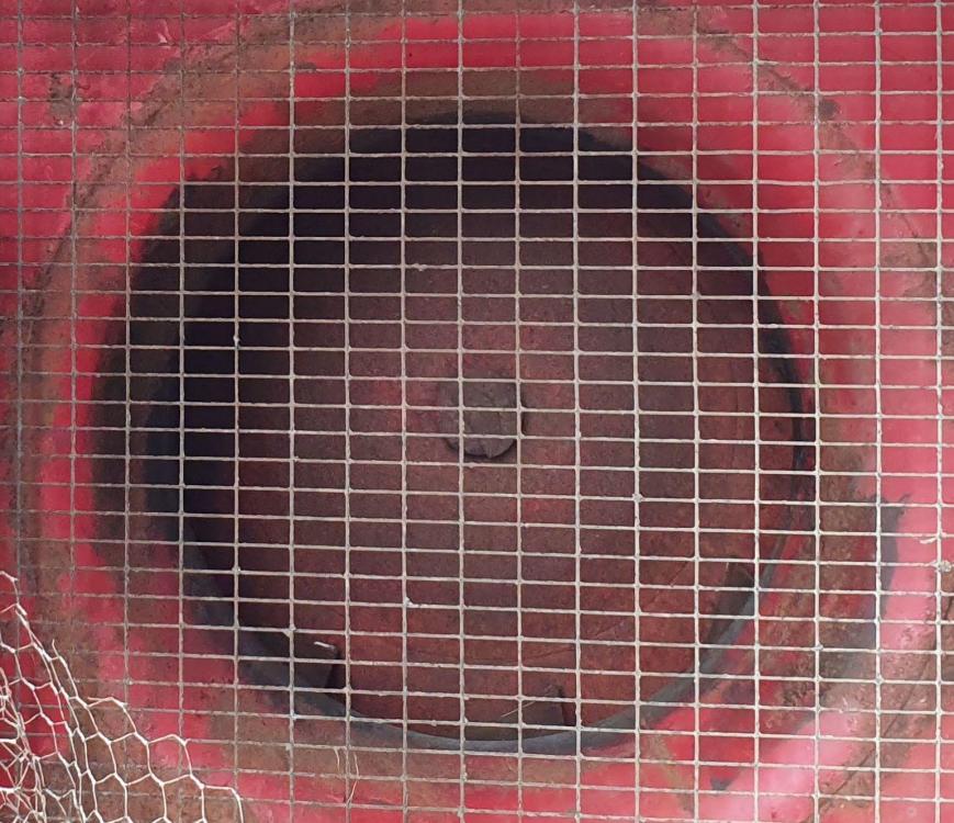

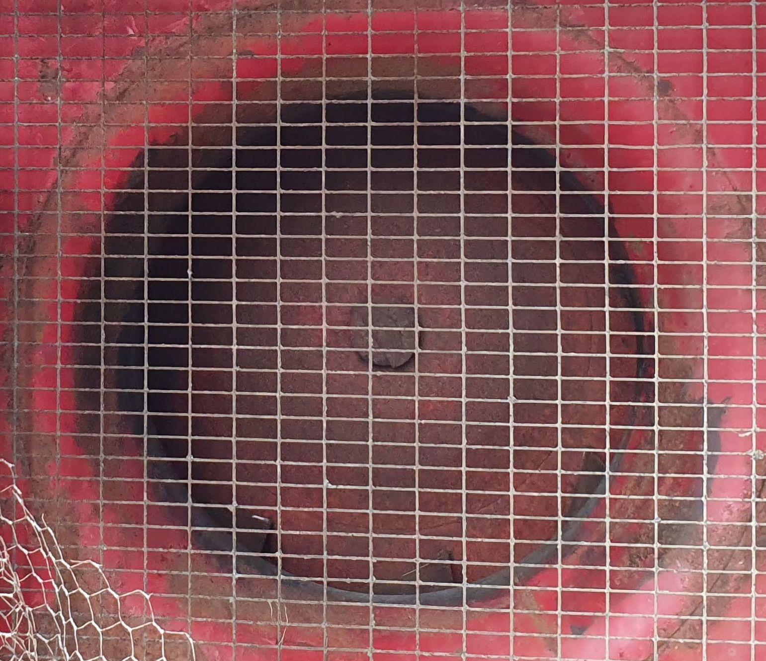

  17. Moving it would not resolve the issue - just giving a different property a noise issue. Sound fencing certainly seems the most viable option the only trouble is that it needs to easily removal and replaced as they is very little space between the fan entrance and the barn door entrance and we need all that for grain loading.
  18. Budget is £1000 so not intending to replace unit (at this stage)
  19. It is difficult to block out the dates as when the harvest comes in can vary +/- a couple of weeks and if the wheat is wet or hot then we need to run the fan when ever the weather lets us so can easily be a few months of on and off use. Yes it is a 37kW fan. Bearings seem ok when I did a quick test the other week. I'll give the blades a good clean and see if that improves it.
  20. You can download the amr file here: http://rigsbywoldholidaycottages.uk/documents/Rigsby-Farm-Fan-At-Close-Quarters.amr Sorry don't know how to make the forum make this a download link

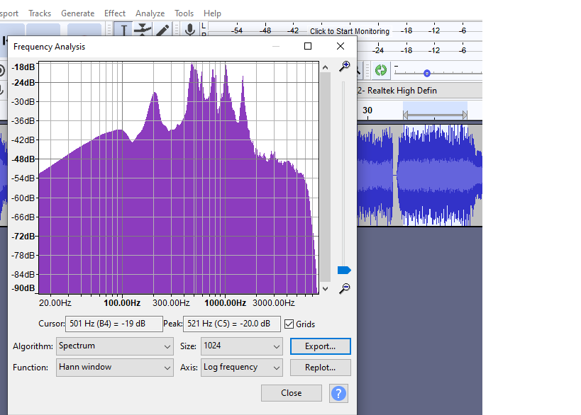

  21. The plate says: 1450 rpm 37 kW 400 V 70 A 50 Hz 3 phase Rewind (and probably last time balanced etc) 28/10/2011 Though watching the fan slow down to stop it seemed very well balanced. I believe there are 12 blades from looking at this pic: I used an Android app called Recorder with high quaility enabled on a Samsung S10 this created an AMR file that I opened in Audacity using the FFMPEG extension and applied no filtering.
  22. We had opportunity to run the fan over Xmas. Using my Android phone and Audacity I gathered this spectrum. Taken with the phone close to the input of the air to the fan. I also did a recording with the phone held directly on the electric motor body but felt this was the less noisy side. Quite hard to say as my ears are so full of sound I could not truly say which was the louder side! I welcome any analysis of this frequency plot as I'm not really sure what there is to learn from it. Thanks
