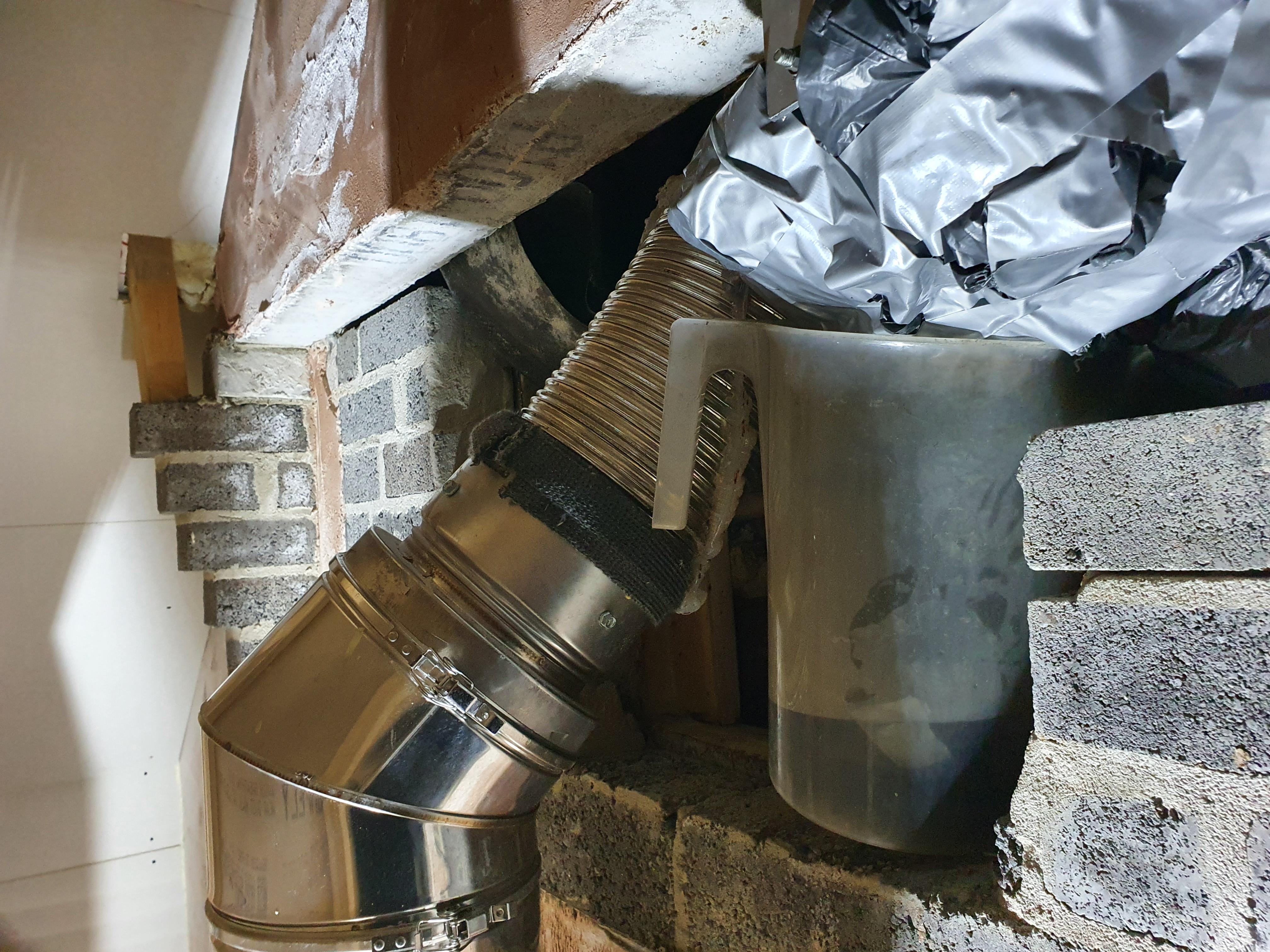

Light shower overnight and 0.5 litre collected on East stack so assume same will have entered West stack. ? -

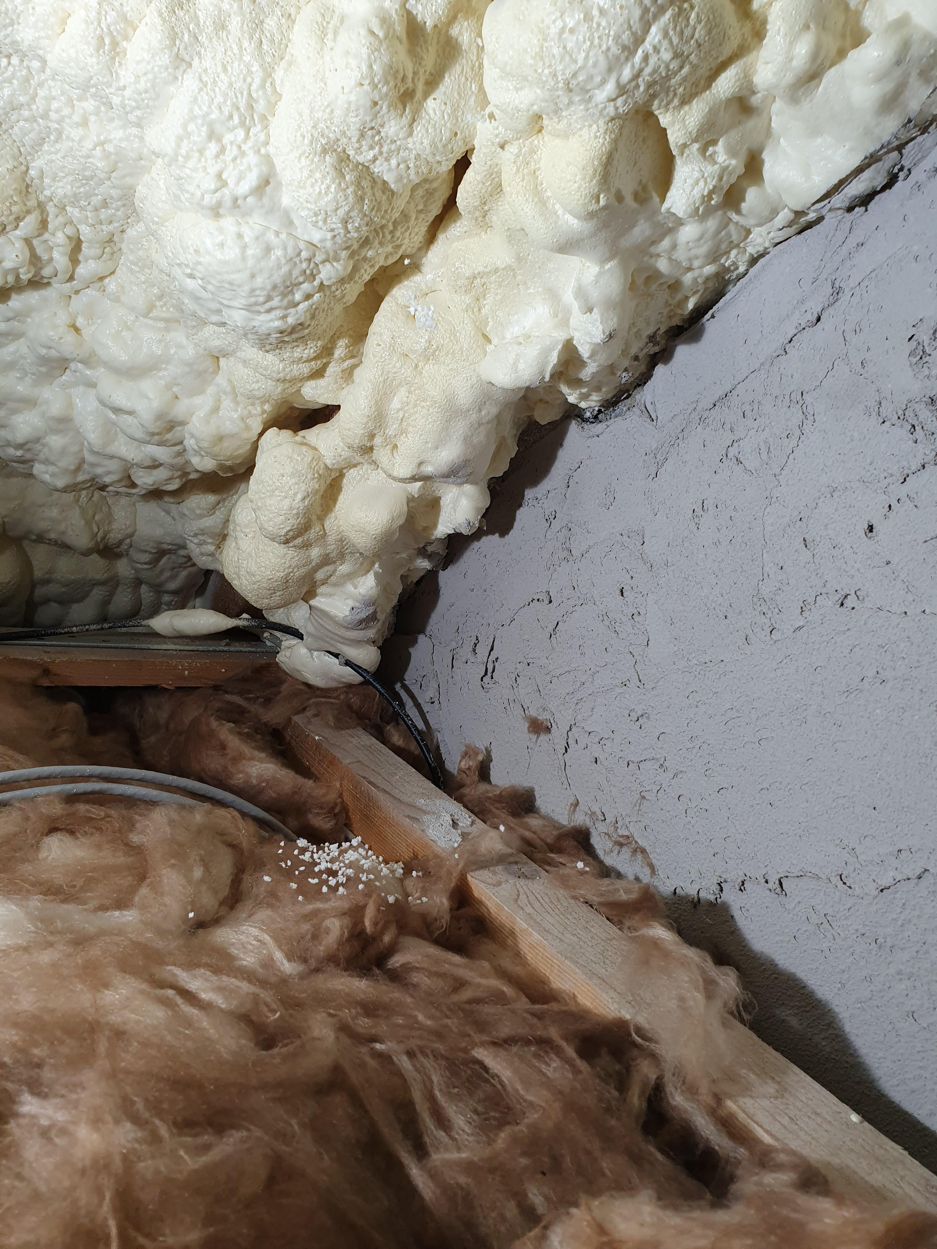

Traps installed now -

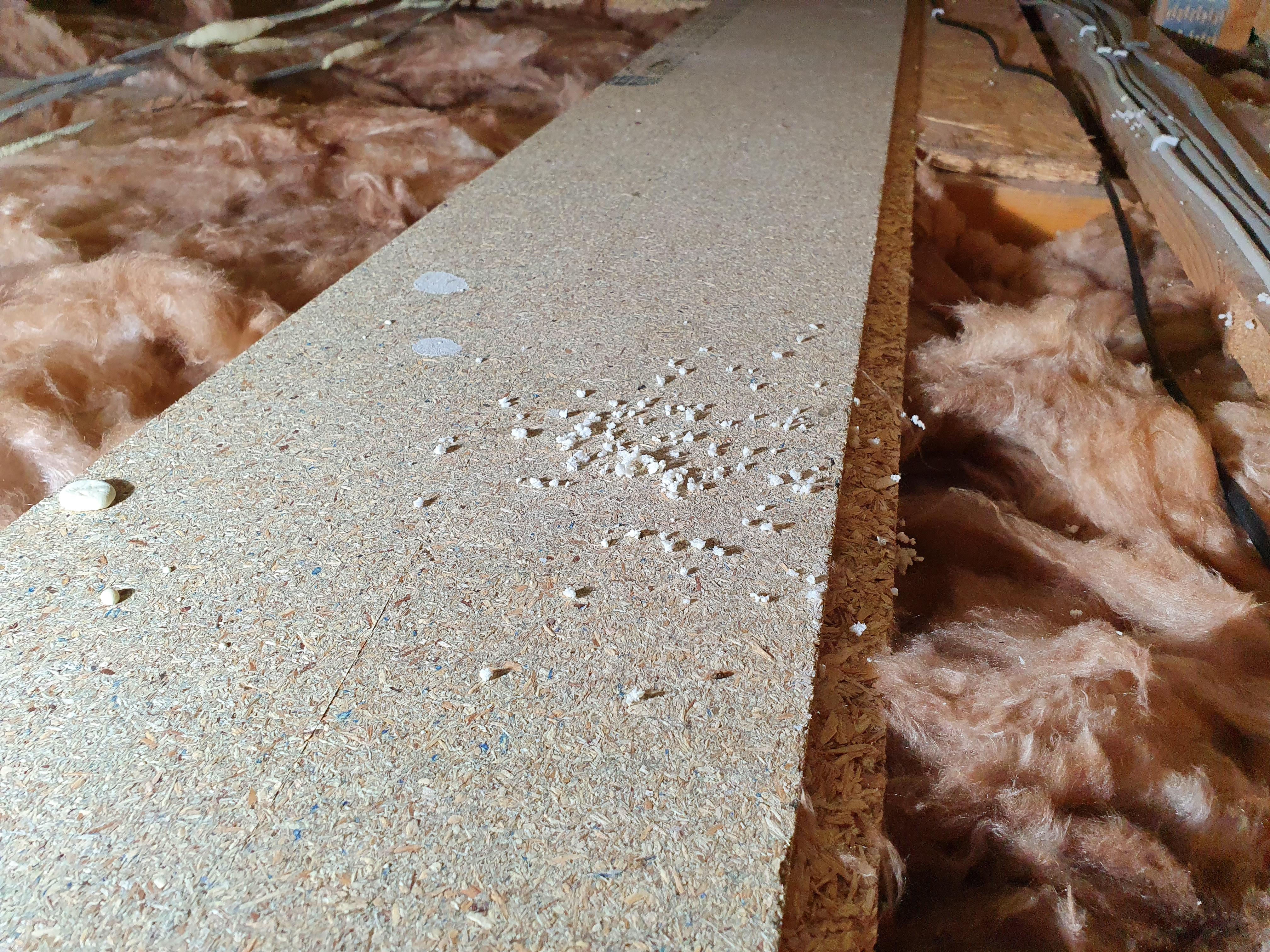

We heard some 'funny' noises this morning in the attic. No smell of mice and no droppings but odd little patches of broken foam, nibbled? Anyone experience of mice living in spray foam or using it for nest building? Thanks Paul

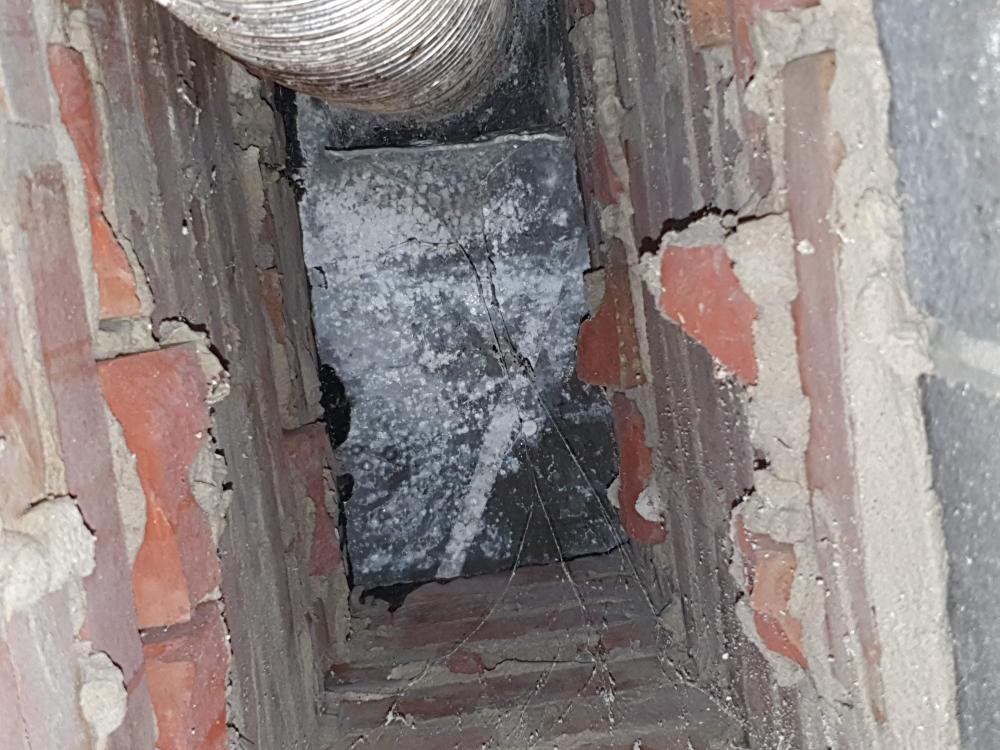

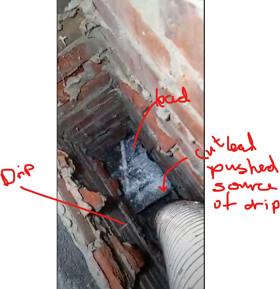

Looking up from the attic into the live stack at the underside of the lead I can see drips of black sealant (I guess). Is it normal practice to apply sealant to the brick-lead joint? thanks -

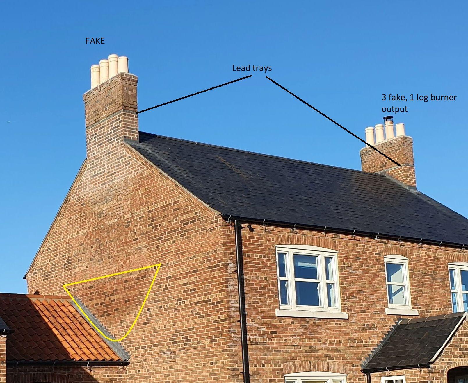

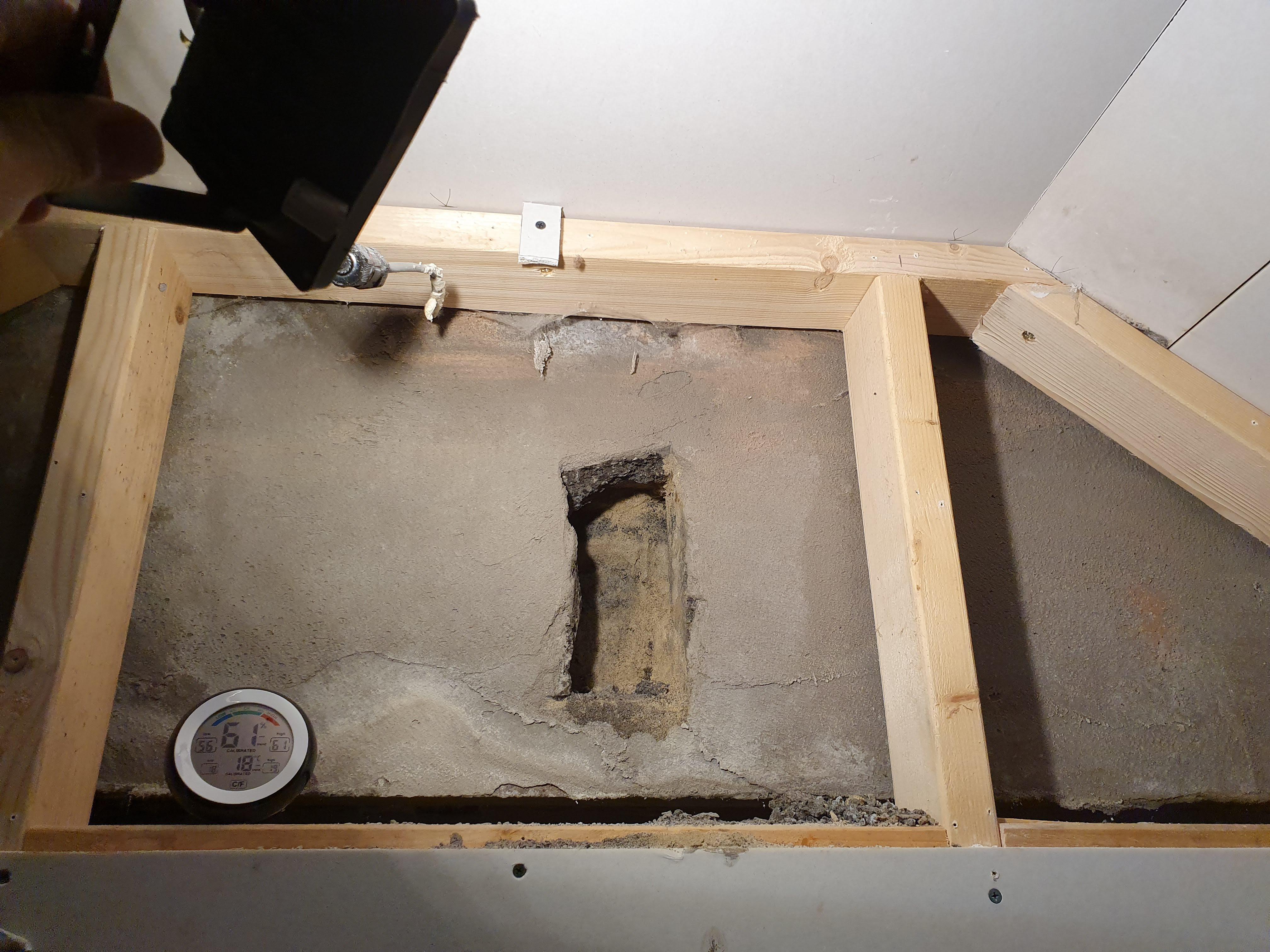

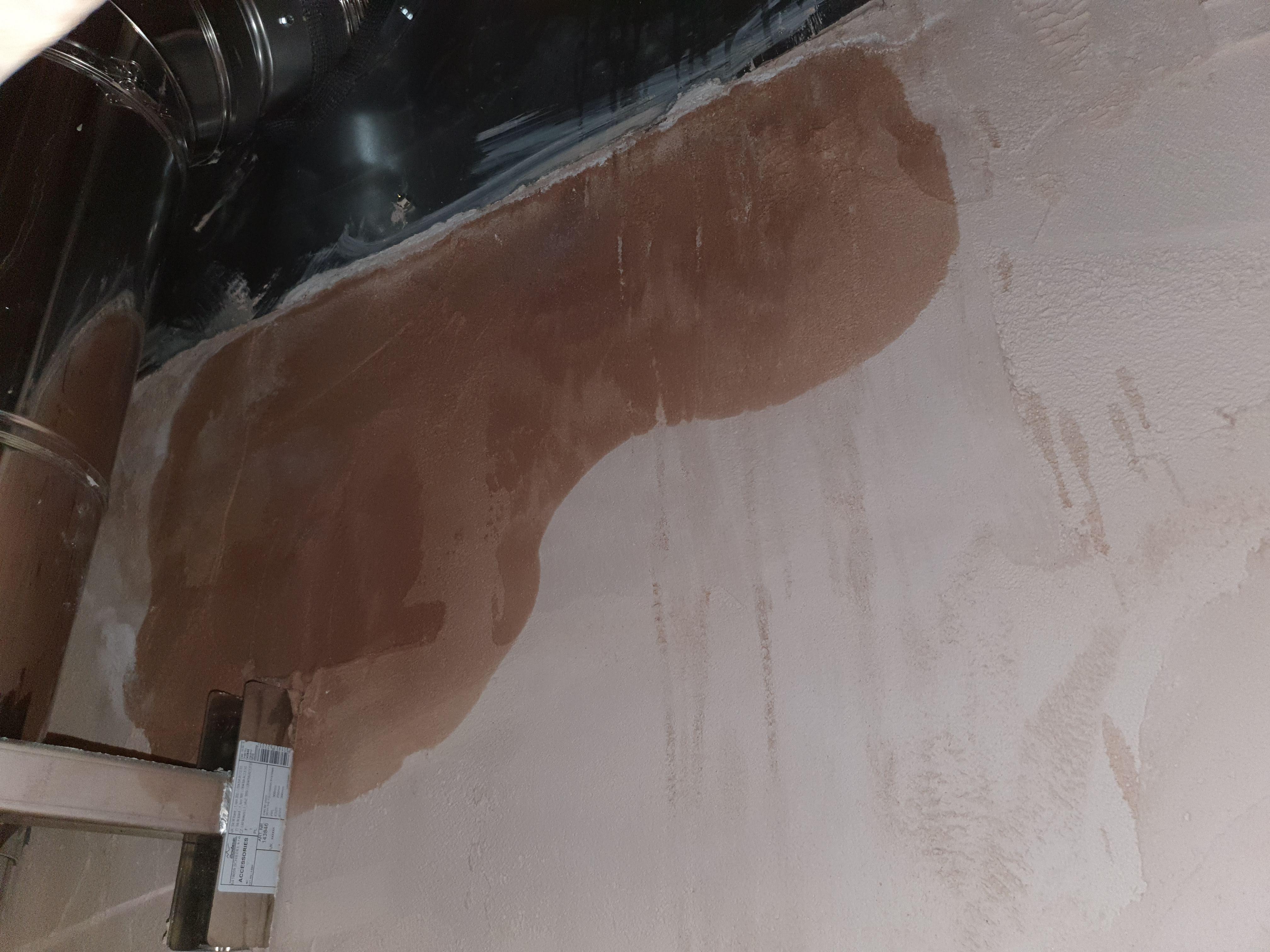

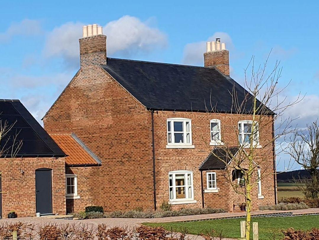

(The East stack has the log burner flue) Today the We st stack soaking of the gable end bricks has now got so far it has breached into the living space both in the attic and in the utility room (the one below the red tiles): You can see the bricks above the lead tray on the West stack are very very damp to the point mould is growing in the mortar. Below the lead tray is a patch of brickwork that has been repointed and had a water proofing applied (which has run down the wall creating the horrible looking square patch). The soaked bricks are now onto the utility wall I think considerable water is being captured in the 'sealed' void above the lead tray of West stack (which I believe is an empty single brick wall void) that is some how breaching the lead tray and various cavity trays below that. Question: * I've been told the flaunching is absorbing rain - is there a good reason for the flaunching not being regular water proof concrete? * discussion above suggest this void should be ether double skinned/insulated. Rather than using vermiculite (which once damp collapses and is damp for ever) could it be filled with rigid insulation (Xtratherm type stuff) - would that be a 50+ year solution? Thanks as always - the Buildhub continues to be a life-saver for me -

Yep I think so, pushing the cut flap down seems to be the worse option available! -

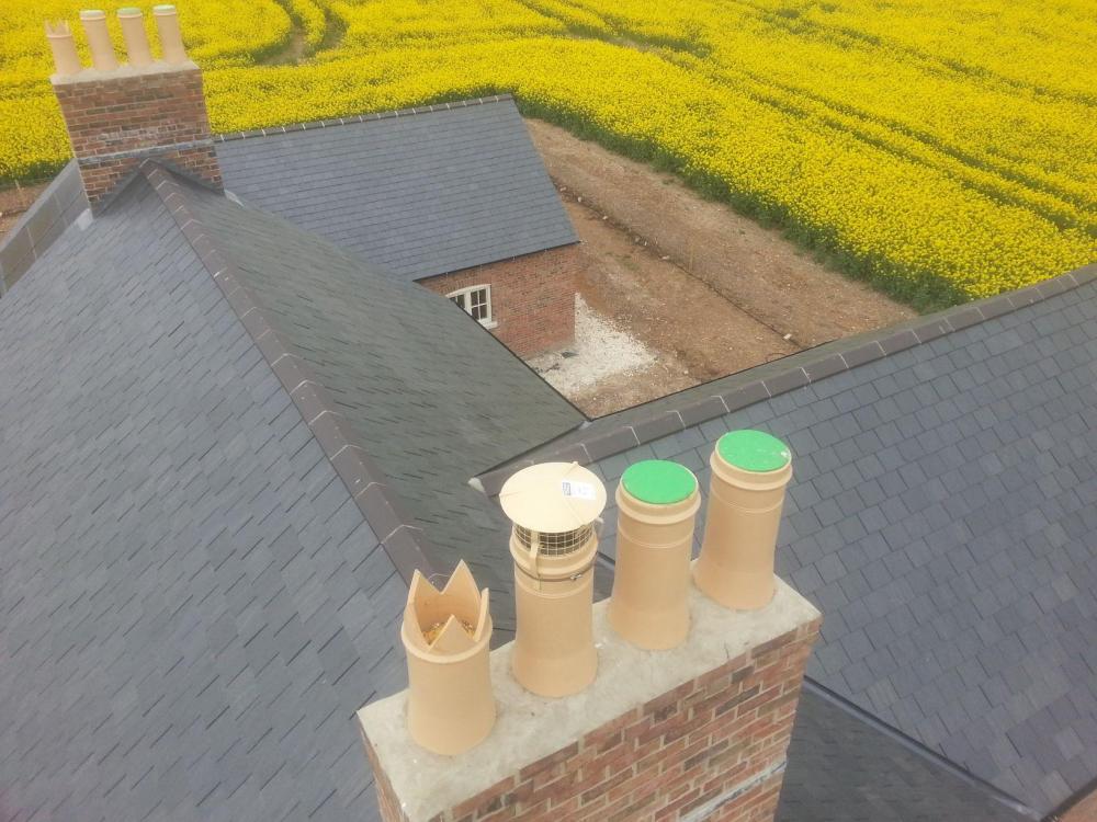

Correct: 3 pots are sealed with a fibre glass cap (assuming the cap is still there), they sit on a recessed paving slab (I think). The live pot has a flexible tube sealed to its upper lip, the live pot sits on some slate supports. The whole lot is then flaunched (to secure the pots I assume). There are no weep holes in the flaunch. Under the flaunch is a large single brick void. 11 brick rows down from the top is a single solid sheet of lead, with tiny weap holes (I've never been able to confirm if water comes out of them - and looking just now while the dripping is happening inside I can see no evidence of water running out) The builder cut a square hole in this sheet and pushed the flap down(!) so the log burner installers could run the log burner flexy flue up to the live pot. This hole was then sealed up from below, it was later also further sealed up from above. This seal is currently dripping. It is dripping because a considerable amount of water is getting into the stack void above the lead - currently the drip is 5 litres in last 24 hours so gawd knows how much water is sitting in the void. Many of the bricks above the lead tray have green mould growing up them now from being constantly damp. The builder says not his fault. Questions: 1. how many litres of rain water should a void be expected to capture in a normal storm? A few cc? Less than 1 litre? More than 5litres? (I personally assumed practically nil) 2. should I be able to see evidence of water coming out of the weap holes (e.g. after 3 years maybe staining on the lead) as I can't 3. should an air-brick be installed in this cold void (it was originally filled with vermiculite but this got wet from poor chimny pot sealing so was removed) 4. would the lead sheeting sag under its own weight so directing the collected water to the centre (and therefore around the flue)? (from below I can not see evidence of sagging but only needs to be a few millimetre to create an issue) Thanks all -

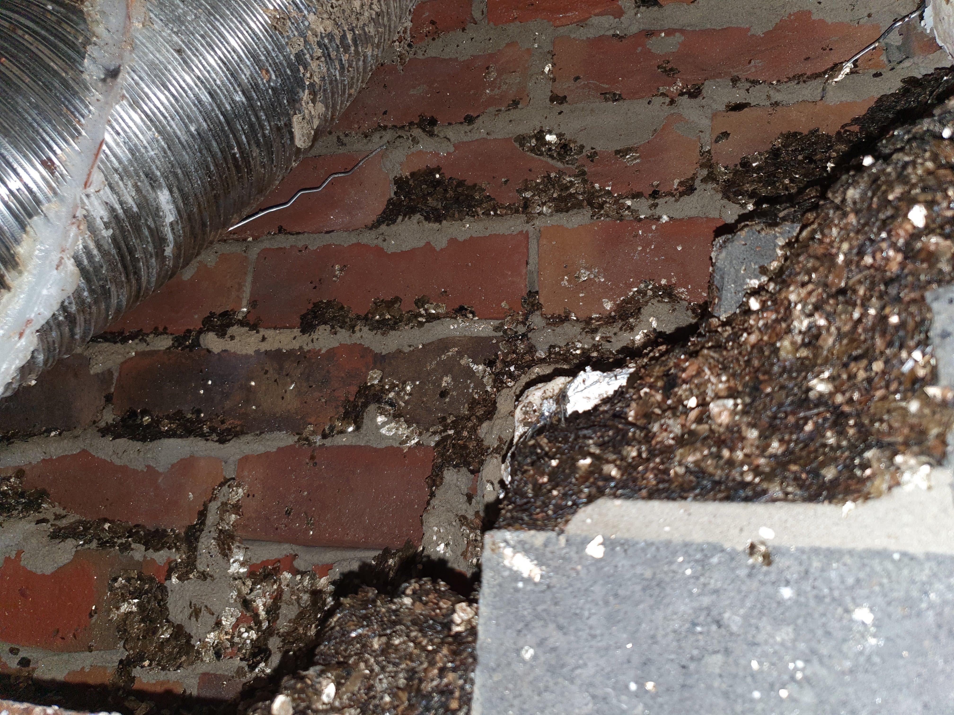

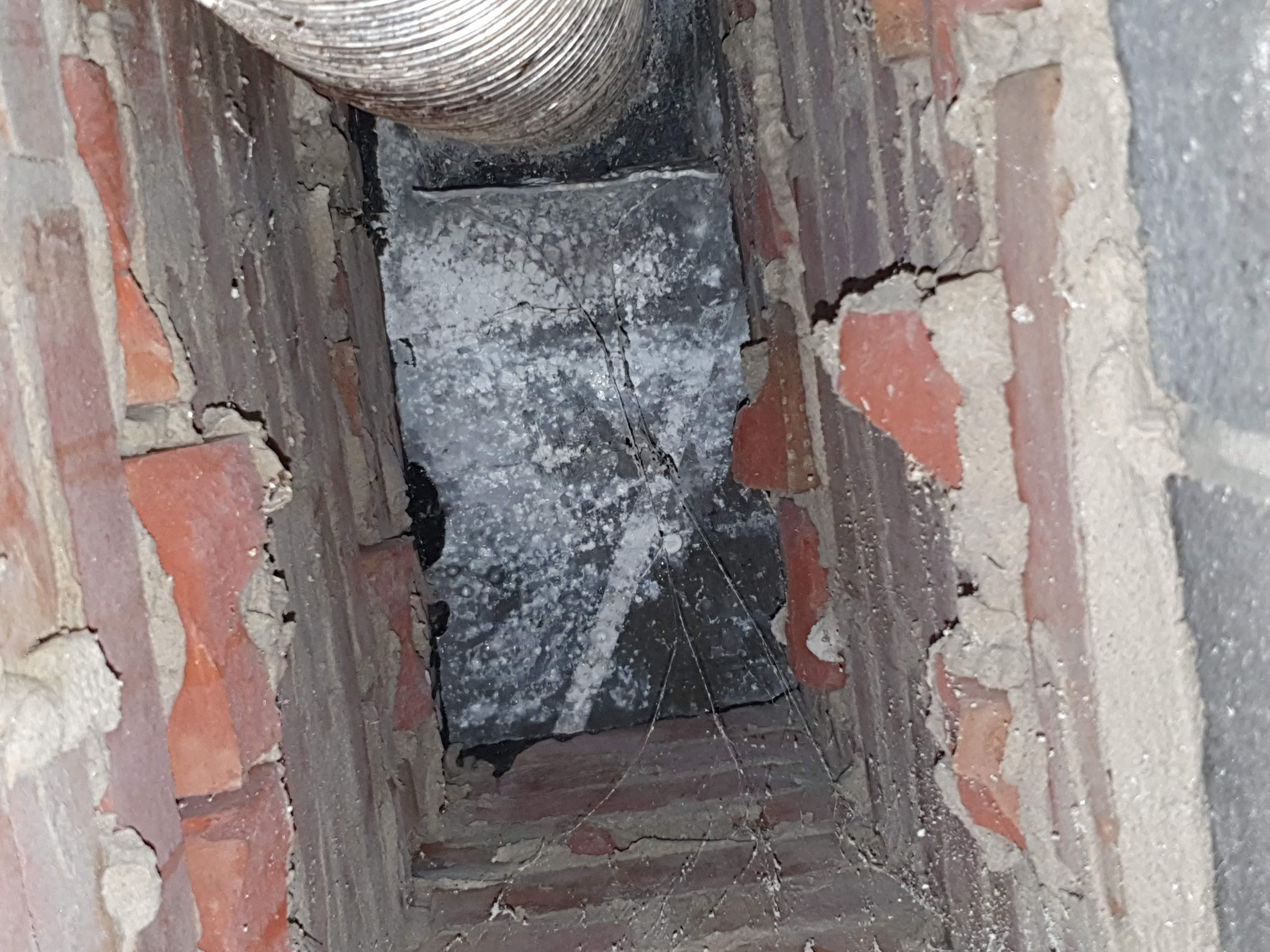

Well finally done this. Removed the steel plate sealing the flu to the stack to find all the vermiculite behind was completely soaked. The strange V pattern on the outside of the gable end exactly matching the distribution of the wet vermiculite (it was basically keeping the bricks wet). Removed all that to find water dripping in from the lead tray to flu joint. I collected around 3 litres in the last 24 hours (and it was only raining for a few hours). So I can understand making the flu to lead tray joint can be tricky to obtain a 100% long life water proof joint and the odd drip might get through, what I can't understand is why there is multiple litres of water in the void above the lead tray and underside of the sealed pots. Going to need the stack above the lead rebuilding I fear -

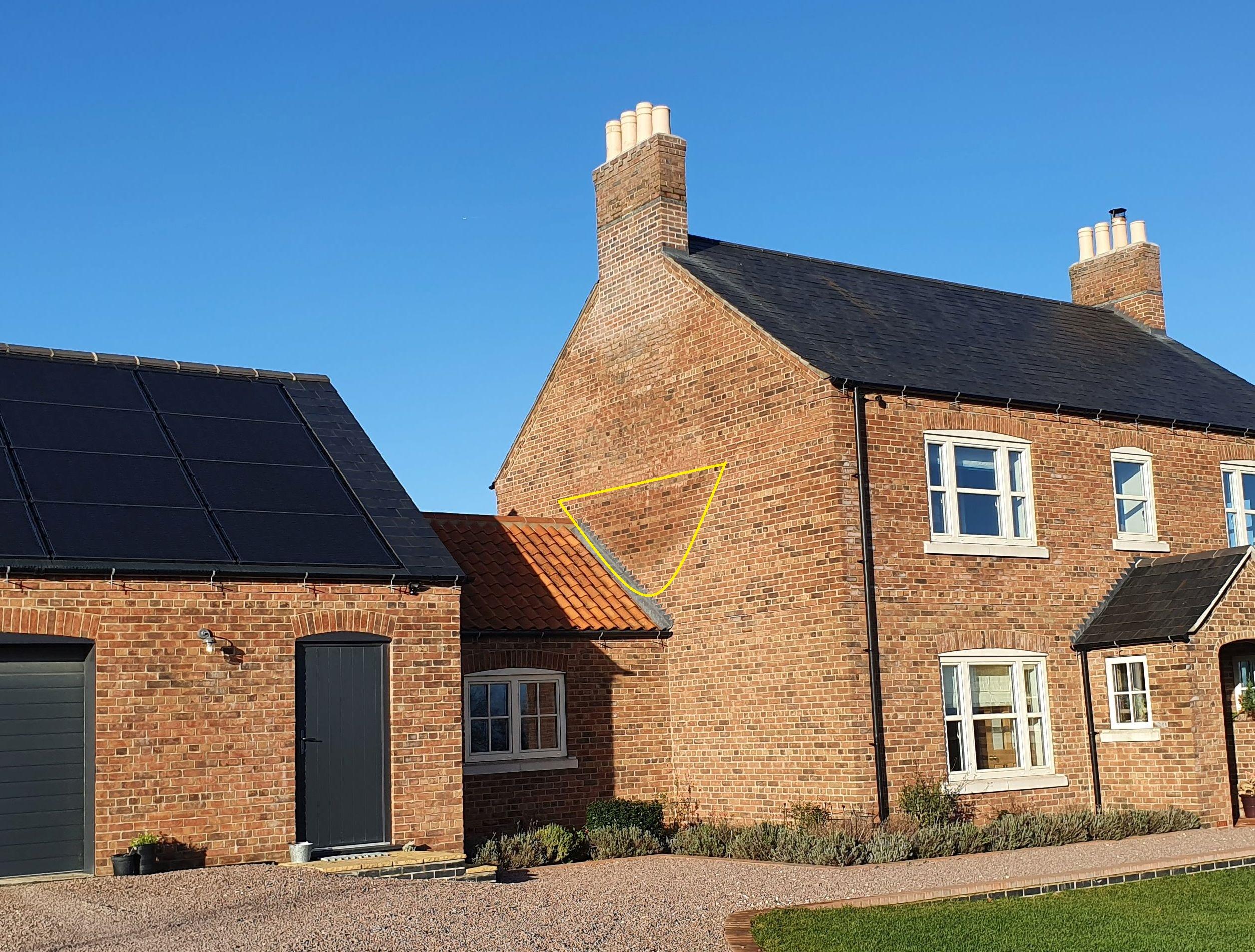

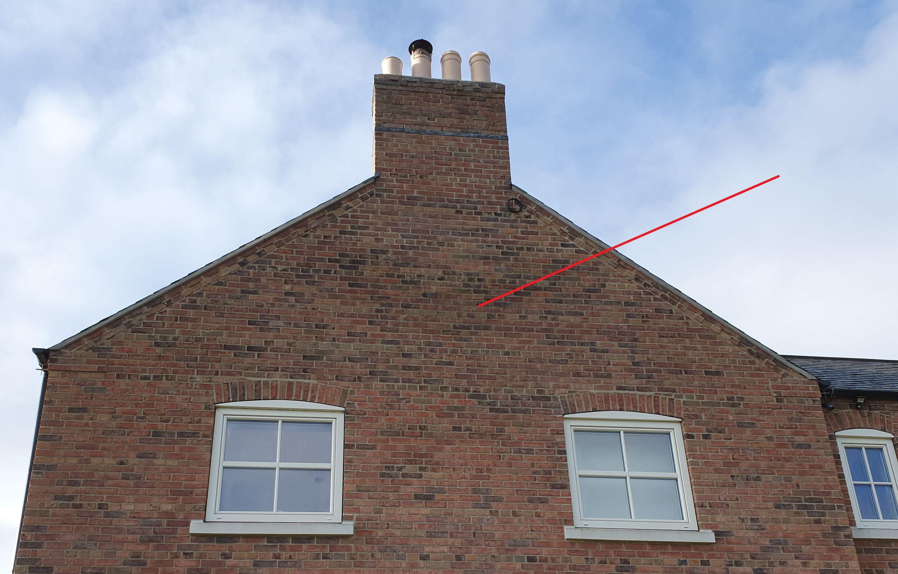

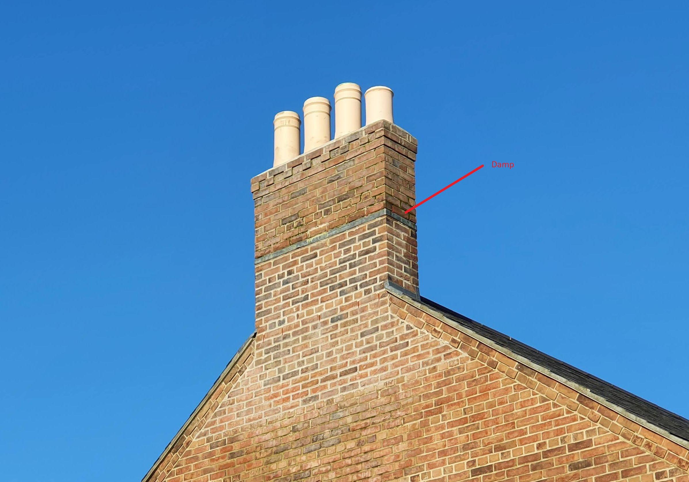

Right hand stack yesterday, you can see below the lead tray where the brickwork has been painted with moisture proofing - the bricks looking dry. But below that the bricks look very wet - a few days after the rain the rest of the gable will dry normally but a strange V shaped patch of brickwork will remain wet for a few more days. -

One half of both stacks (about 10 brick courses below the lead tray has been coated by some water proofing - which has made the outer wall look an ugly patch work of differences (especially with part of the stack being rebuilt, in a previous attempt). The waterproofing/rebuild/insert of another cavity tray of the left stack has stopped damp coming into the attic space. There are weep holes above the lead tray and cavity tray. I'm told the soaked looking brickwork below the water proofing is simply the water that has run off the water proofing but I find that hard to believe that it can then enter the utility attic space. Prior to rebuilding the stack an investigation was made into the left stack and this reveal wet internal blockwork. I don't know what the lead tray is sat on DPC with a weep hole directly below the pots would seem a good idea. The right hand stack continues to have internal damp issues (it has had the pots removed, resealed and reseated) - that is the big damp photo (I don't know how to place photos in the text where I want them, sorry) The attic photo with the blue box shows the damp from the left hand stack soaking into the utility attic space. The stepped flashing has been inspected, not by me, but I'm told is in good order. Yes both stacks are corbelled - last photo. -

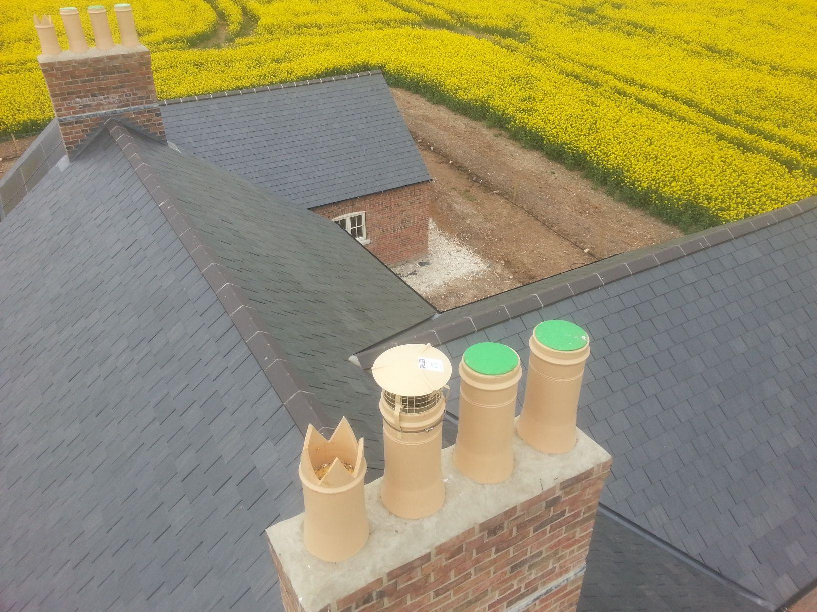

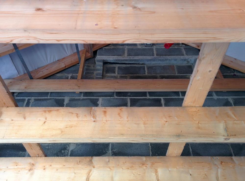

There is a cavity tray (thanks for correct term) higher up the wall but nothing directly over the utility roof line. The dummy pots sit on concrete tiles built into the top lip and then surrounded by a concrete bed. Below that tile is a void and below the lead tray is another void. Best picture I can find: Any moisture that the pots get internally should be held by the tile I think the builder said, though how the brick course above the lead tray is so damp I've no idea: -

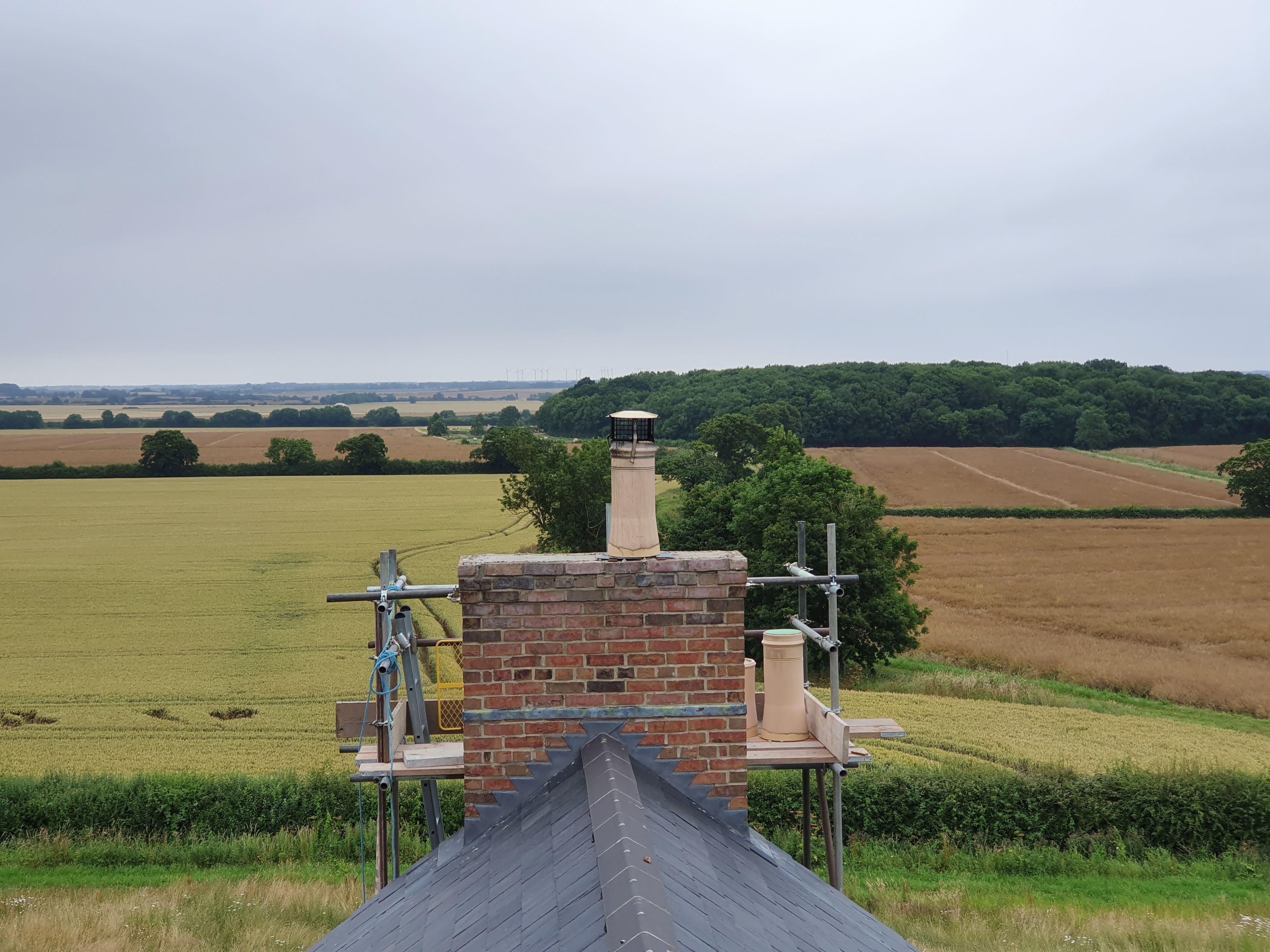

Yes I would call them 'standard' clay pots. They have been capped with a fibre glass lid and sealed as per this image. Since the image was taken the shorter king pot has been de-crowned and also likewise capped and sealed (during this process the existing lids and seals were confirmed to be in good order). Question can the clay pots act as 'moisture gatherer' - as I'm likewise wondering if the uninsulated void below the lead tray acts as moisture gatherer - i.e. the damp in the air is able to penetrate the bricks and/or clay pots and build up to significant levels within the void. (There are damp trays in both stacks below the lead tray designed to dump any water that gets inside the stack through weap holes onto the outer edge). -

Both stacks only extend into the house attic space i.e. they do not run all the way down to the ground floor. The right hand stack (when viewing the house from this aspect), has a twin wall log burner tube liner passing through into it. Not sure whether you would call them fake/false stacks? -
Looking for a 'Defect Diagnosis' expert to investigate/explain the issues with my chimney stacks (and other related matters) on my Lincolnshire new build: Any recommendations please? (the architectural surveyor I had assess the property half way through the project has moved away and is not really interested)

So the soaked looking bricks (in the yellow area) actually extends into the attic space of the clay tiled roofed utility ? -
