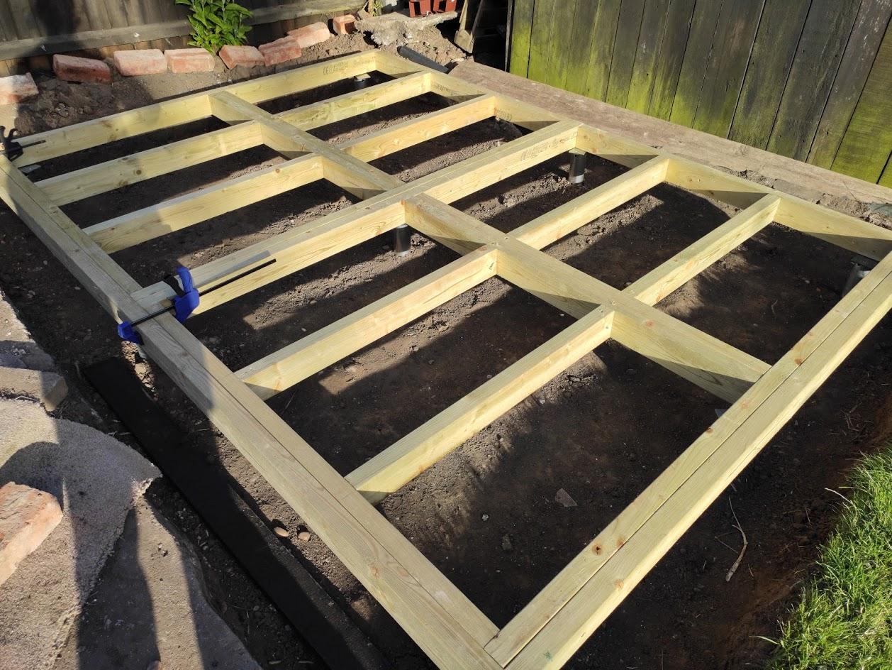

I used The Groundscrew Centre. What they were offering was enough for my soil type and structure. It came to about £450 all in, including delivery and the tools/drillbit required. I know I could have done concrete pads for cheaper, but this was so much easier to get perfectly level in an afternoon.

I try to avoid concrete where I can. This was totally dry and totally DIY - after getting advice for the right screws that would support the weight of this building. I did have to scan the ground first though - I was petrified about screwing into a pipe or cable so wanted to make 100% sure. Here's a sneak peak of the floor before the insulation went in. You can see the ground screws underneath.
