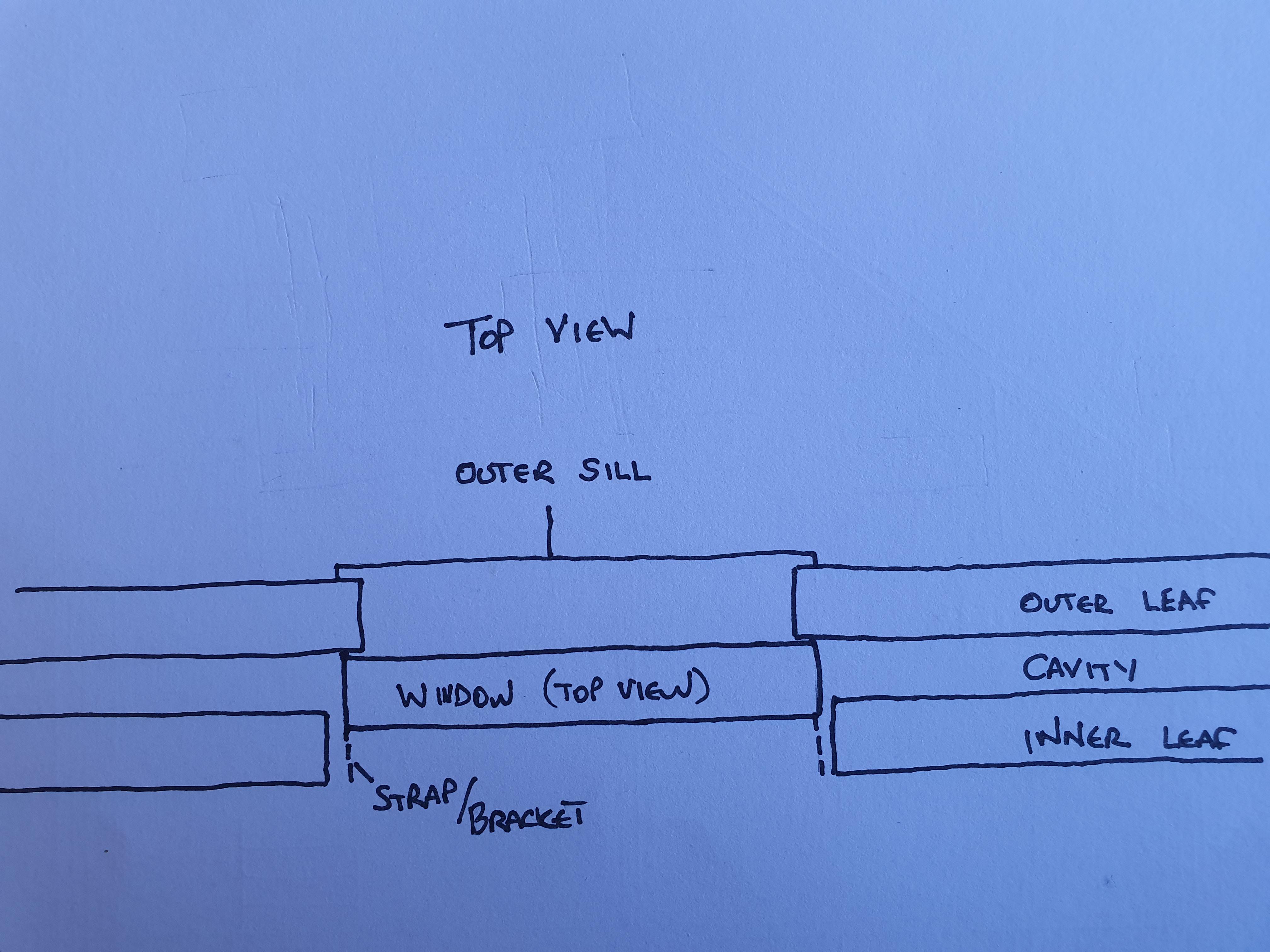

Check Reveals -v- Insulation -v- New Windows
Fraser Lamont replied to Fraser Lamont's topic in Windows & Glazing
Not quite, but you do know what you're talking about - my other house built in 2010 is Timber Frame, windows arrived fixed to fire stops, windows then partly sat on the timber frame and fire stop battens fixed to the cavity side face of kit panels, when the block work went up the outer reveals were rendered up to the windows. Issue I have is on my other house, it's a mid 70's house - its double block built. I have totally gutted the house, I know the windows have to be replaced from the inside but I'm a bit stuck. The top and side reveals look as though they are at least 50mm larger on the inner leaf (quite possible 50mm - 80mm). Walls are made up of 100mm Concrete Block with a 75 - 90mm Cavity. You're correct about the windows which were replaced about 30 years ago - they look as if they were bodged, and they are EVEREST Windows. I want to use best practice with regards insulation and window fixing. If I use cavity closers (would need to be single flange to fit to the edge of the inner block leaf with other side butting up to inner face of outer block leaf - so check reveal closers) but that won't solve the issue where the brackets from the windows could be a couple of inches away from the edge of the inner block leaf. If I use PIR to close the cavity - butt that up to inner face of external leaf and run it like a reveal to the inside edge of the inner leaf, would I just need some sort of packing/standoff for the window straps/brackets to get good purchase on the edge of the inner leaf? Will be using NORDAN windows which are heavier than the Aluminium EVEREST windows in there at the moment and heavier than uPVC windows. Is Compacfoam designed to fill this gap as well as be used as a spacer between window and internal leaf reveal? Can a bracket fixing go through Compacfoam then into block work? My image roughly shows the gap between window strap/bracket and inner reveal. Speaking to NORDAN, they don't like people bending window brackets to fit. To add to that, though I'd want at least 25-30mm of window frame to be sealed against inner face of outer block leaf (at Top and Sides), NORDAN windows don't have a very deep frame from frame edge to the edge of the opening sash therefore they recommend using all inward opening sash's which may ruin the design. The outer reveal may prevent an outward opening sash to operate if I have 25-30mm of the frame (top and each side) hidden behind the outer leaf block. With such a shallow outer frame, it appears that NORDAN windows are designed to be fixed to the outer leaf wall. It's a nightmare!- 5 replies

Hi, I'm currently renovating a house on Skye, typically in Scotland, the window recesses have check reveals. I'm looking at getting Nordan Alu-Clad Windows. Problem - there are check reveals. I want to get rid of the old timber in the recesses, the house built mid 70's I think the original Windows (long gone) attempted (badly) to close the cavities. I want to install the new windows the way the house was originally built - front face of window frame tight up to inner face of external block leaf. Problem would arise where window fixing straps/brackets are used. They'd either have to be bent a lot to reach the checked reveal thereby making it difficult to install Insulation on the reveal, or could I pack out the inner reveal with something like compacfoam and fix the brackets/straps through that and into the edge of the inner block leaf. We get some wild weather now an then so like the Windows to be recessed nicely. If I can use something like compacfoam, could I continue it into the Cavity to the inner face of the outer block leaf in order to close the cavity? Or do I make a timber frame to fit the inner block leaf window recess, fix that into the reveal then fix Windows to that? So many different ways of doing this, I'd really appreciate input as to what's the best course of action. TIA

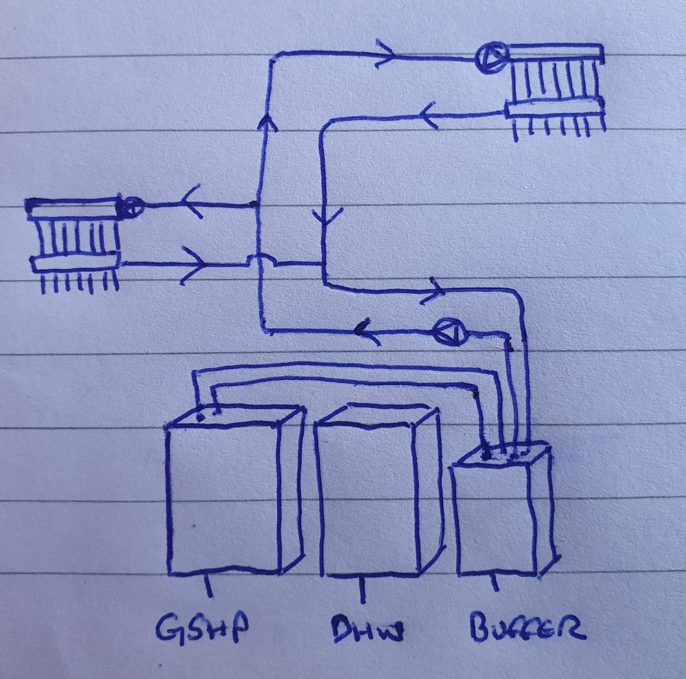

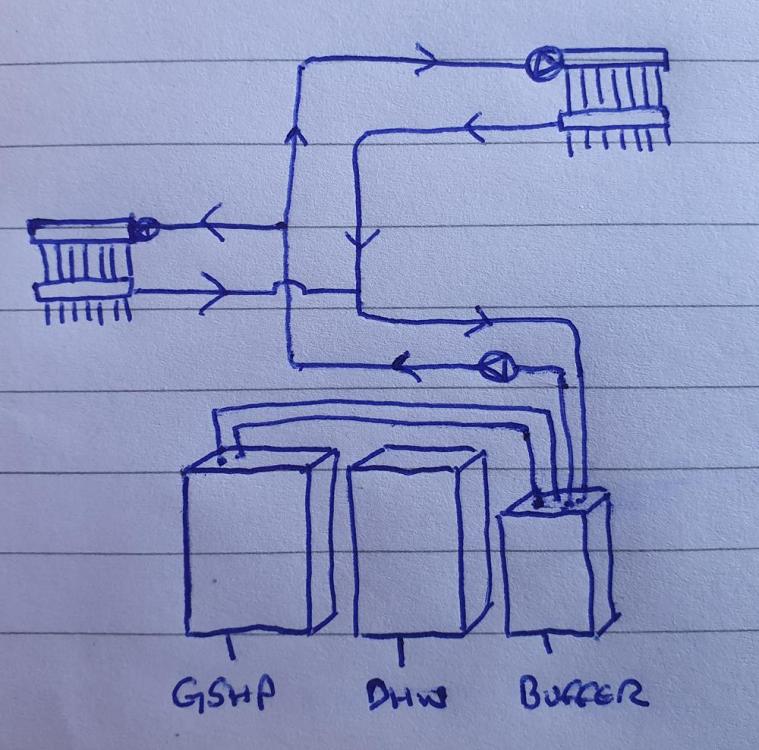

GSHP, Buffer tank and UFH
Fraser Lamont replied to Fraser Lamont's topic in Ground Source Heat Pumps (GSHP)
@Nickfromwales It's my last drawing which is a bit crude, the system was designed for me almost 15 years ago for my self build house (Ice Energy). I wasn't accurate regarding the manifolds which look daisy chained but they're not. A fairer representation of my heating circuit is like this -
Return Temp. Today for example, when the return water goes down to 34c, the ground Source Heat Pump starts the heating cycle and keeps going until the return hits 39c. The water temperature being sent out from the GSHP is approximately mid 40c to increase the temperature within all the underfloor heating loops. I'm on the Isle of Skye, Highlands, and it was so cold last night that my car door was frozen shut. Water temp leaving the heat pump to UFH never goes above mid to high 40's and every room is 21-22c. A decent enough size house with 4 x bathrooms, hit with all sorts of weather (coastal), I love the system - only problem is retrofitting upgrades not always easy, it was designed purely for economics (running costs) by the company I bought it from. Care should be taken to include comfort but this system is nearly 15 years old now, installed it when I built my house -
@Nickfromwales could a bypass between flow and return on one of the manifolds work, as above?
