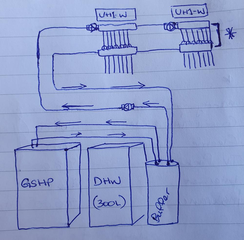

  2. @Nickfromwales would this work, a bypass at the end of one of the manifolds? My system is getting on for 15 years old now, the first couple of years the upstairs bedrooms and bathrooms only were on thermostats, I had to retrofit the controllers for downstairs, far too hot, very cheap to run because of all the water pipes in concrete, but too warm.

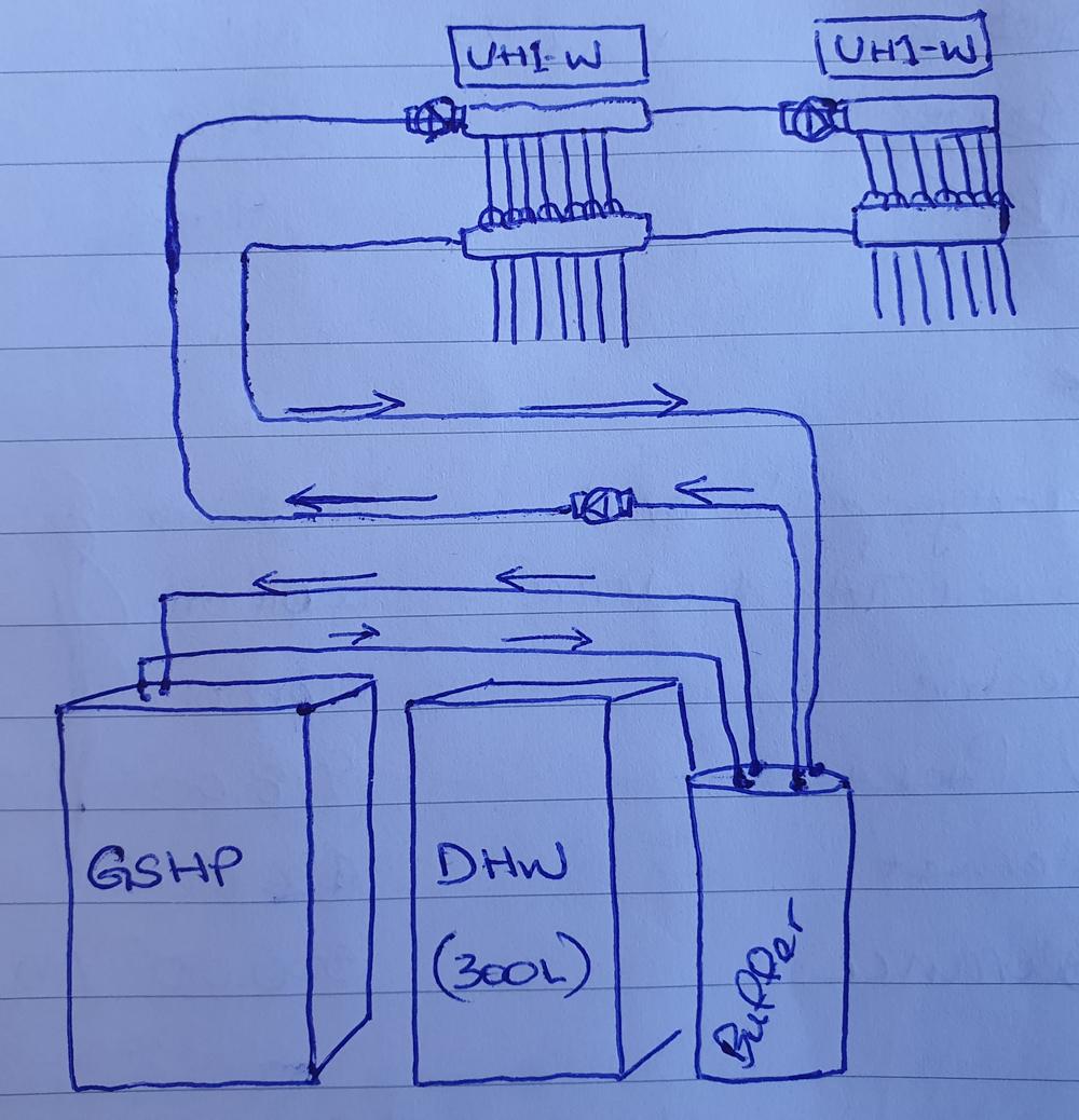

  3. Subject moved to it's own thread. Nick from Wales, could you repost your last image to the new thread? I came up with a plan that could be similar to yours. TIA
  4. The other thing, if the main circulation pump is rewired to the heat pump then switches off when not in heating mode, there'd be no return water for the heat pump to work out the temperature of the water in the system. There's always a 5c difference, say the water return is 34c (cold outside temperature), then the heat pump cycles until the return water temperature hits 39c then stops. Would I then have to rely on the main indoor air temperature sensor which provides settings such as how much influence (1 - 10) the heat pump should use based on these readings? Jeez, this could get complicating
  5. Hi, no, it was designed for half my heating circuit to be open permanently but the house was 28c. It was designed that way so the Heat Pump could always sense what the return temp is, thereby work out when to cycle the heating. That was before every room had it's own Temp controller - the Heat Pump was doing that job before (crudely). Now I have full zones and buffer, I think the Heat Pump should now be only switching that circulating pump when it's on underfloor heating mode - for just now I've had to remove the Valve Motorized Head (manifold) from one of my upstairs bathrooms just to stop the pressure from the pump fighting against closed circuits. The other 2 pumps on manifolds only come on when a room calls for heat (Heatmiser UH1-W). My Installation book does mention controlling the "External main pump in the heating system G1(P1): The external main pump should be connected to the terminal card in those cases a bypass is required. The pump is connected to terminal P1". I do have a bypass installed - nowadays they probably use automatic bypasses. Thanks
