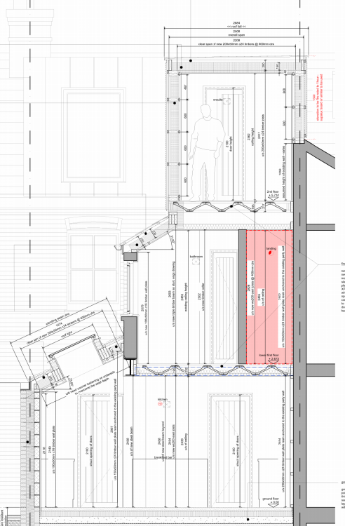

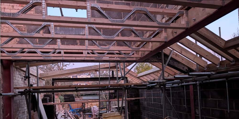

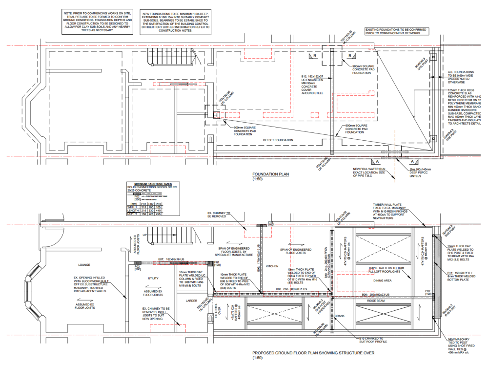

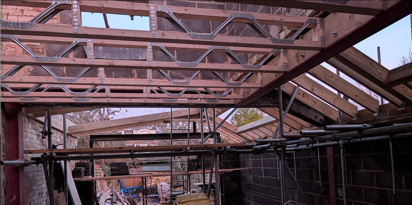

  3. Thanks Nick. Here's the SE drawings, relevant section of regs drawings, and photo of the key parts . The steels B06 and B10 form cold bridges with the ground below. They support a solid wall above. You can see blockwork internally but we had to rebuild a section and couldn't make this a new cavity wall. The webbed joists hang off those steels and pocket into the old solid brick walls. So it's an all an inherent compromise- but I want to take sensible precautions to stop the kitchen vapour condensing on cold spots.
  4. Thank Nick, does that mean we shouldn't insulate the beams then? They have external solid walls bearing on them so I (as a total amateur) consider them a cold bridge/condensation risk? Perhaps all academic given that we're getting crittall-style doors as a massive thermal bridge

  7. Some joists come off the steels, so these will have cool ends- the spray foam will hopefully stop vapour getting to condensation spots. We have the same situation with old joists in the solid walls. I've seen some recommendations to avoid internal insulation at the joist pockets to keep these warm, and others to insulate and tape around the joists for a continuous VCL.

  10. We have most of the steelwork up in our wraparound extension and loft conversion. 1905 mid-terrace, solid wall construction. We have picture frame steels sucking heat into the ground and steels bearing on to (and/or supporting) cold brick walls. I'm looking to minimise the impact of cold bridging. The wraparound is brick and block with mineral wool cavity, pitched vented roof. The loft conversion is timber, vented cold roof (unfortunately necessary). Priority 1 is to avoid condensation, priory 2 to reduce heat loss. No cold steel near bathrooms, but plenty near the kitchen in the wraparound. The builder suggested PIR or mineral wool around the beams, but I worry if we insulate without a vapour barrier against the steels it will worsen interstitial condensation? I wonder if spray foam is a sensible way to do this, cutting the cold bridge with a continuous vapour barrier I can tape against other membranes. I've sent the horror stories but get the impression the issue is where critical ventilation e.g. cold roof is compromised by the spray foam. Other relevant measures are: -internally insulating solid walls (planning on vapour-open with thermactive plus wood fibre). -windows uprated -We'll be getting as airtight as reasonably possible -MVHR system fitted which I will control based on internal humidity Grateful for any thoughts- couldn't see similar in the forum surprisingly

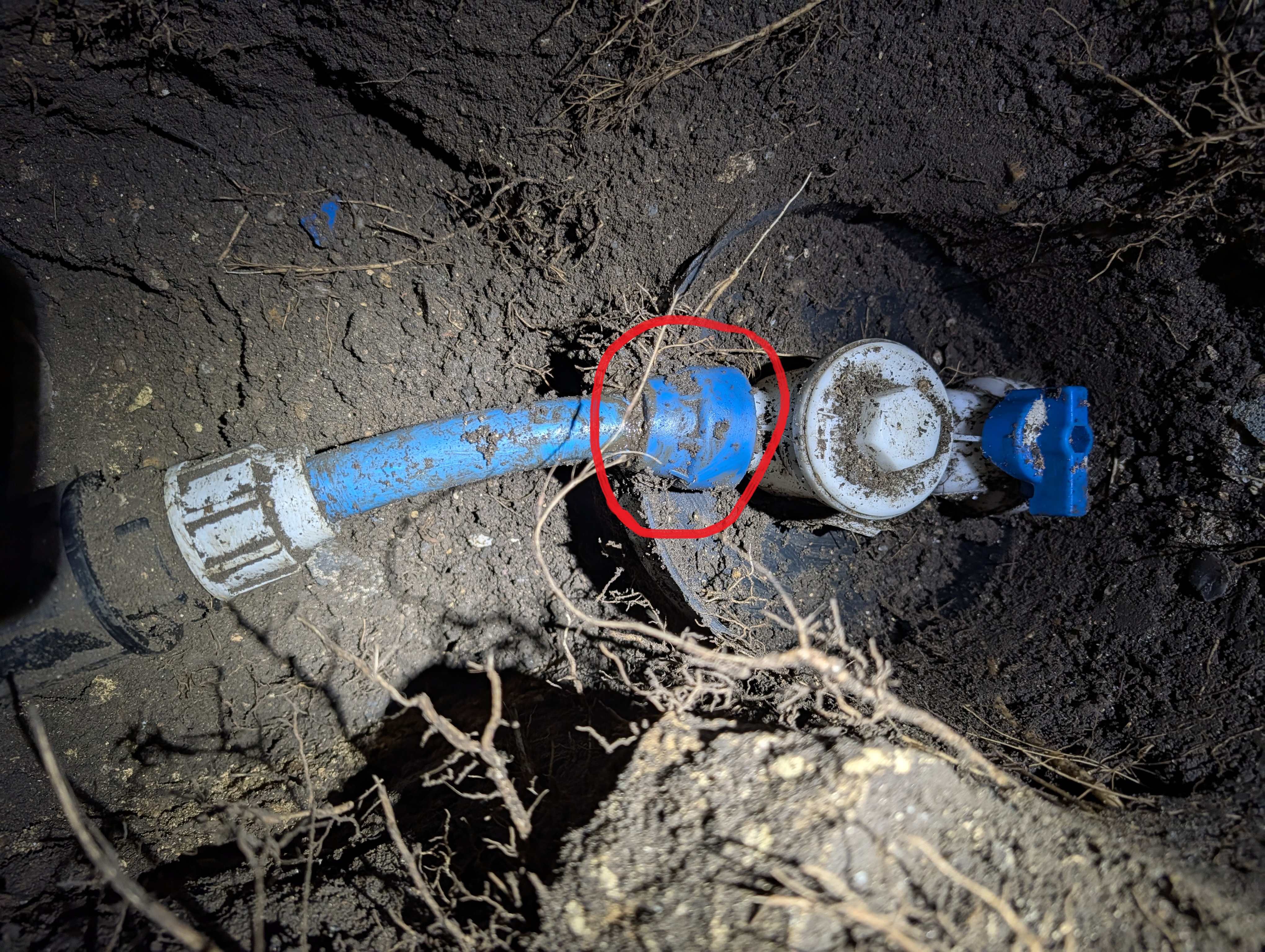

  11. So looking at it yesterday it seems like the thrust ring, at full thrust, doesn't make contact with the o ring I took from new mdpe coupler. The new o ring looks to be 3mm thick (calipers time in the daylight) so I'll try upsizing it. The only other option I can think of is there was some sort of spacer between the thrust and o ring, or an o ring with a weird oval section. Typical plumbers' merchants aren't familiar with the fitting- I have been recommended a 'civils' merchant who stock the Binary box itself
