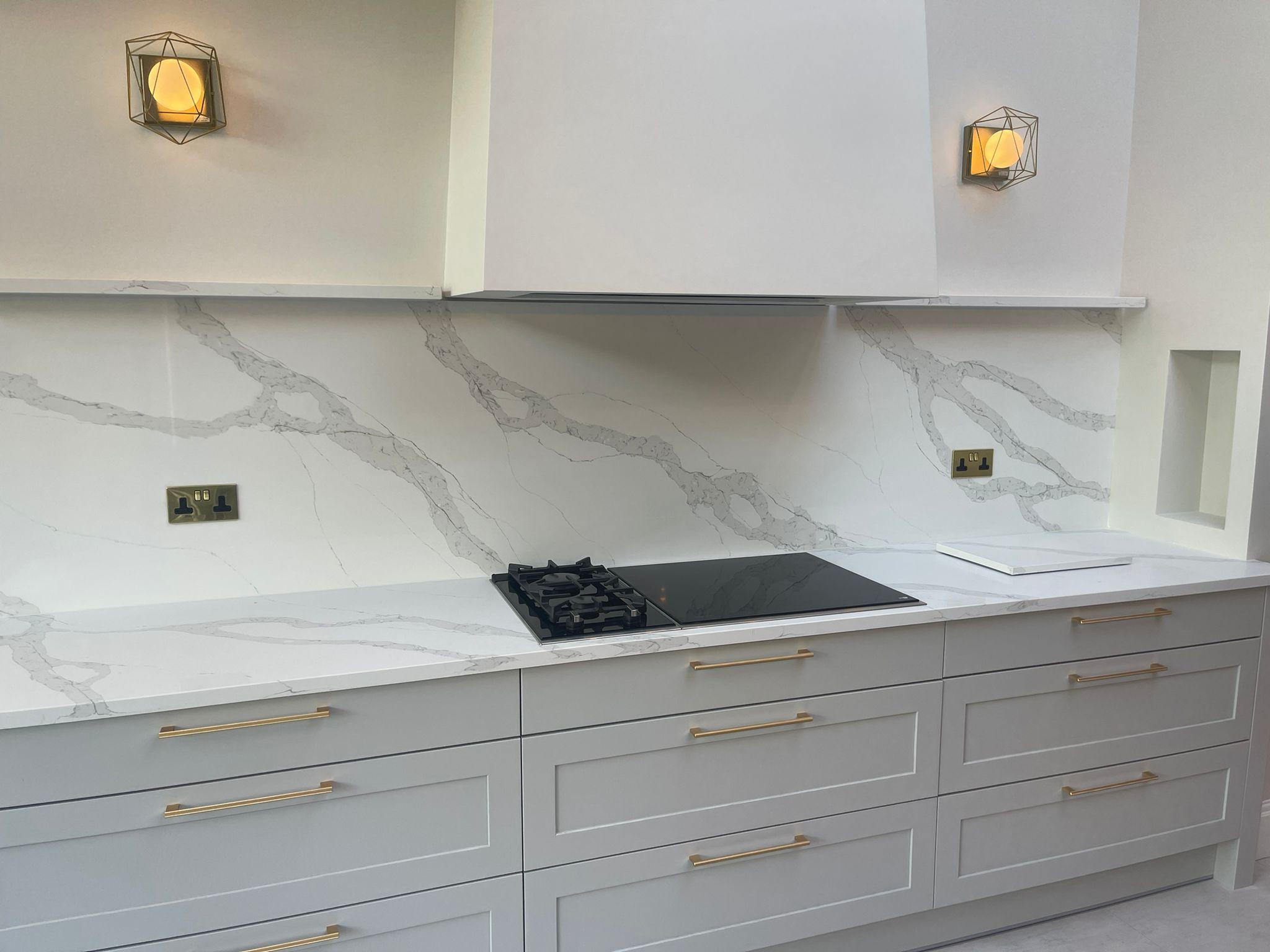

  1. Hello, Exactly what you said. That is the best way. I was hoping I had a picture but we would usually make a recess and drill a hole in the back of the quartz shelf and use these: https://www.amazon.co.uk/Concealed-Floating-Brackets-Hardware-Decoration/dp/B07XFCF3KP/ref=asc_df_B07XFCF3KP/?tag=googshopuk-21&linkCode=df0&hvadid=375434312298&hvpos=&hvnetw=g&hvrand=9295025951555391328&hvpone=&hvptwo=&hvqmt=&hvdev=c&hvdvcmdl=&hvlocint=&hvlocphy=9045938&hvtargid=pla-827903059895&psc=1&tag=&ref=&adgrpid=77211061112&hvpone=&hvptwo=&hvadid=375434312298&hvpos=&hvnetw=g&hvrand=9295025951555391328&hvqmt=&hvdev=c&hvdvcmdl=&hvlocint=&hvlocphy=9045938&hvtargid=pla-827903059895 We did one recently like this: The positioning is usually on the studs but yeah. Exactly what you said is the best way.
