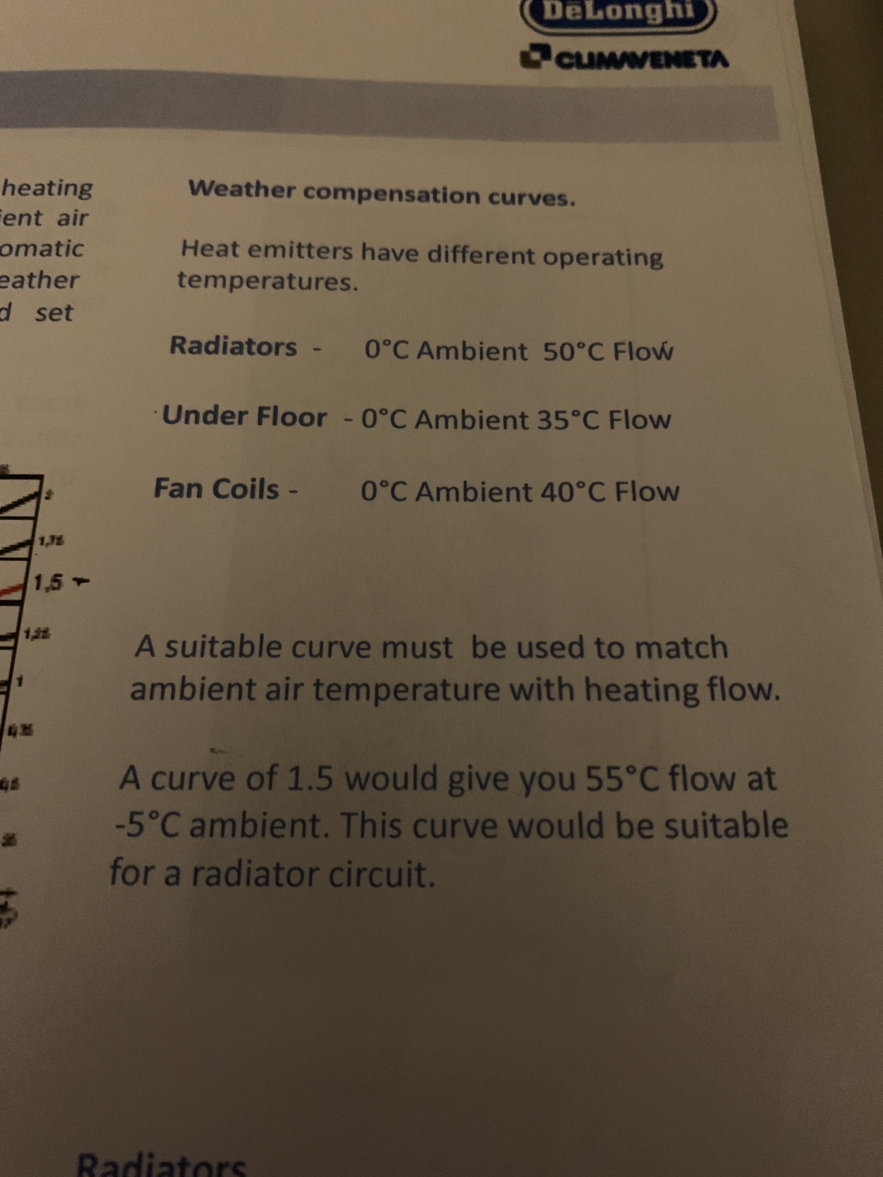

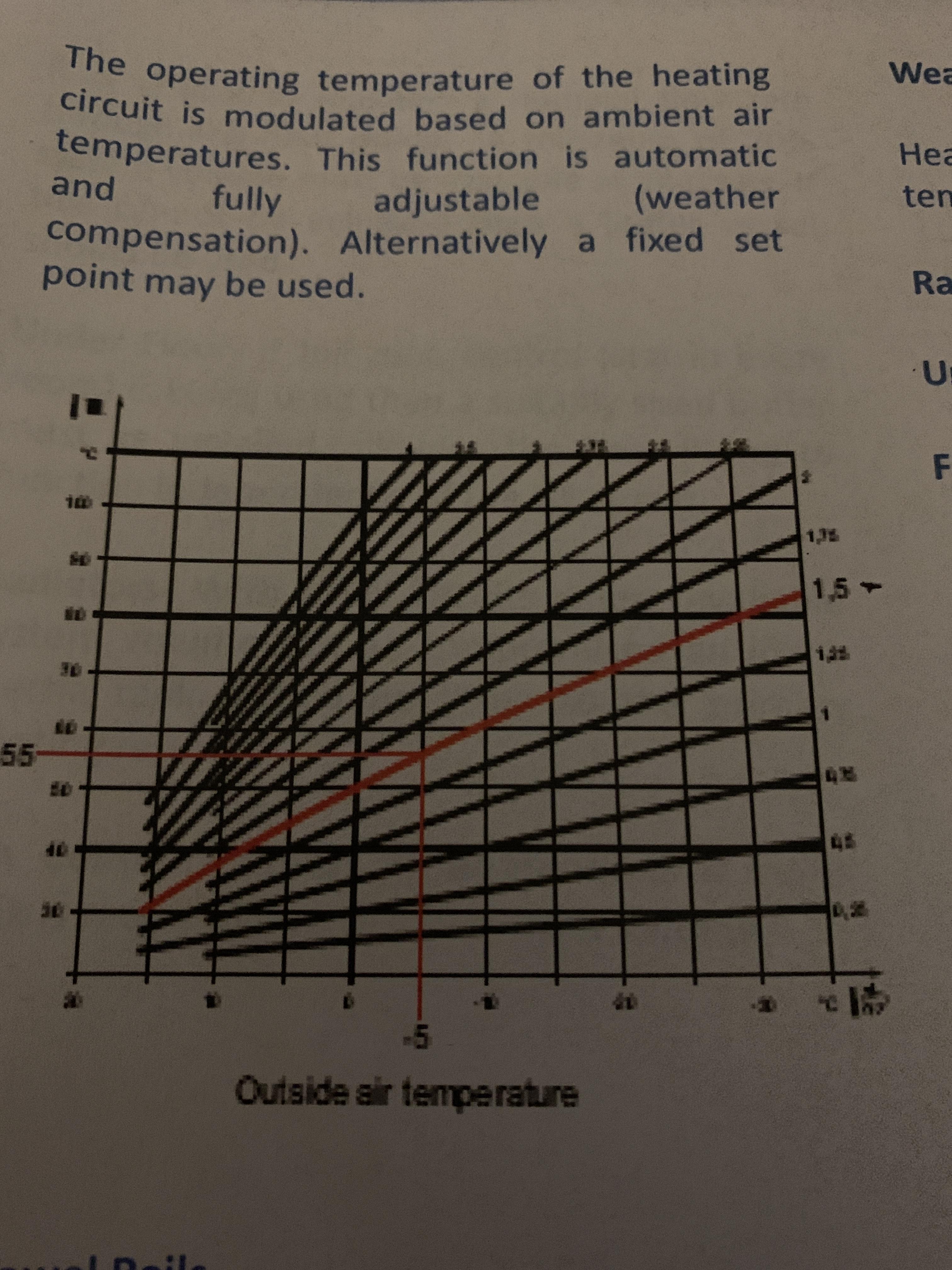

  5. Just the way it is I guess. What I need is some revised temp compensation settings to try. @PeterW ATM leaving off overnight is saving me a lot of cash and heating not too bad either. It’s never going to be great I guess in this weather.
  6. @ProDave here’s the instructions. The delta to flow is plus 5 deg or supposed to be. Mine is set at 37 and when the return of the pump temp drops to 34 it switches on again until reaching the return of 37 and so on.
  7. What do you reckon @ProDave?
  8. It is on this unit but I can read the flow too. So for example I set the return to 37 and the flow will read 40. Always a 3 degree delta. The input is always entered by selecting return temp.
  9. @PeterW I’m around 74kw now when I switch the UFH pump off from 12 until 5 in the morning as opposed to 113kw leaving it on 24/7. We pay £0.1155 a KW so over a month that way it saves about £140. Temps are -3 here in the morning so I’m keeping a daily log on usage. I did try your previous advice on temp compensation settings but the return flow went too low, can you advise on settings to keep my return flow at 37 please and I will try it out
  10. @PeterW do you think it’s worth trying weather compensation settings again?

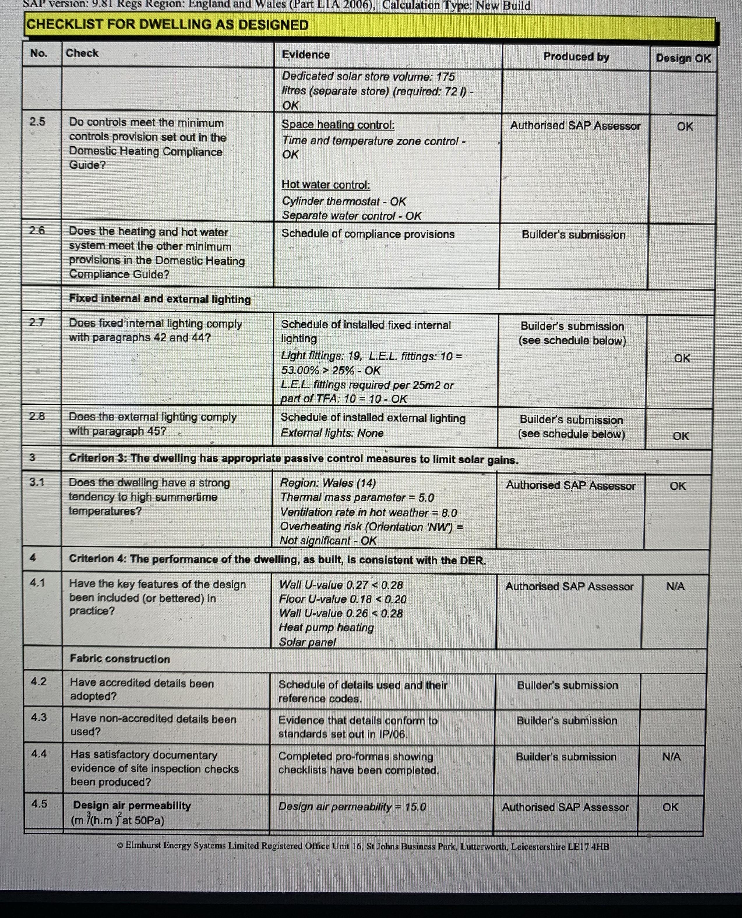

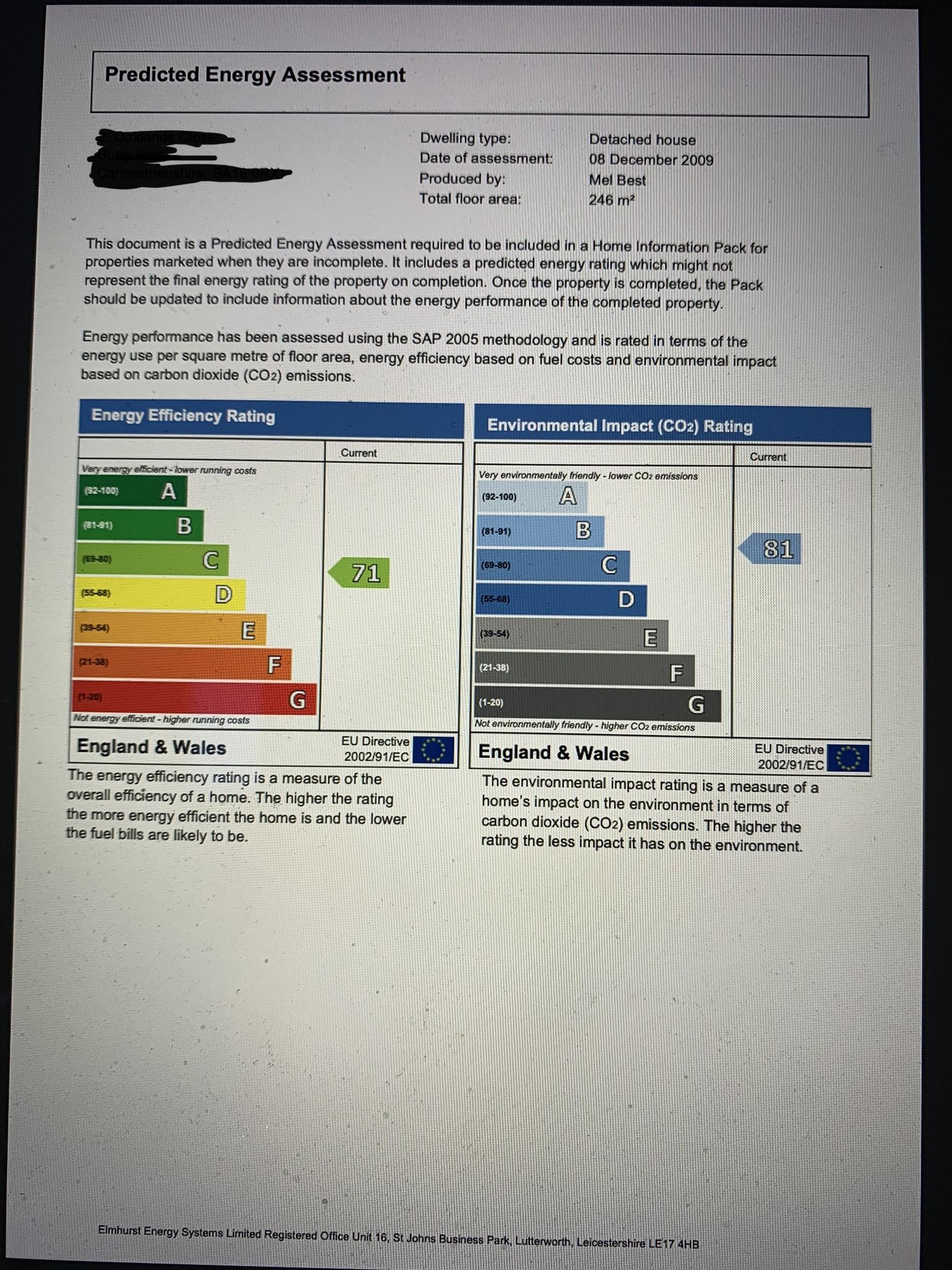

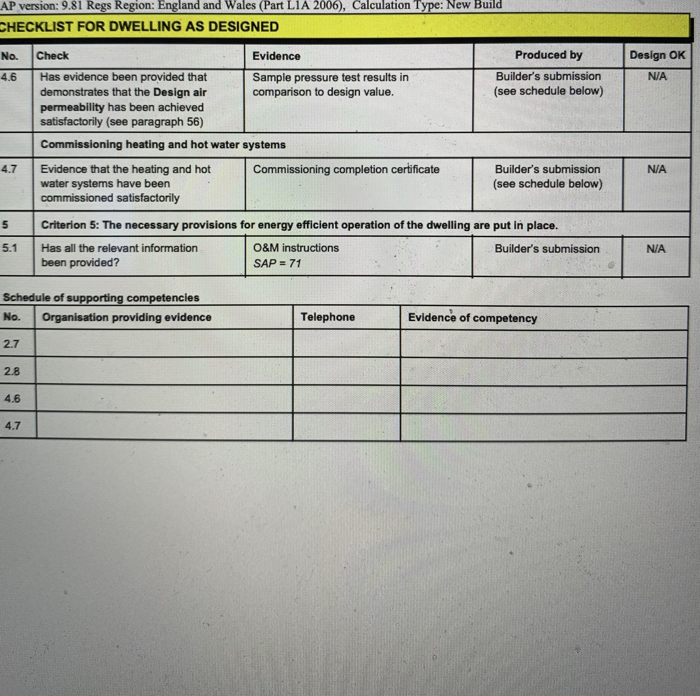

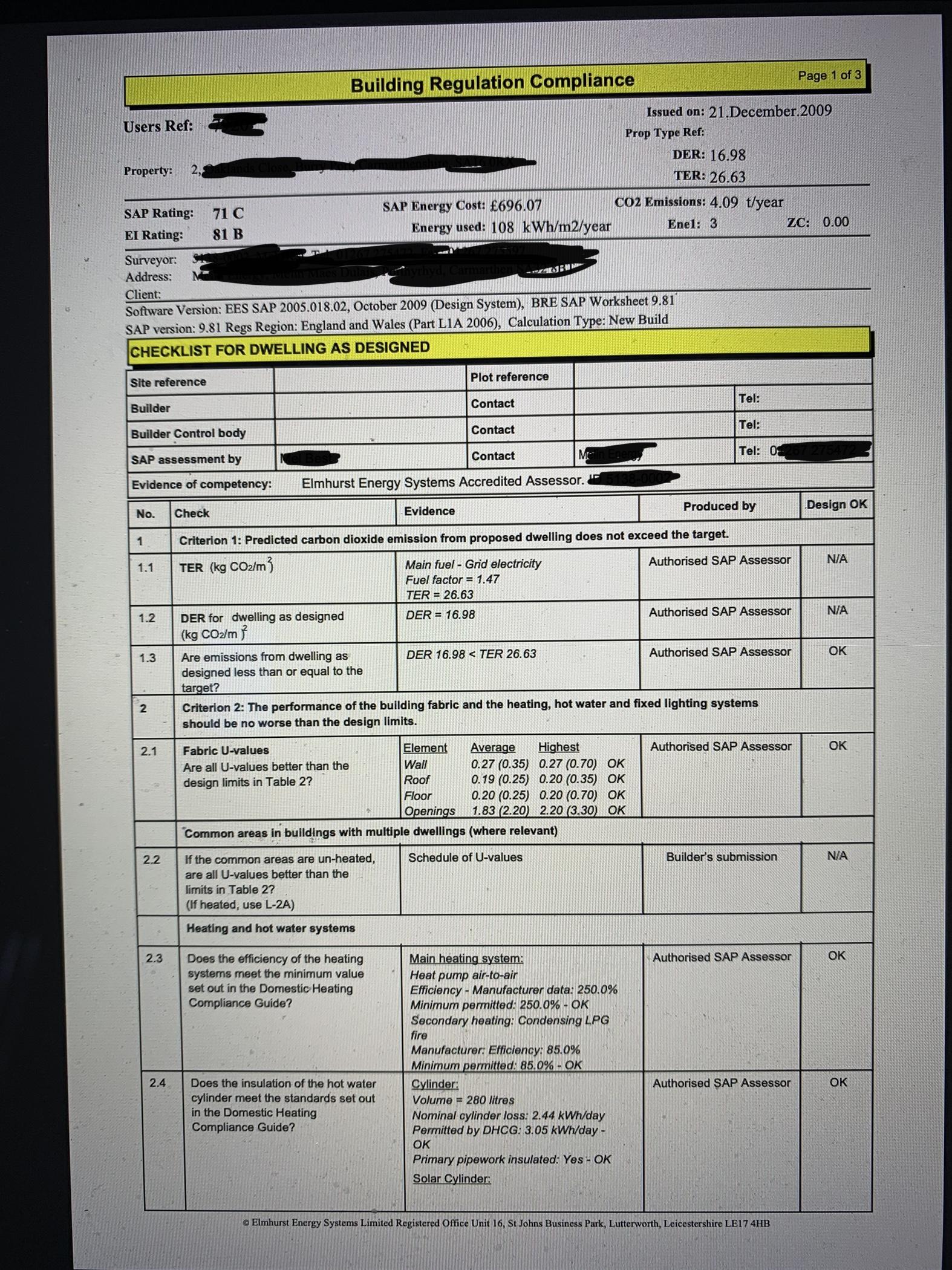

  13. Can’t understand how the rating reflects the build standard as I project managed this house together with building regs personnel and I personally rock wooled and insulated every single area inside the house. All the outside was cavity with k rendered block walls, insulation boards, thermo blocks, dry walled and skimmed. if the heat pump ever packs in, I will never replace it and go gas instead. They just can’t warm up enough in the cold so what’s the point of them really. Huge expense for a huge cost in electricity and no way is it a saver. At least gas is not affected directly by cold. Sorry, rant over
  14. @PeterW any updates on this topic? Now due to the temp drop this week, my consumption has gone to 113kw in a 24 hour period so eager to sort the weather compensation if it helps reduce. Or something else. @PeterW need your help please.
