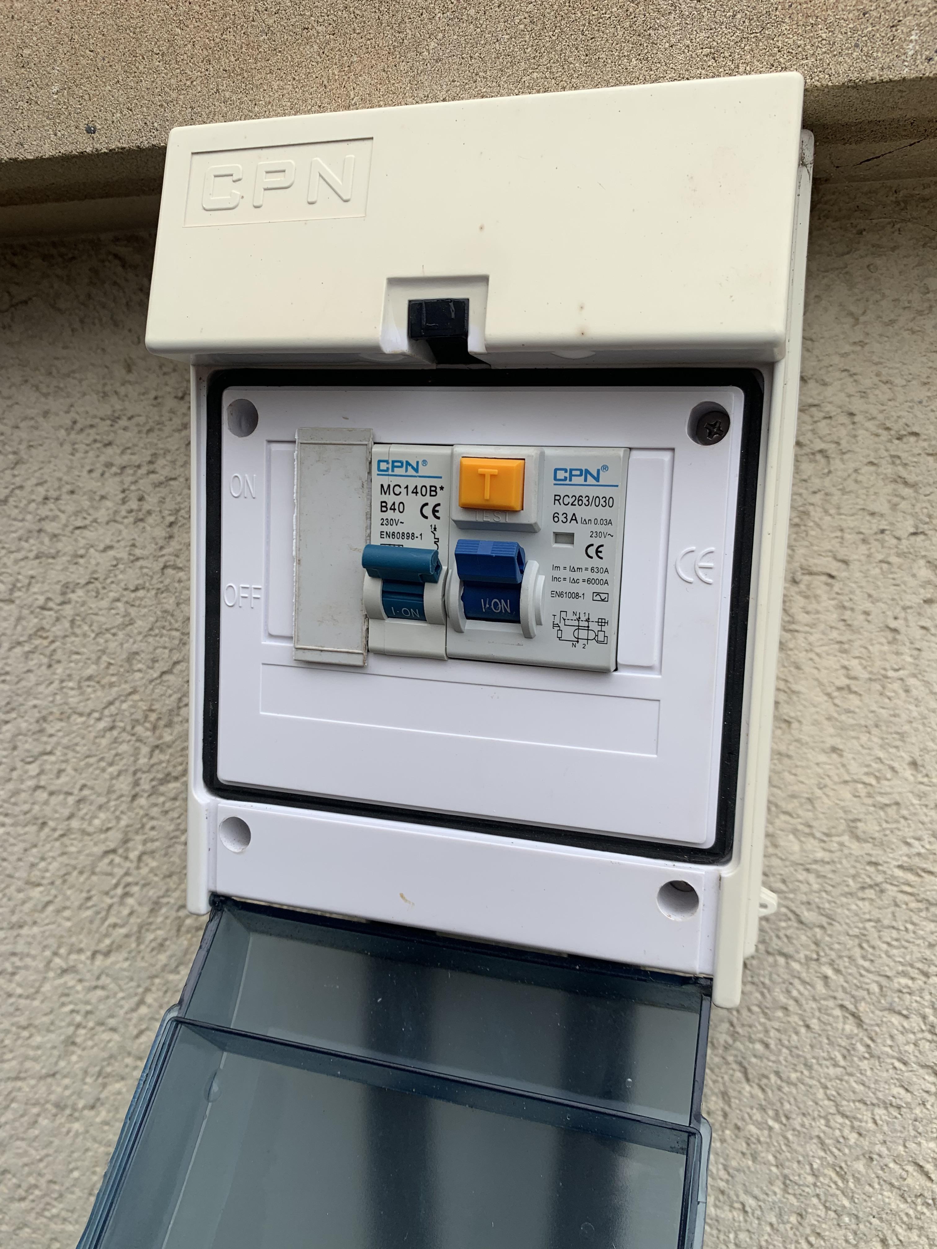

  12. Thanks. It’s running OK at the moment for no apparent reason but if it trips again that’s what I will do straight away. Many thanks.

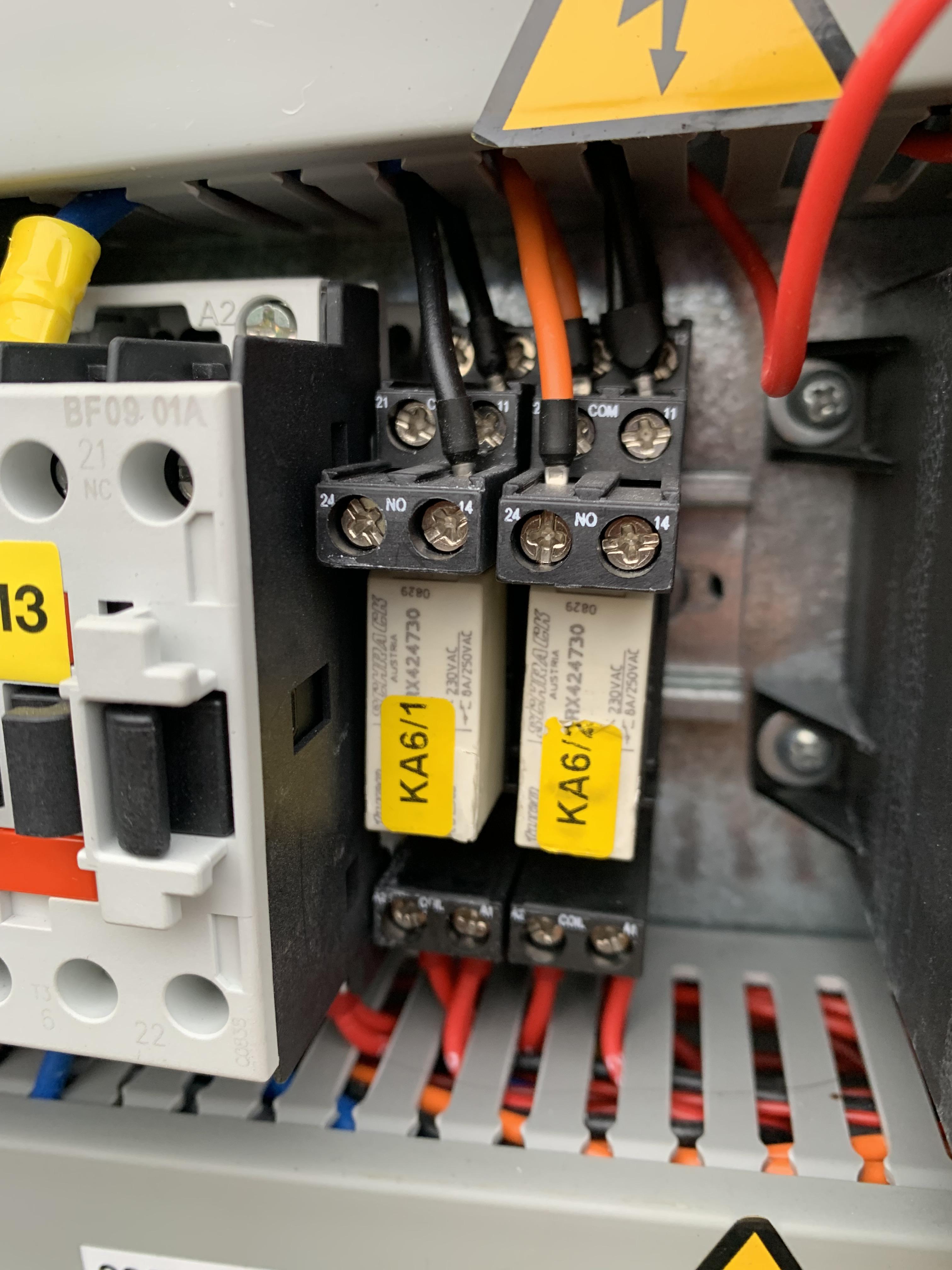

  13. Im quite certain its to do with KA6/2, as i tried a number of times taking it out and replacing it with the trip occurring when it went back in. I even took KA6/1 and put it into KA6/2 and still it tripped. The RCD had been changed to begin with, sorry if I id not mention this.
  14. Everything now working ok with the relay installed again. Just can’t understand why?

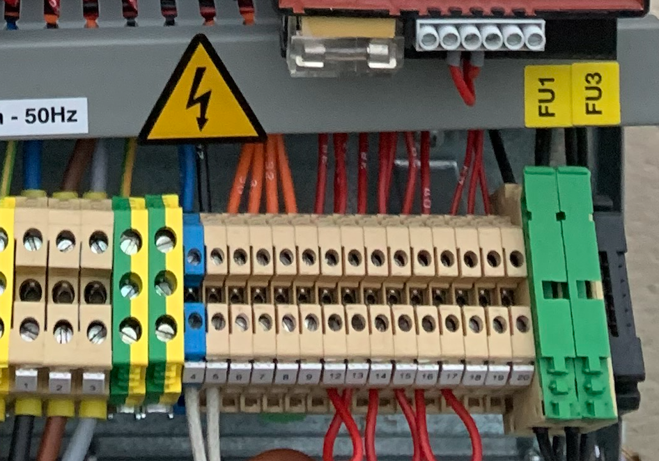

  18. Yes they are link wires, what about the x4 orange wires at the top?
  19. No I cant find the green light. Do you mean the connectors in the block 8 and 9 shown in attached? I have the KA6/2 re-fitted from this morning and is still working but maybe a fluke?

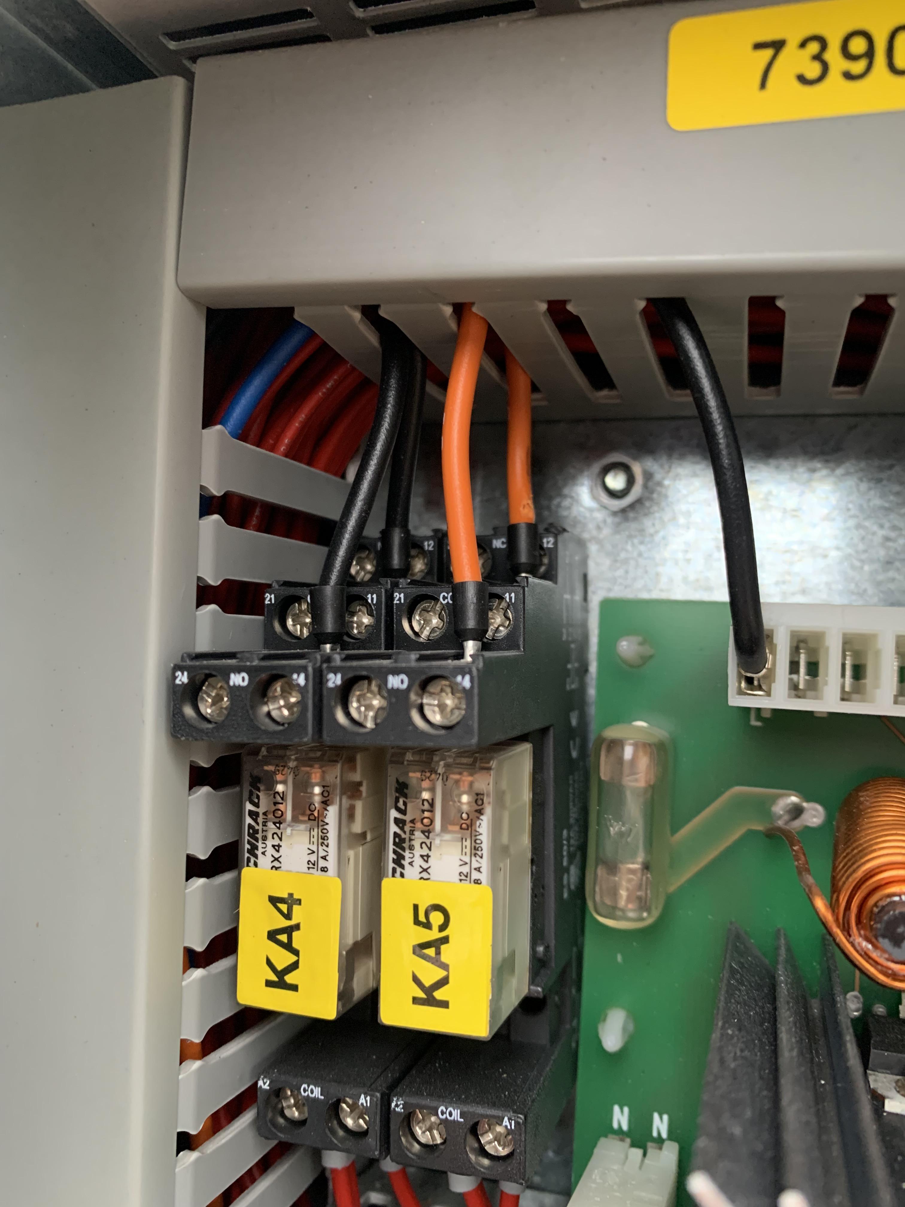

  20. Sorry I have not posted replies in a while. Removed the covers on the unit again this morning.....here is my findings: 1. To confirm.... the heater is connected to the socket labelled D, its the one I unplugged but still tripped. 2. Very difficult to find the orange wire location but on closer inspection, I do think it goes into KA5 as shown...would this be correct? There is no other orange wires on the the system. The KA5 orange wire (see pic) does have a little wear on it....maybe got damp? 3. The heater band is hot to touch on start up so seems to be working OK. 4. I have plugged KA6/2 back in this morning and it all starts up OK and does not trip...so far anyway....
