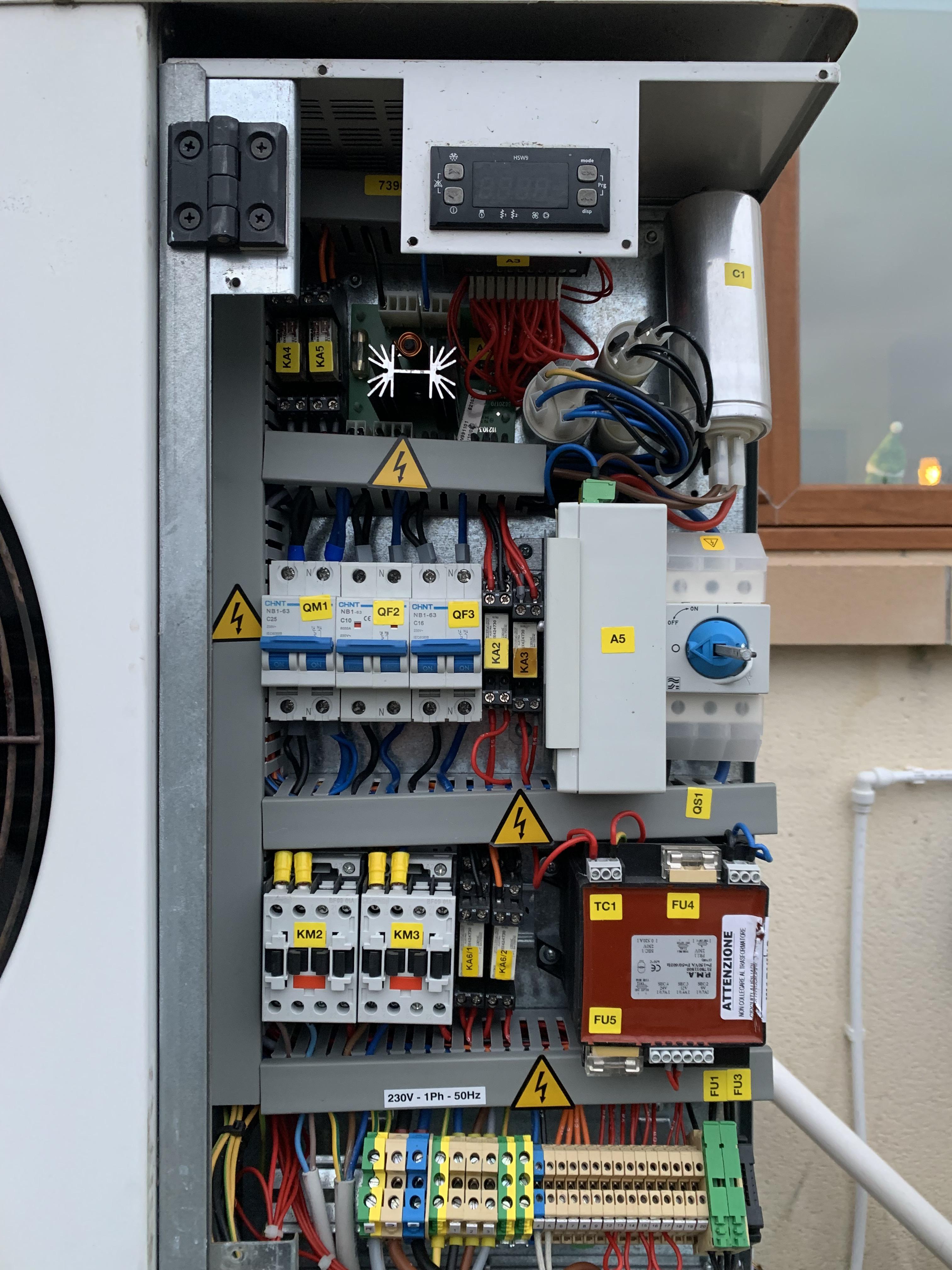

  1. Correction the compressor is warm to touch but not really hot. If that makes sense. pump has reached target temp and is ok. I’m running without the second relay. Is that ok? Otherwise it trips out.

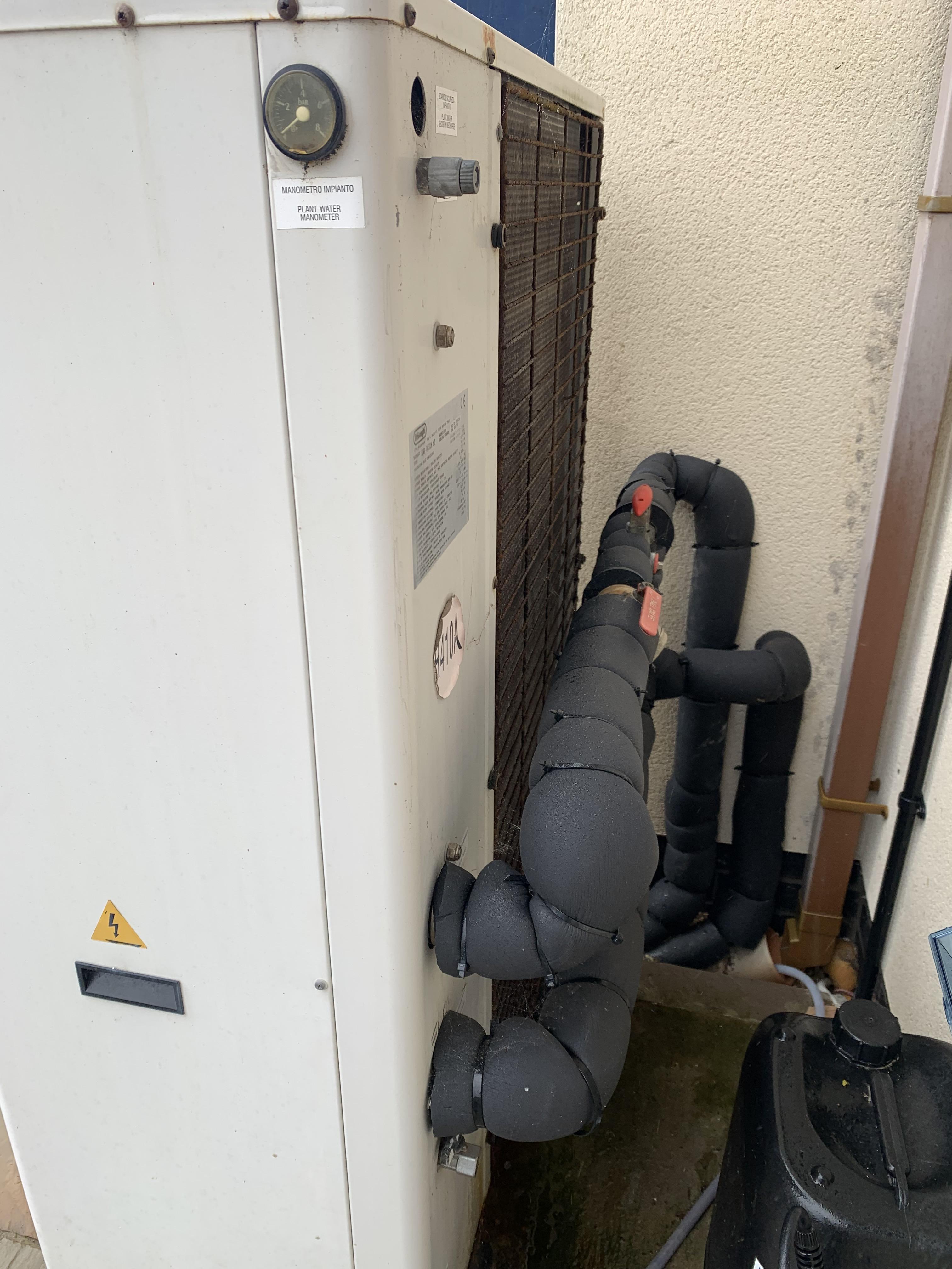

  2. I do feel heat on the pipes around it. The black unit part feels cold to touch though. No strange noises. Its the same as usual.
  3. Compressor light is activated and no strange noises. Relay 2 is removed KA6/2. Both fans running and system pump activated.
  4. Am I looking for noise from here. Is this the compressor?

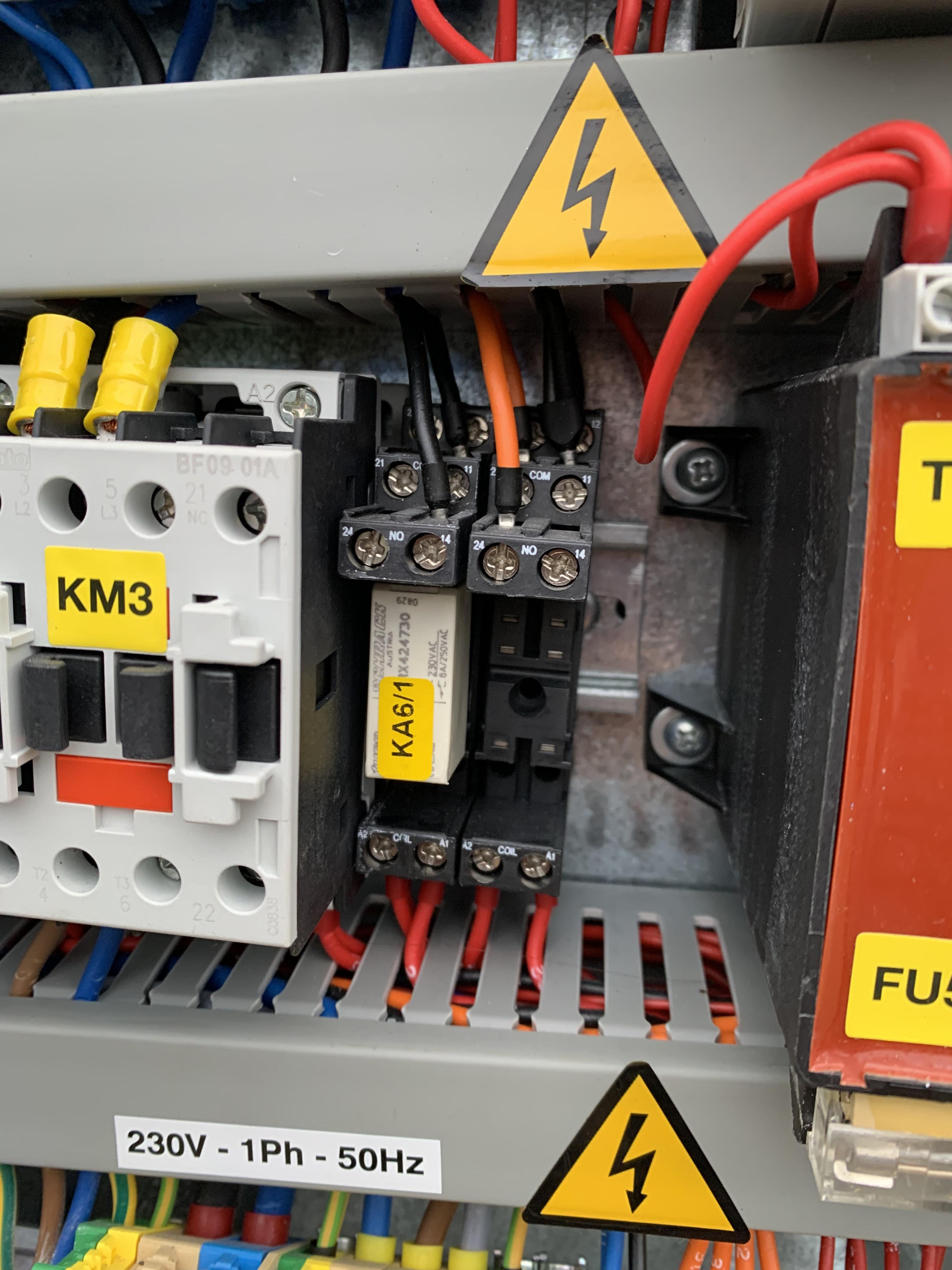

  5. No error with relay removed unit heats up ok. Is it safe to run with relay out?
  6. Do you mean the C1 Capacitor? Can’t see where the wire goes too
  7. Image shown with relay removed

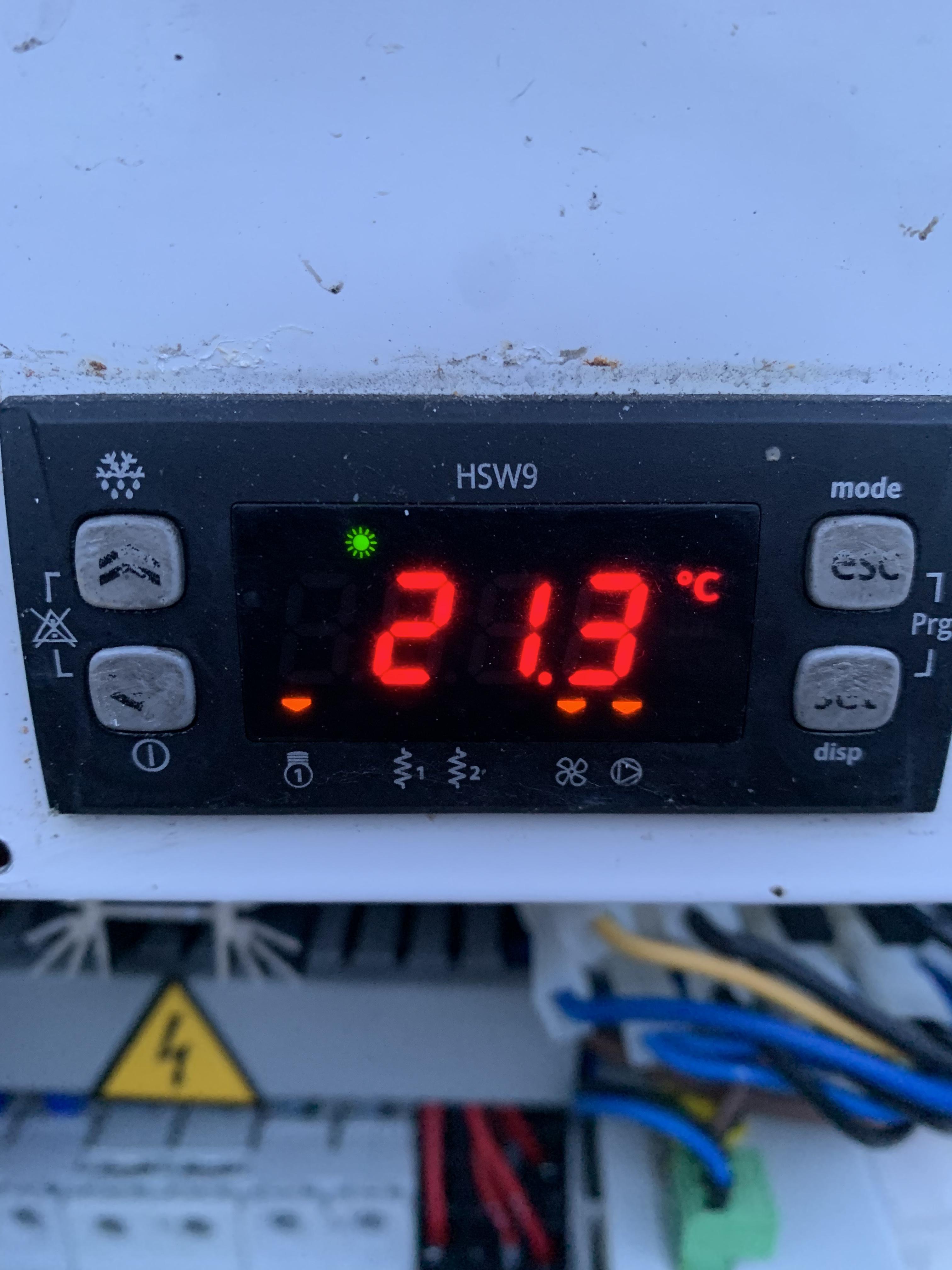

  8. Just an update, I have been switching off and removing bits this morning to isolate the issue. It seems if I remove one of the compressor enabaling relays it works fine, heats up and does not trip. I thought eureka that it was a faulty relay, so put the KA6/1 into KA6/2 and it trips immediately. So I think its compressor related. If I leave out the relay and run it, it works fine, is this advisable in the short term as the house is rather cold now?

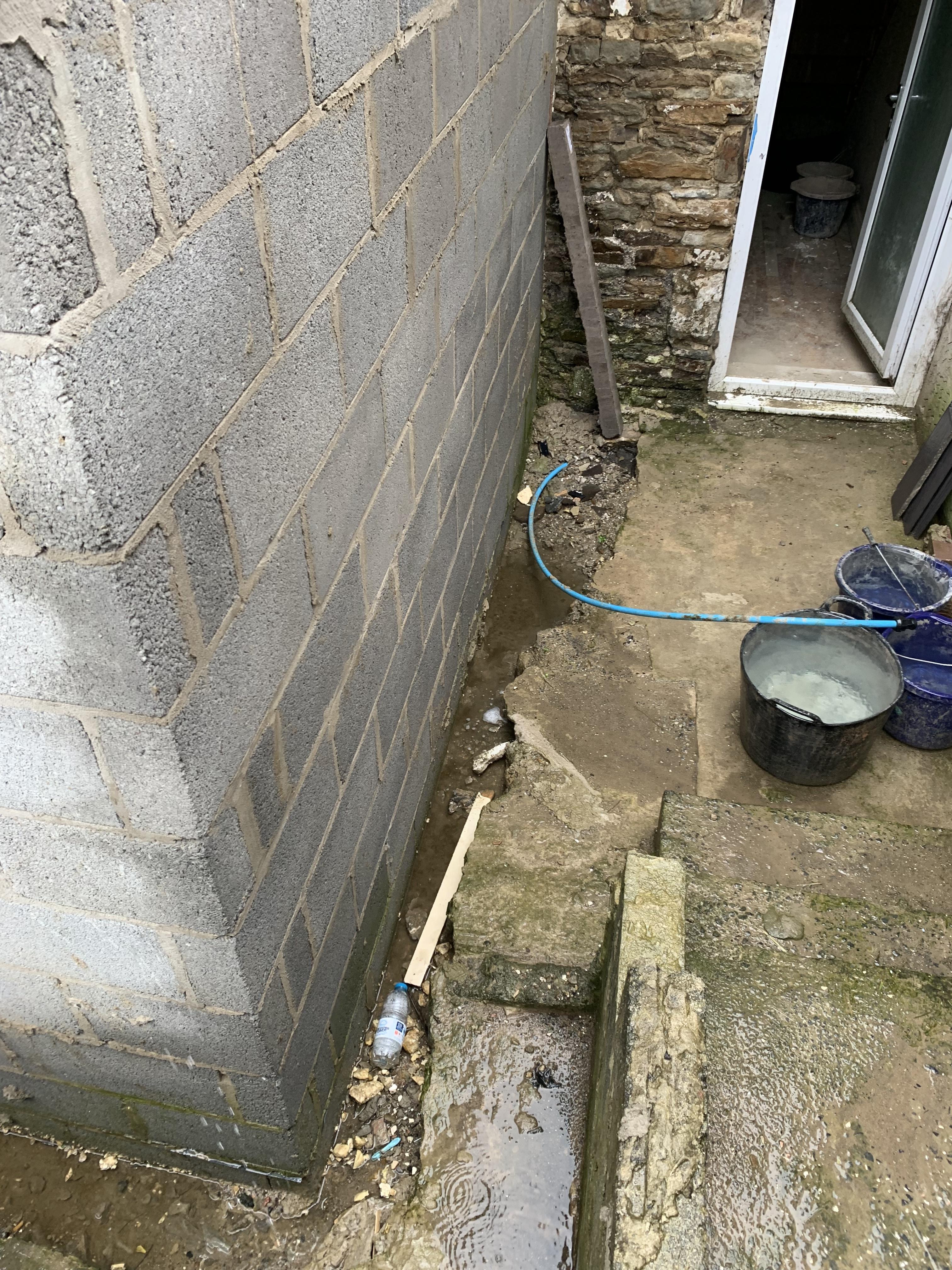

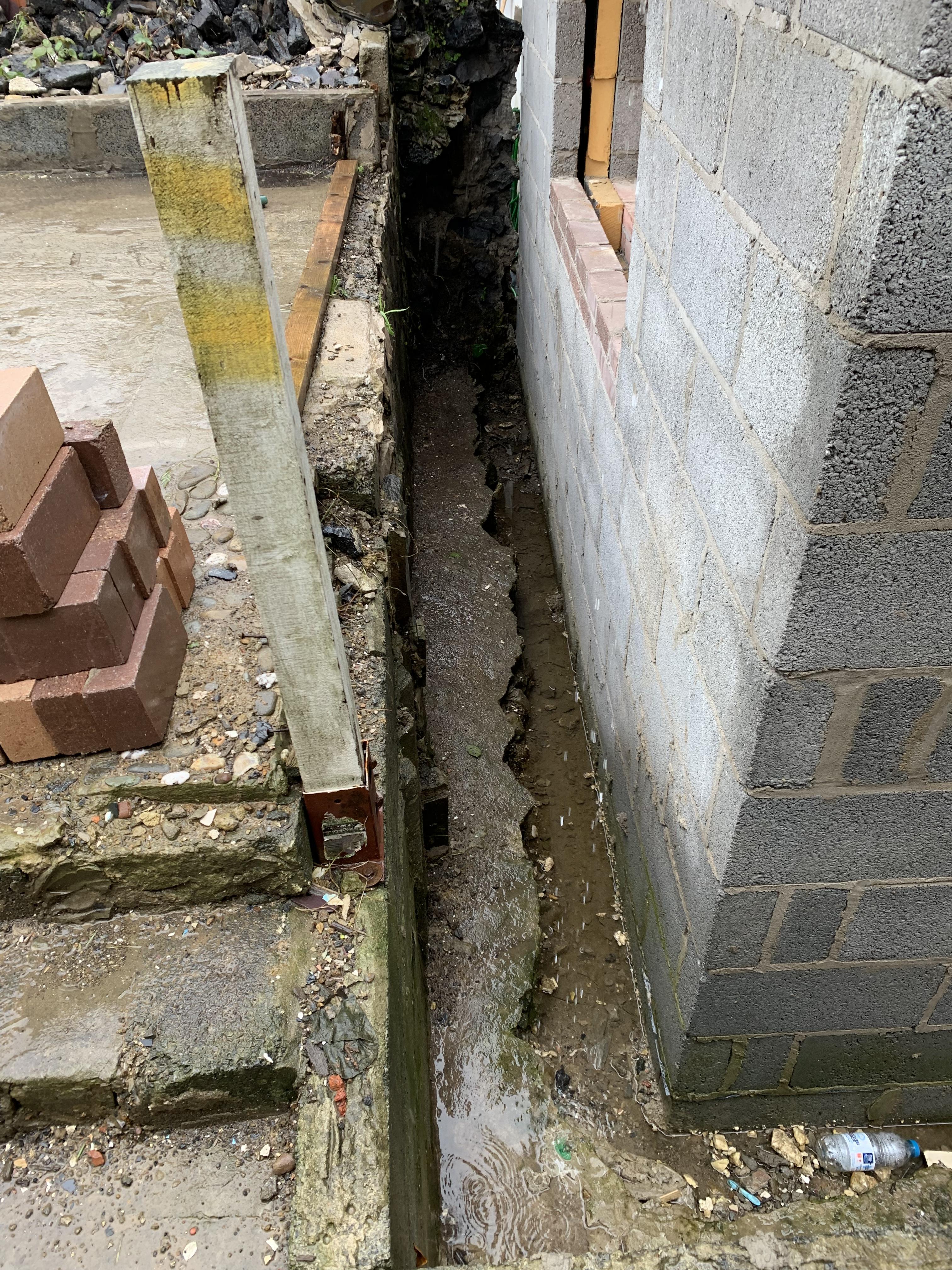

  10. So how does the pipe work into the kitchen. Are you saying drill a big hole to fit it?
  11. This is the side view where the existing pipe is.
  12. Now the extension is complete I need to extend the existing MDPE pipe and bring it up through the kitchen to connect up. My thoughts are to deepen the trench around the perimeter to 750mm, connect the existing 20mm pipe via a quick fit to more 20mm pipe. All of which I have. Question is what is the best way to bring it up to the kitchen just under the window in picture. ?

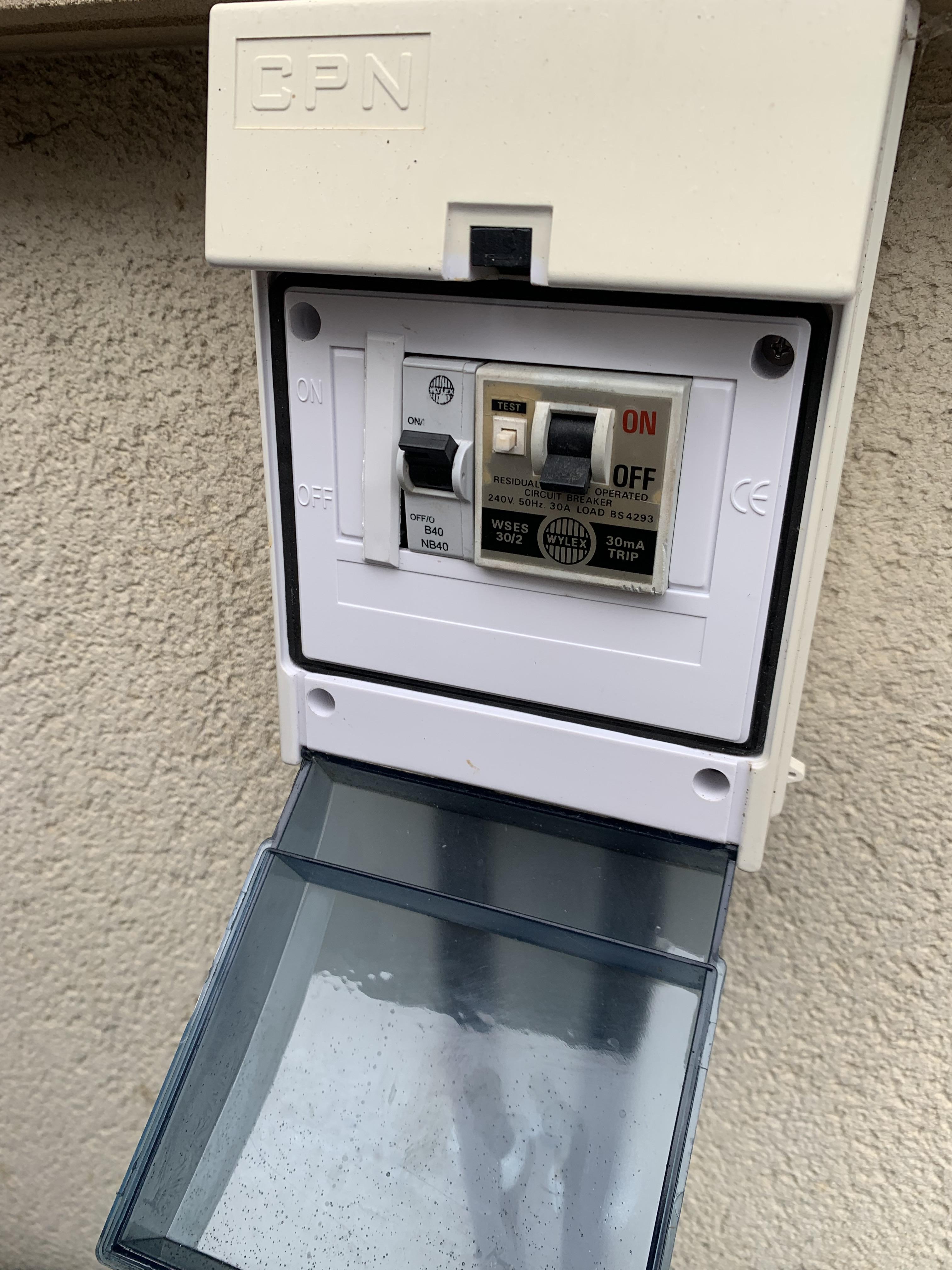

  19. Thanks guys. Seems to be all sorted. He replaced the breaker and now it’s working Ok. For now at least
  20. I have a sparky coming over now just to check the RCD over. If that all checks out where do I go from there?

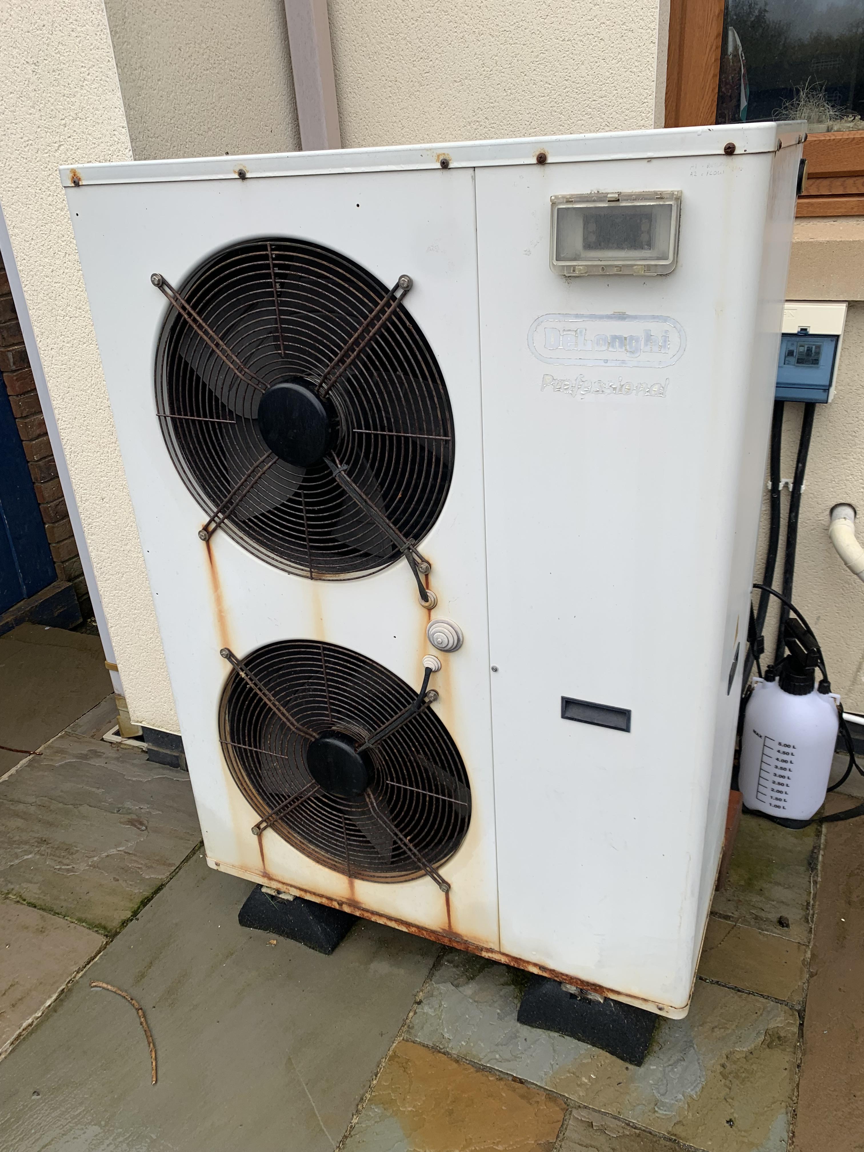

  21. My 12 year old ASHP has worked fine up until now where it has this morning tripped the electric. Despite countless times of switching it back, it goes off again. Its our only source of heat.......any ideas please.
