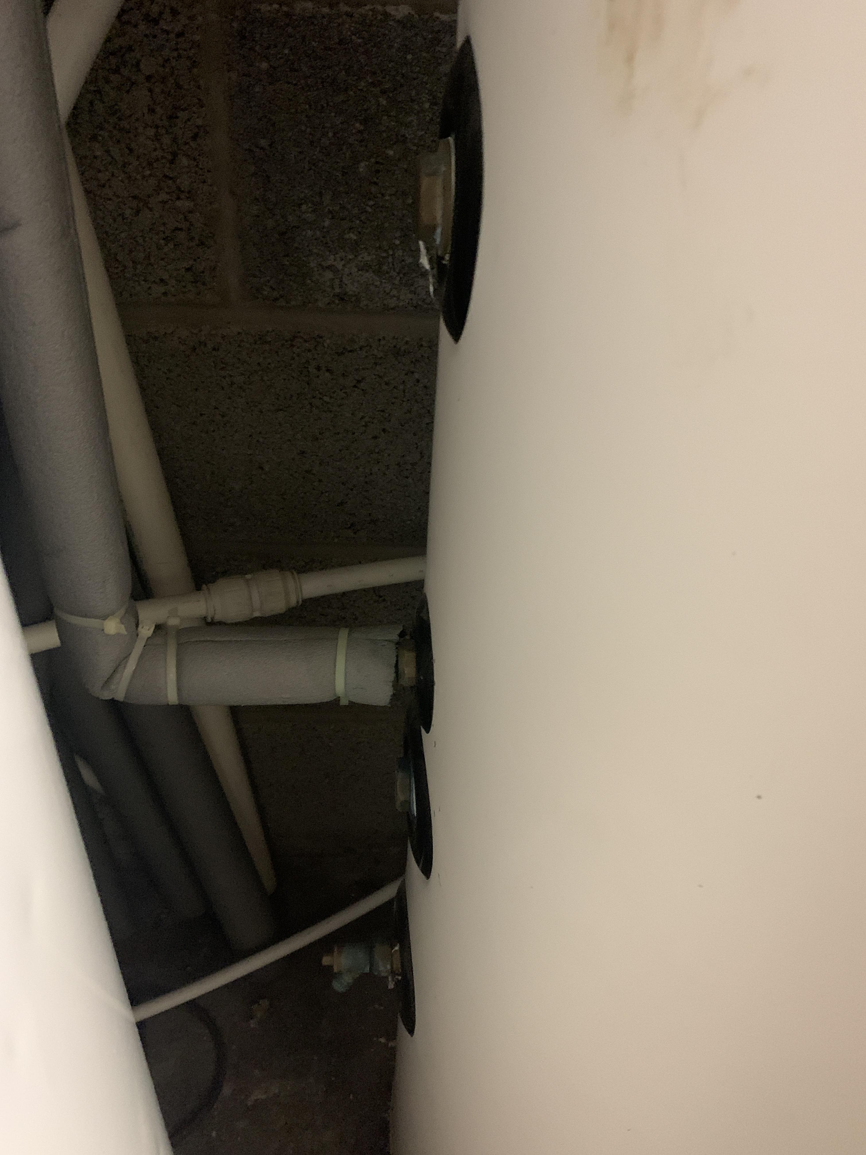

  18. There is a temp switch on the buffer return tank which I can set. It works based on the return temp to the HP. So for example it can be set to activate the pump only if the temp is 35 any lower then the grundfoss doesn’t come on. At the moment I have it switched off and the GP runs 24/7. HP runs when the return temp setting minus 3 is reached. Eg: return set to 37. Pump activates at 34. Pic shows 35 so unit is off. Timer is on 24/7 for UFH and from 6am until 12 pm for rads upstairs. Although most of the rads are off. Here’s some pics:
  19. Thanks so much for the advice guys. I was beginning to think about changing the manifold so it does the job properly. any recommended components to use, eg, manifold with flow meters on lower, wiring centre etc. I did read in the supplier manual not to change the weather switch compensation to on if the unit was south facing. See pic. None of this has been commissioned, guy went bust and I had to pick up the pieces with other people. Although we had 10 years I’ve kind of just gone along with it as never had time, working away. Now I’m deep diving into it all. Max temps at 32 would do nothing for my rads either. This morning, after reducing the return temp on the ASHP to 35 (flow 40-always plus 5) the actuators are all open (bar 1) on the UFH and HP running trying to get more heat in I guess. What if I started to reduce flows to try and force more water where needed as the hall is now up to temp. Turned up by 2 degrees now to see if I can get the UF up to temp. Bit of a trade off in my opinion. UFH room stats are set to 18.
