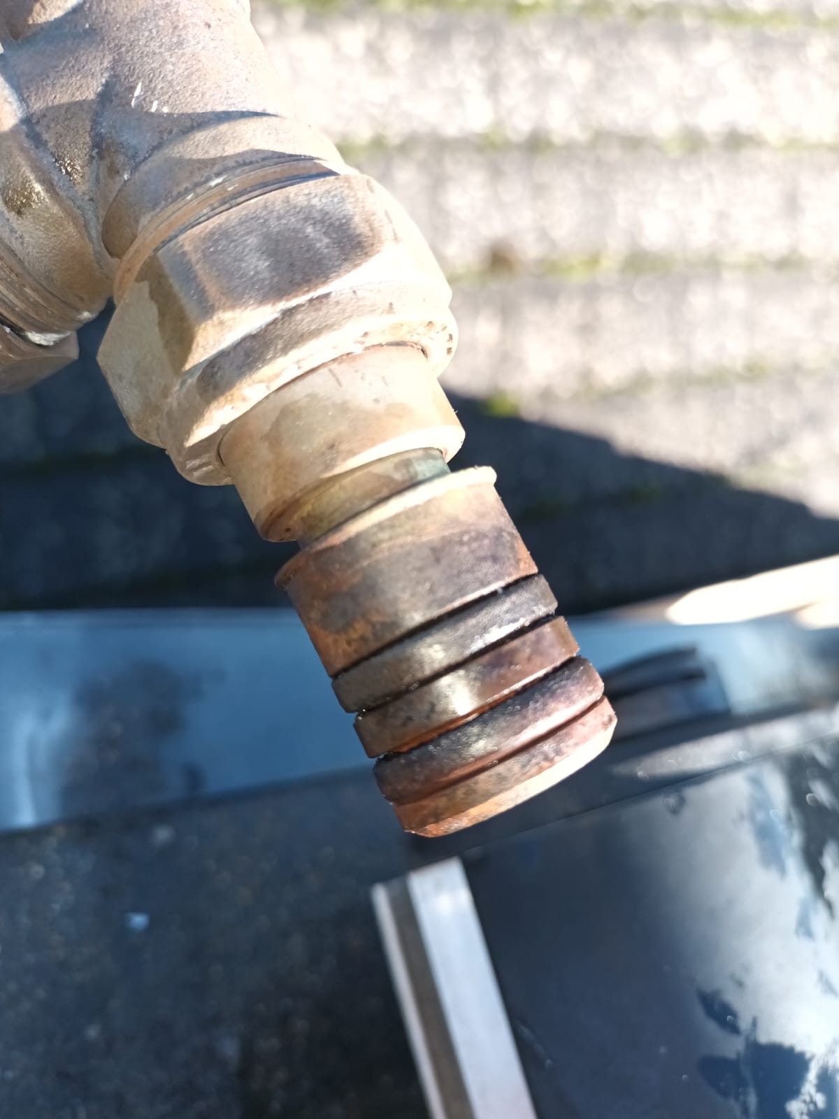

Its knowing the size thats the issue, just wish I could see a part number and description somewhere?
Thanks, the manual showed the ring as EPDM but maybe thats why its perished, ill take a look at Viton too Diolch..
We fitted an autovent today anyway to try it, but in doing so also checked the existing fittings and found a small leak (probably more of a leak under higher pressures in heat). Have taped up the joins with PTFE for now until we can source some new O rings to replace the existing. The panel is the Thermomax DF100 and you can see from the picture x2 rings that have perished, I believe they are EPDM but would be grateful if anyone knew where I could get spares. Going to change the opposite side too while we are there.

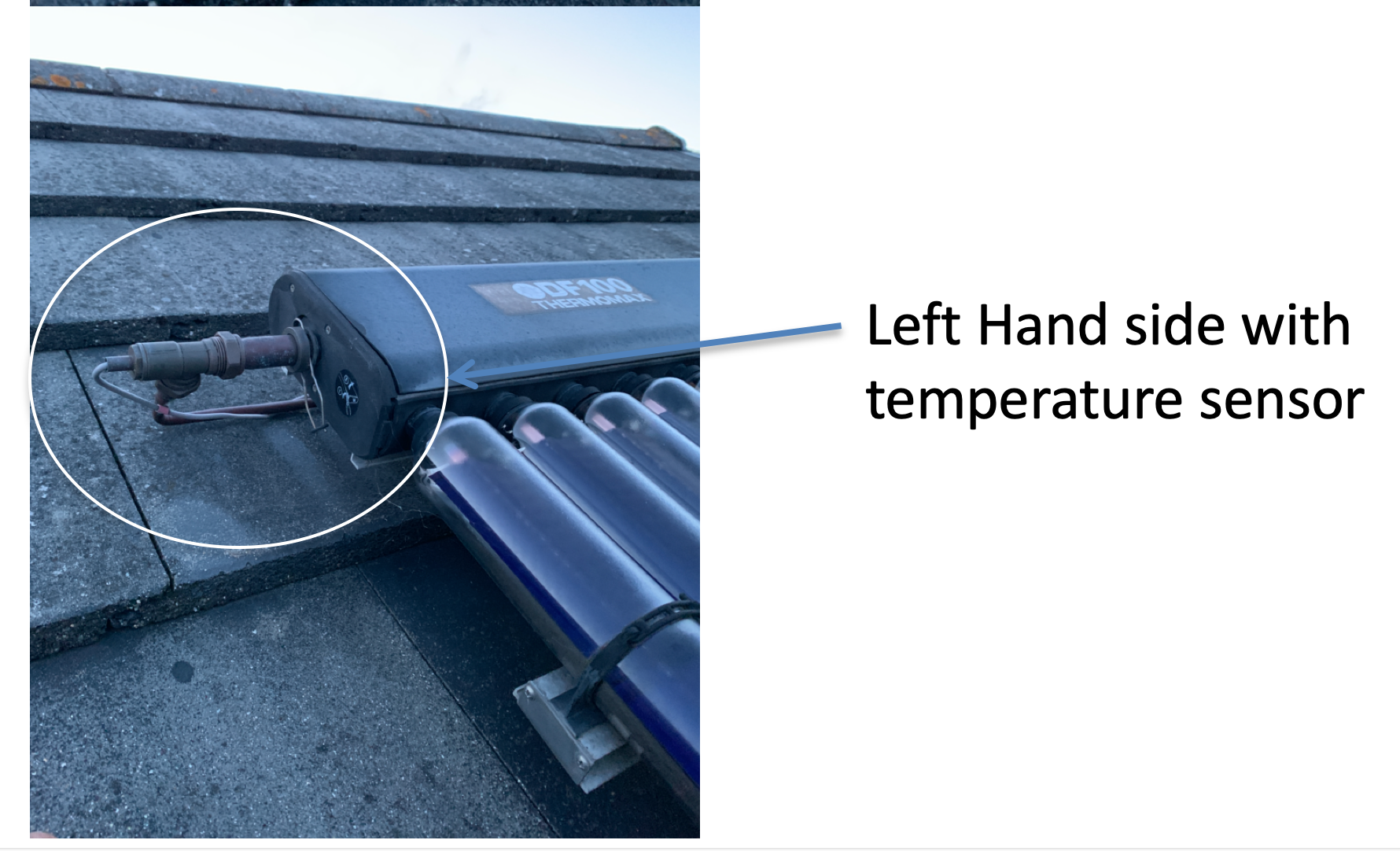

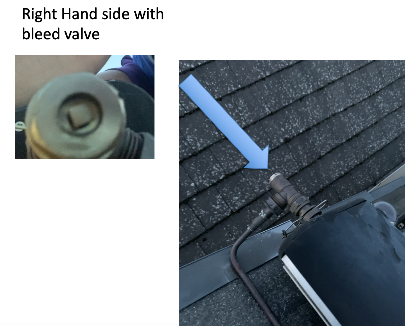

I have recently had my solar system upgraded with a pump station and new pipe work (as much as possible) but not the actual roof tubes or components. I now seem to be getting a lot of air in the system and thus the pump not being able to run when its warm on the roof. It runs fine but there is no circulation. I have bled at the solar station a number of times but does nothing. The old system had an auto vent near the tank but the new one does not. Should I have one installed to cure this? Pics attached of the roof images only (they are now lagged!)
