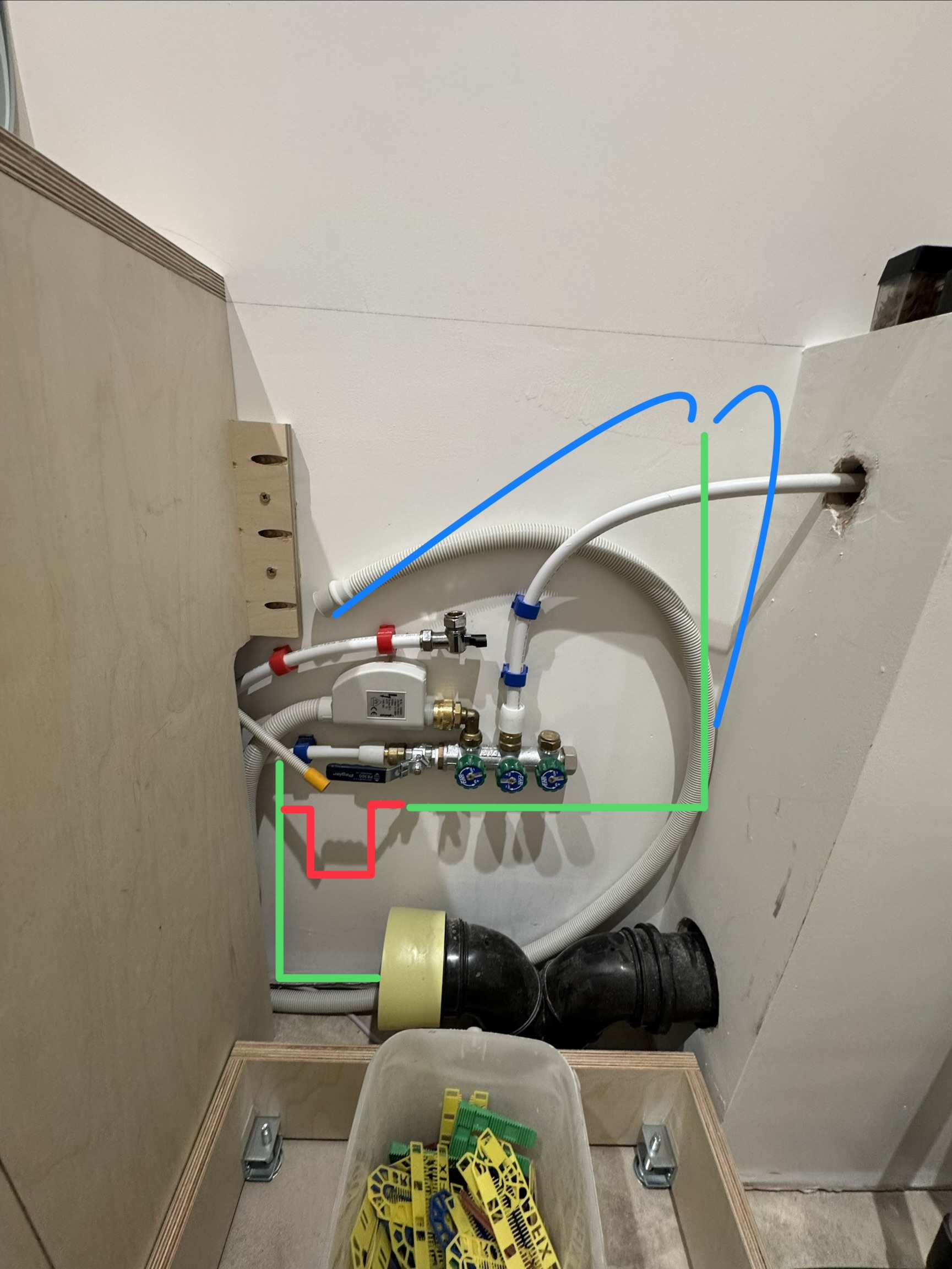

  2. Noted. The gurgle we experience currently with our existing set up in the kitchen which is using the same paperwork as was here before we bought the house. this is a sealed spigot under the sink attached to the sink waste and the noise comes through the strainer. i was hoping the air break in the top of these spigots would prevent that along with using a seperate standpipe. thanks for your help on this!

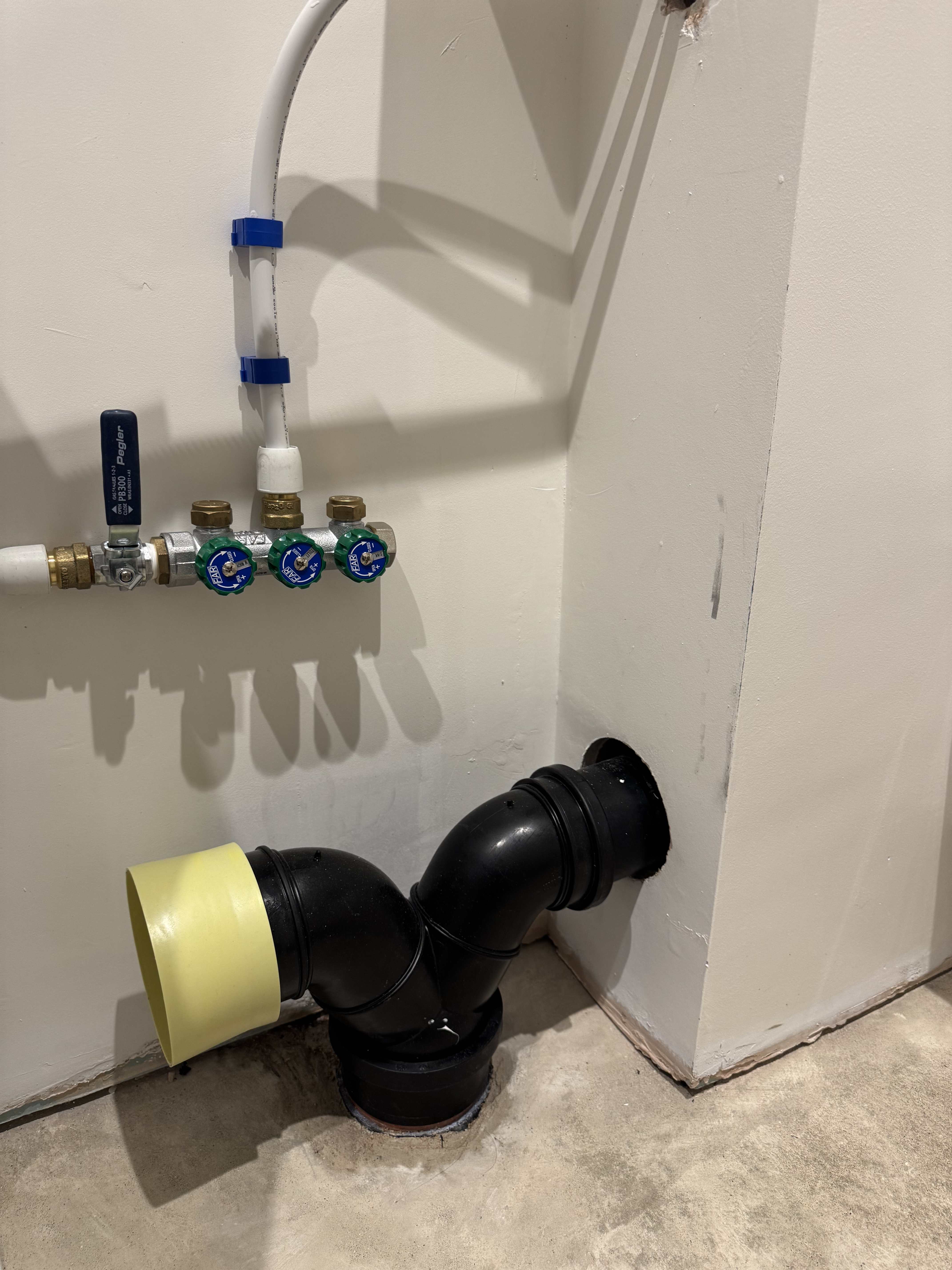

  3. that black connector is for the toilet waste as well. From the ground is the 110mm pipe to the sewer. The black connector is 110mm to 90mm. The geberit pipe out of the toilet is 90mm as standard. I've already had on order a reducer to 40mm, elbow and tee piece and this is being delivered on Monday, to come off from the yellow bung. if 300mm is enough then I have a dual appliance spigot already here? https://www.screwfix.com/p/mcalpine-twin-hose-connector-40mm/206hr use this instead of tbh y branch?
  4. Thanks. i should have mentioned I need a sink waste here as well. so where the I tee'd off for the running trap, I was going to run the sink waste to there. i'll measure up where you've drawn but off the top of my head that's probably about 300mm from the appliance spigot to the p trap. would that be enough overall length of pipe?
  5. Green line path of 40mm pipe. red line possibly a running trap. blue lines the drain hose from WM & TD. everything unfortunately a lot tighter then I'd hope for due to the change from stacking to side by side.
  6. Originally intended to stack washing machine and dryer so had plenty of on wall to tee off to sink and a standpipe for WM & TD. This would have allowed a 700-800mm pipe including trap. However now the time has come to install, decision has been made to fit the appliances side by side. This has reduced the available space and now a seperate standpipe cannot be fitted. I've read the reason standpipe are around 700-800mm, is due to discharge rate and allow drainage should the rate be slowed down for whatever reason. If this is the case would it be ok to get that overall length of pipe, however have it at a 90° bend? Maybe use a swept bend rather then a tight 90°?

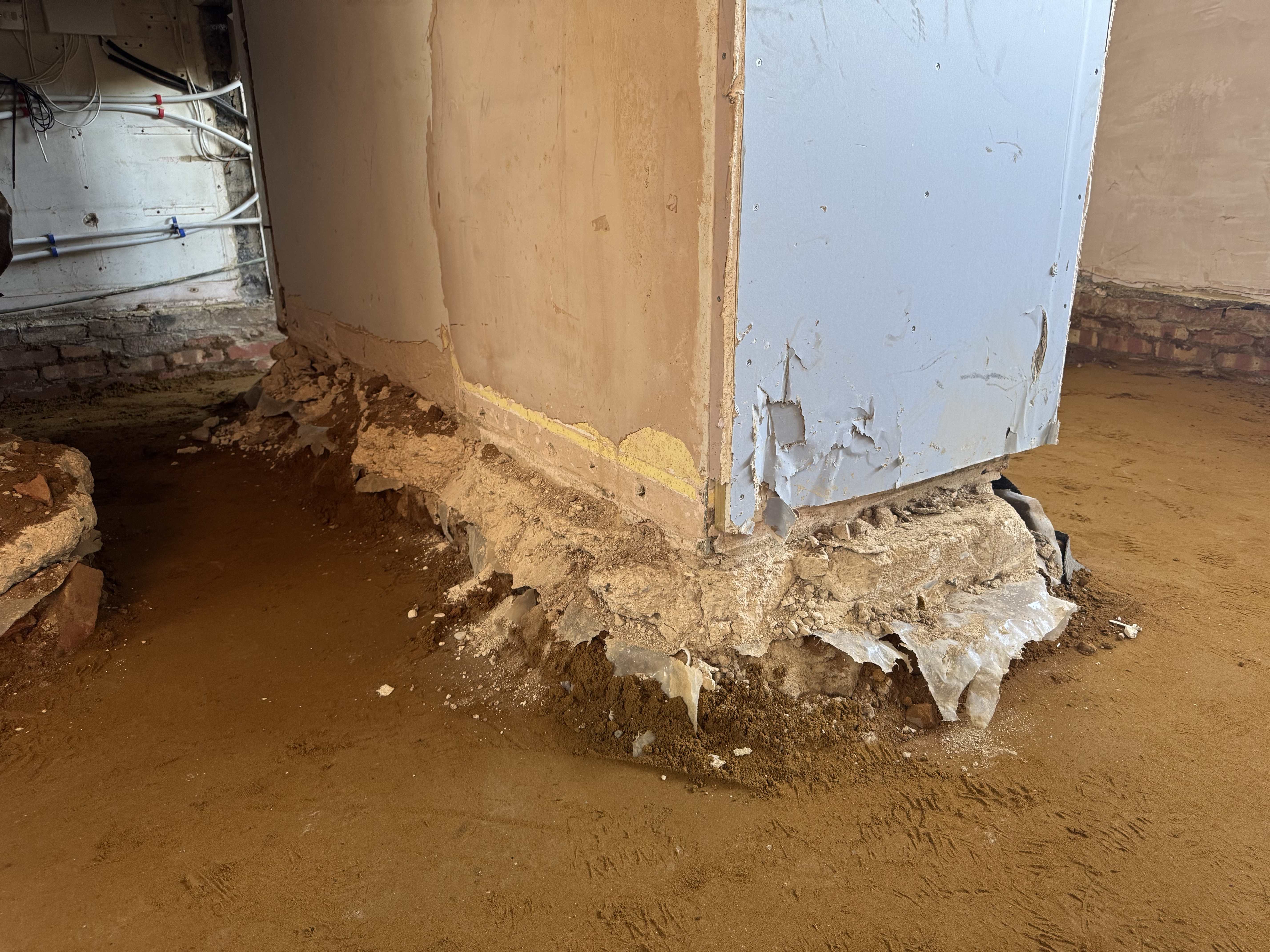

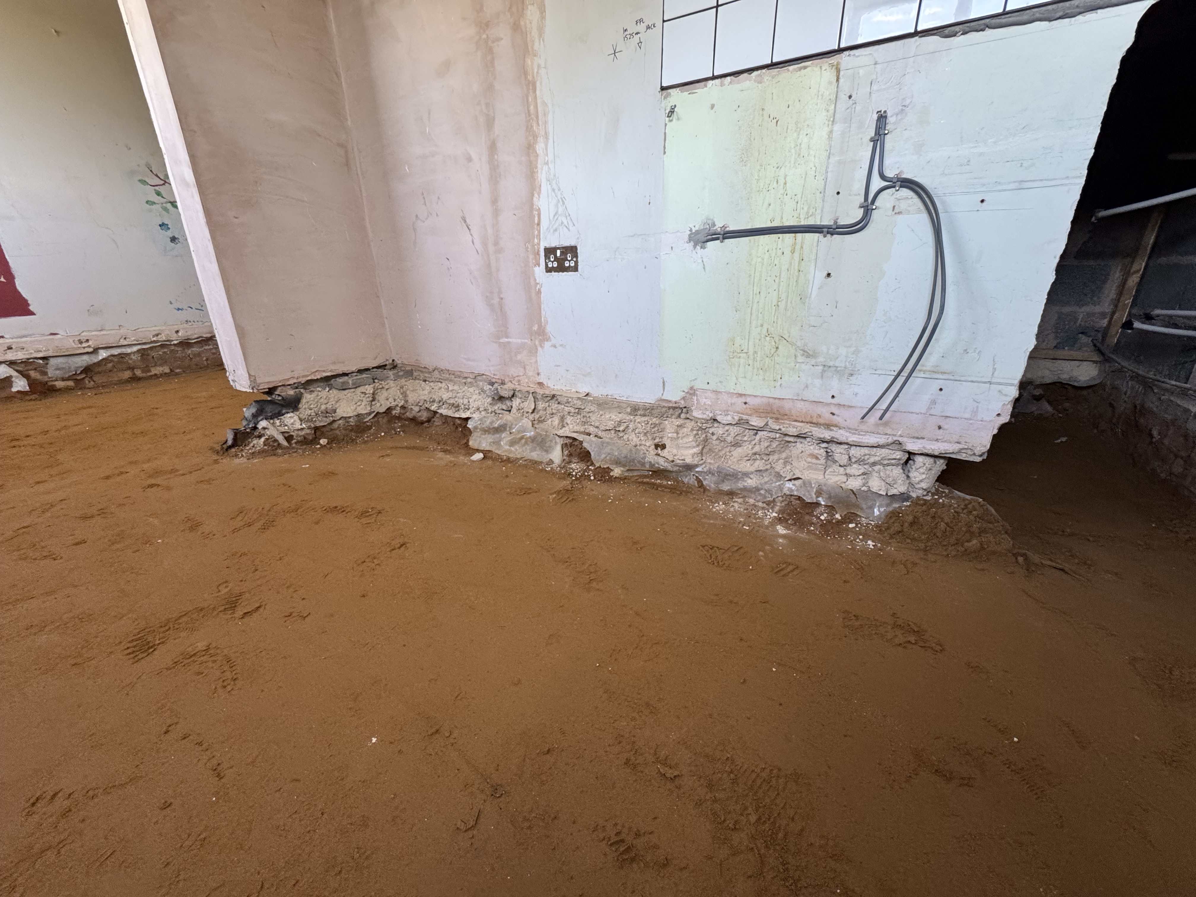

  17. Hi Nick, which section to you mean? that particular L shape wall has the kitchen on one side, and top half of the staircase after the 1/2 landing. i've cleared the hardcore and dug done to hit clay. Can tamp that firm and place scaffold board under the prop.
  18. So SE came round today and due to the state of the concrete slab under the wall it needs to be supported, remove concrete and whatever is under, and dig a footing. due to access on one side I'm hoping to use strongboys at around 800mm spacings off size 0 acrows. I asked a builder mate of mine who said strongboys can move a bit if not a solid wall above. but all the literature for strongboys says there fine for single storey walls. anyone here had any experience of using them with single storey walls?
  19. It's a single storey block wall and the long part I believe has been created for the staircase stringers to fix into. The short section has a small RSJ coming off it to the external wall. Looks like this is to provide support for the timber joists. Above both sections, is a simple stud wall diving the bathroom/landing and bathroom/bedroom. Got 200mm PIR going on top of the sand.
  20. In the build up to having a new structural slab installed the existing slab has had to be broken up. The groundsworkers have gone to town with the use of their breaker and created a bit of a mess here on a single storey block wall. Had my builder round today who wasn't impressed at all, but whilst I wait for the structural engineer to visit (hopefully tomorrow) I was looking for advice if anyone has in order to rectify. 1 suggestion me and the builder made today was put needles through at intervals, and prop using mini acrows. Most likely need to create a solid foundation for the acrows. Then remove all the earth and old slab, before digging a new footing underneath and building up with bricks/blocks for this wall to sit on. Any other suggestions welcome whilst I sit and worry a bit about this stage!
