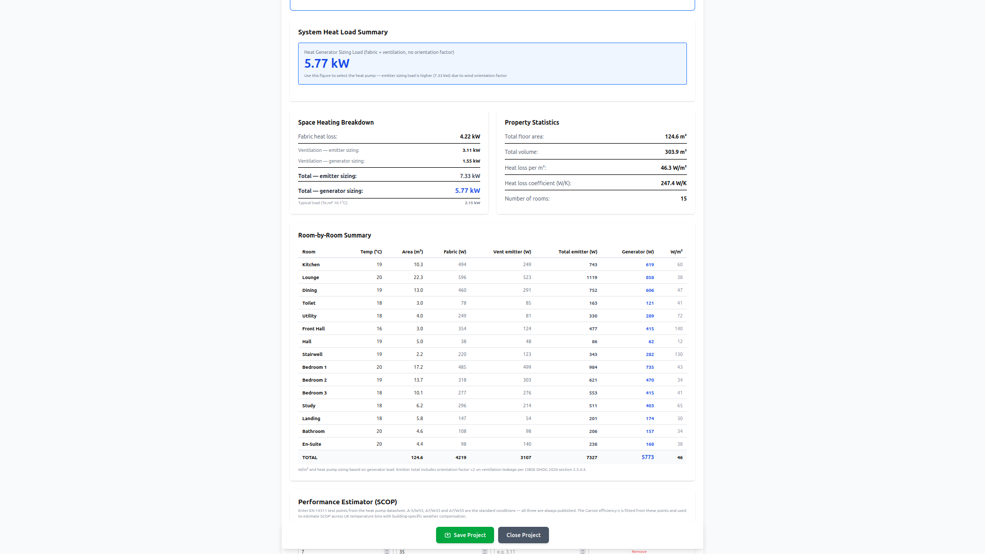

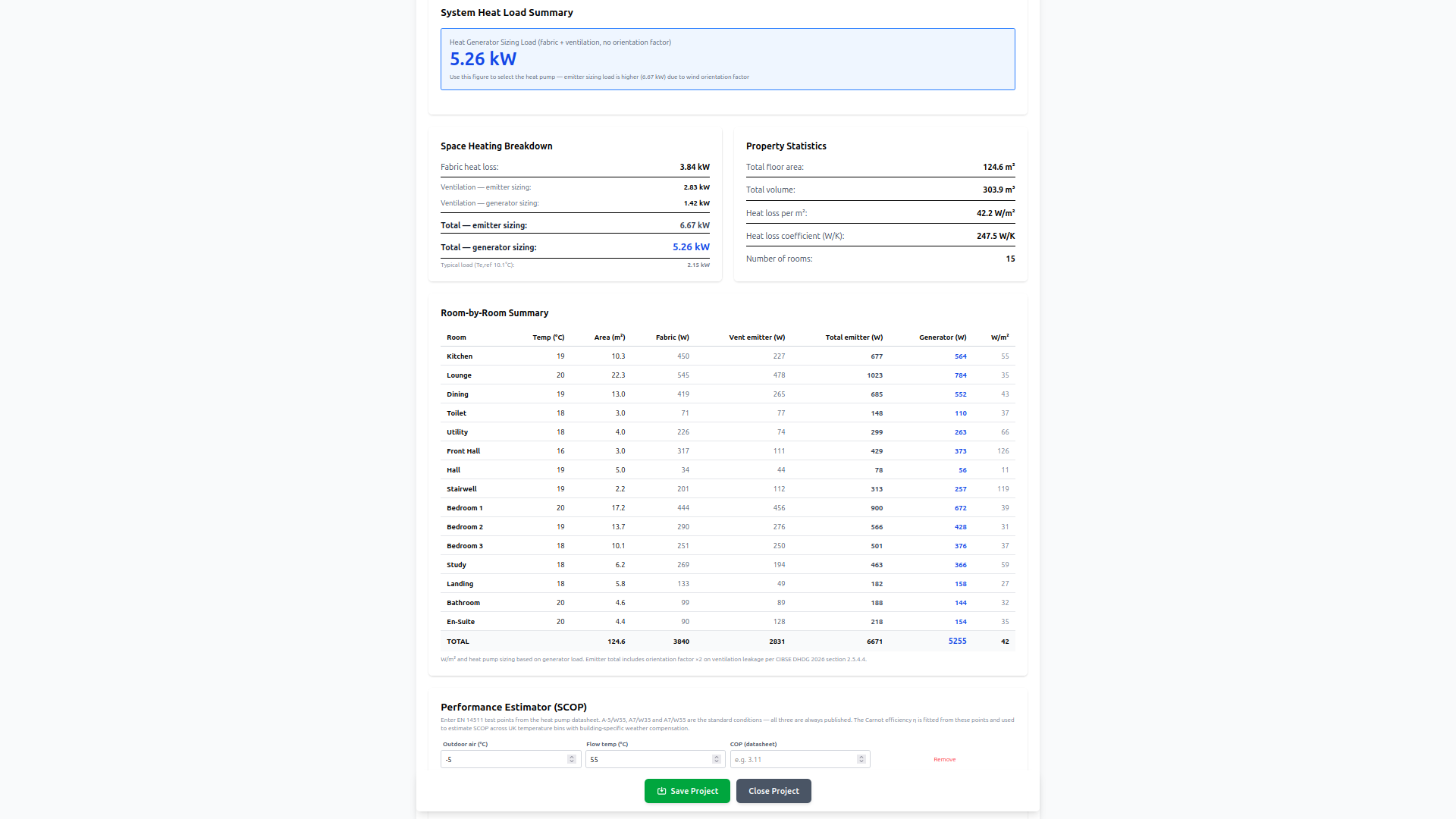

  6. Here you go. This is a lot better. Not quite there yet, but about 1/2 of what you were seeing, but as you can see the calculated fabric losses of 4.22kW are much closer to yours, but this is at -4.6 which is the conservative MCS post code lookup: In the rooms editor, there is a column labelled Design dt (C). When you add a new element, it default to the Design dT of room temp - outdoor design temp. Then next to it is another column for ref dT which is the default delta T between room temp and Typical Outdoor temp. For all internal elements this needs to be set to the difference between internal rooms, or 0 if there is none. I've just gone and updated all your internal settings to this, which has made the difference. I may have incorrectly amended some of your insulated ceiling which may be external? I've then gone and change the outdoor design temp from -4.6 to -2.5 and as you can see, the fabric loss is now down to 3.84kW and generator sizing is 5.26kW: The total emitter sizing is quite large compared to what you're experiencing with your low flow temps etc. which means I need to dig into the calculations to make sure I haven't got something wrong in there, but I suspect that because of the way it has been implemented, there's been a cautious approach taken by CIBSE in how they've implemented the new method. It wouldn't surprise me and is actually a good thing as it's better to upsize rads for worst case scenarion and reap the benefits of lower flow temps over the long term. But I will need to check. I'd also recommend you go over your element inputs just to check the assignment of U-values from your U-value library and some didn't quite match. Hope that helps?
  7. 14.83kW emitter sizing load? That seems massive. Something doesn't seem right there. Do want to show some of the room inputs? Or PM me screenshots?
  8. No, not stupid at all, just something you need to get your head round for heat loss calcs. In the 2 story: - Ground floor gets 1 x Ground Floor (Slab) or (Suspended) + Ceiling - 1st Floor get 1 x Floor + Ceiling You're not really double counting because if both rooms have the same design internal temp, the Design dT is set to zero on both the ceiling of ground floor and floor of 1st floor so there are no losses between them. If there is a difference in internal temp, you just need to keep in mind that the Design dT becomes either + or - the difference. So if one room is 21C and the other 18C, it's +/-3 either way on floor & ceiling. You'll not know this now because the standard U-values aren't in the global database yet, but one thing to keep in mind is that the floor always has a lower U-value than the Ceiling for the same buildup - The CIBSE standard for plasterboard, joists, floorboards, with 100mm insulation is 0.32 I think. The same buildup as a floor is 0.25. Hope that clarifies it?

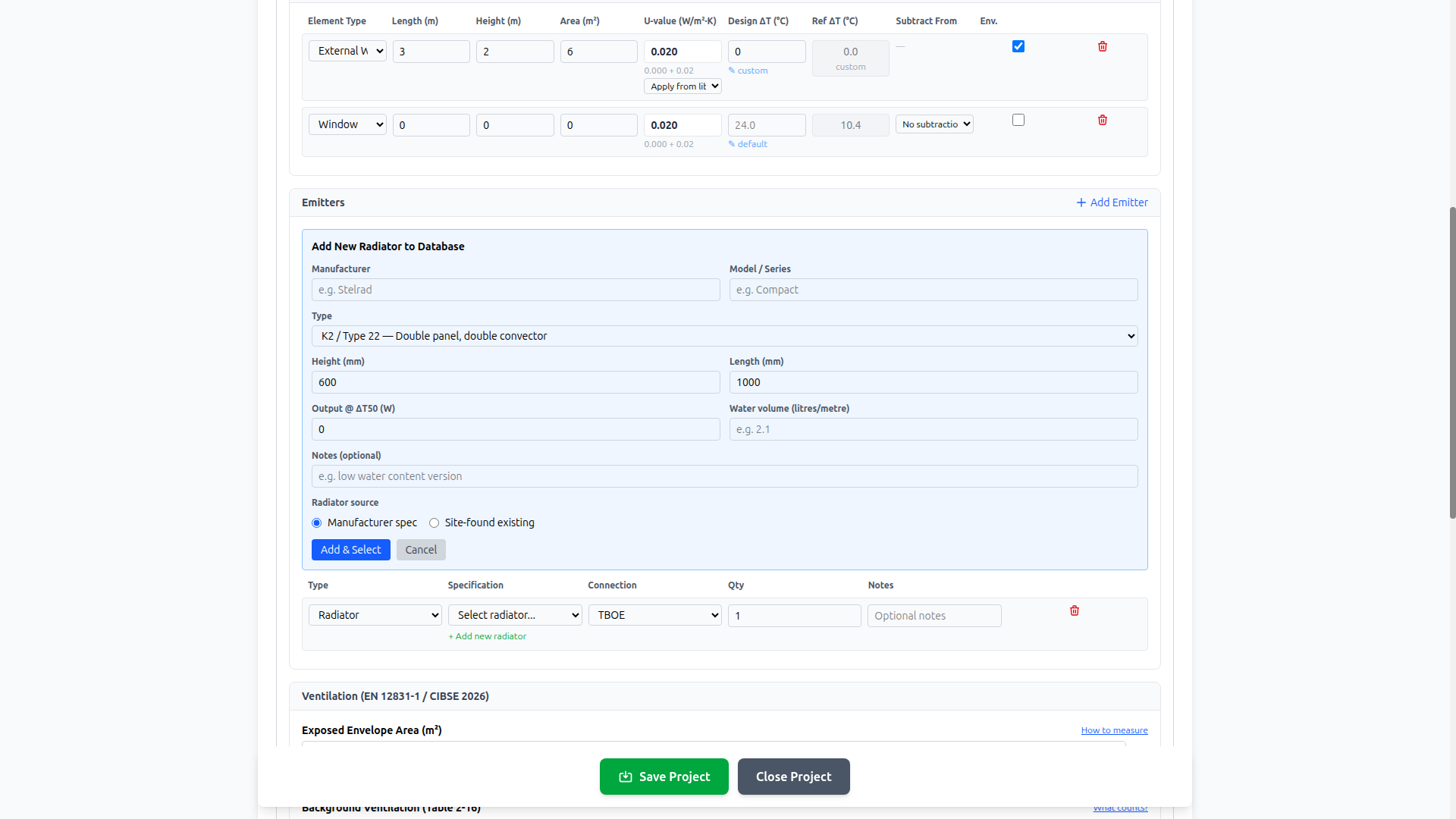

  12. Hmm interesting. The card you should be seeing looks like this: I wonder whether you have the older version of the app from before I sorted the radiator saving issue locally. Can you close your browser and/or do a hard refresh? On both my browsers - Chromium and Firefox, decimal entry in the form I have is fine from keyboard. and I have the add & select button rather than add to database. Would be interesting to see what you get following full refresh. Ah, no sorry! You're in the Radiator Library editor on the multi project beta! So the card is correct. Inputs on both my browsers work fine for decimals on water content. What browser are you using?

  17. Thanks for letting me know. That's my fault. I was playing around with users and authorisation earlier to create the new beta engineer test and in doing so seemed to break how radiators are saved to specific users - it was saving fine for anonymous but not any registered users! Anyway, it should be fixed now 😊 Yeah, the width is actually termed length in catalogues so you always have dimensions = height by length e.g. 600x1200 or 1800x445 Glad to hear you're getting on with it okay!
