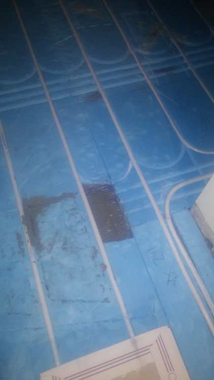

  4. 300mm pipe spacing does seem big, on tile flooring you'll notice the heat spacing unless you have really thick screed. Id opt for smaller and dial back the temp.

  10. With UFH you need to assume constant heat to make the most of it, otherwise a cold slab just takes too long for weekend working. We put in two over sizes radiators, on their own zone off the ASHP. With insulation all round (except the slab), and within an hour it's toasty warm for that sudden bout of working or playing on there!
