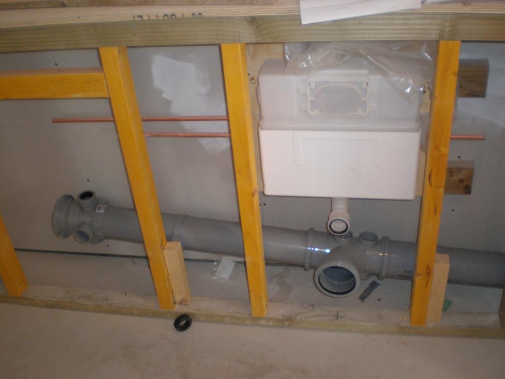

  1. @Nickfromwales i am not 100% sure if my comment was misinterpreted. what I was trying to say that it considered best practice/common with public health engineers to not combine the WHB and WC branch before going to vertical stack (this is why 99% example show it done this way), Please find attached a quick sketch. I appreciate that the non-common way may work for your installation and others (more than one way to skin a cat). thanks Ryan Epson_29062017073828.pdf

  3. What is going to be connected to the end of the drain? Was it your WHB? if so you should have a separate branch going to your stack and not connected to you WC.
