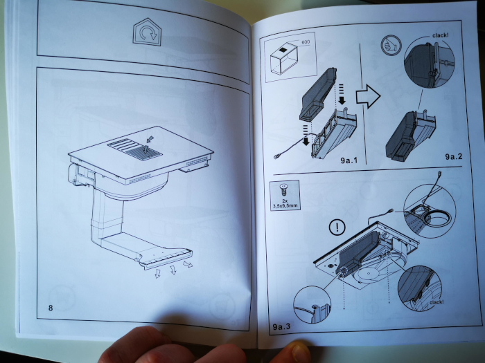

  4. Hi. I am needing to purchase ducting for our AEG combohob to complete a recirculation setup. I know these pieces are purchased from AEG directly. Problem is, I cannot find a piece shown in the manual on AEG's marketplace. I am hoping that someone here has also installed the AEG combohob with recirculation and can point me in the right direction. The part I need to find is the item coloured in light grey in image 9a.1. I am aware that the dark grey is the carbon filter but I do not know, and cannot find what the piece is that connects between the hob and carbon filter. Does anyone have any ideas. AEG themselves were not too helpful...

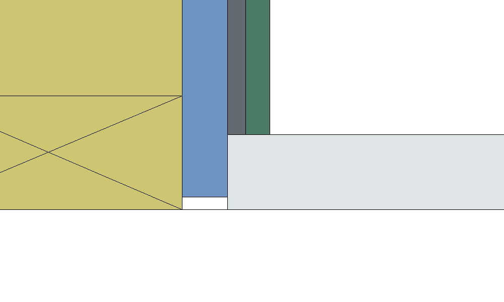

  24. I am a while off tiling yet, but will be setting out the bathrooms imminently and want to double check I have understood the makeup of tiling around the shower tray correct. One of our shower trays in enclosed and has studwork either end of the shower tray, so want to ensure I am leaving adequate space for the shower tray etc. This is a cross-section of my current understanding. Moisture board (blue) fixed to studwork (yellow). Shower tray (light grey) butted against the moisture board. Then tile adhesive (dark grey) applied to moisture board and tiled (green). Am I correct in saying there is a 6mm allowance for tile adhesive and a 'standard' porcelain tile has a depth of 8mm?
