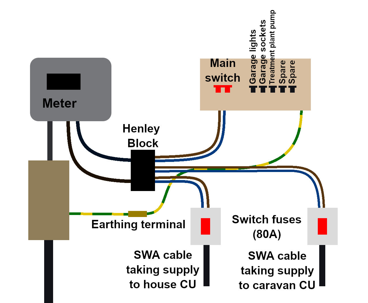

  12. Perfect. I think that's exactly how I had it: What do you reckon about the quote below? Is three core SWA needed for the caravan if we're TT earthing: Other than this, does all look ok with my plans? It's my first time doing electrics of this nature, and would prefer it not to go bang! But at the same time, determined to do it to learn some great skills. From the garage CU, I'm planning on running another SWA cable for the treatment plant pump since the cable is going outside, but the garage circuits just PVC insulated cable.

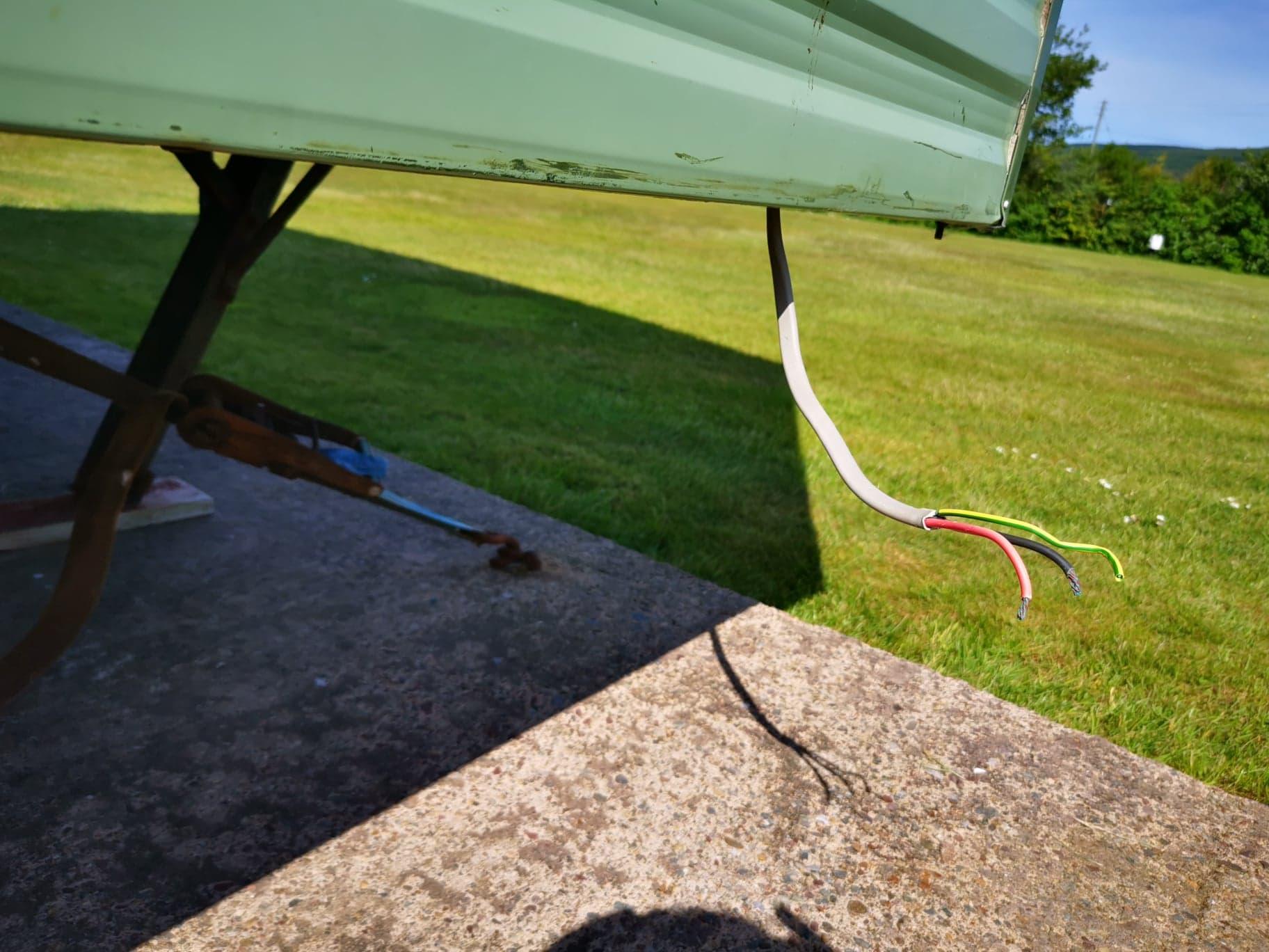

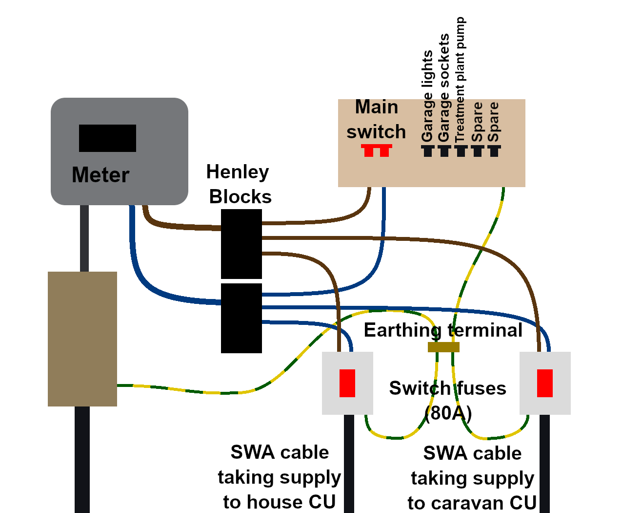

  13. @PeterW @ProDave Thanks. Attached an updated drawing. I've updated the setup so one Henley Block to cover live and another to handle neutral. I now have earthing connected to the terminal from the switch fuse/origin of the SWA cable on the diagram. Is this correct? I have attached a picture showing the current state of the electricity connection point on the caravan we've purchased. To confirm what I will do; I'll remove this cabling up to the CU position and run the SWA cable in it's place. Upon entry of the SWA at the caravan CU, I would install with an insulated gland. I'd earth the insulated gland to the CPC in the caravan and then from the CPC (which would already be prewired to earth everything else in the caravan), I would install a TT earth, with the rod exiting the caravan and fitted securely in to the ground beneath the caravan. The SWA would still be earthed at origin as shown in the diagram. Because the caravan has a TT earth, would I need a three core SWA for that sub main or should I use two core? Since the earthing wire in this sub main - if we used a three core - wouldn't be needed as we are using TT. Let me know if I've misunderstood anything.

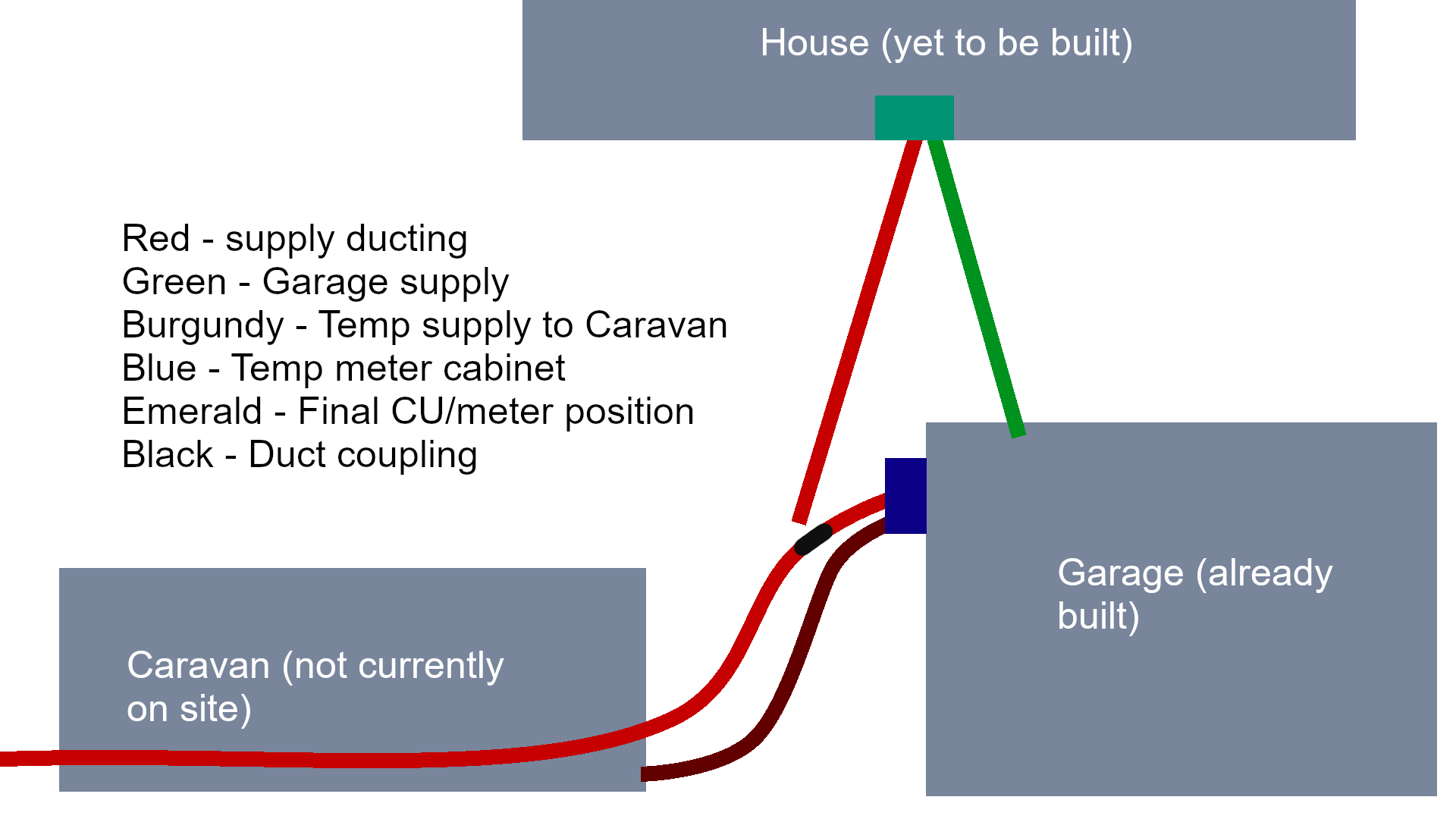

  21. Thanks for that @ProDave. I can see this is going to be a great learning curve, looking forward to getting stuck in with it all. So to review it to make sure I have understood each point: - SSEN will take the connection from terminal to permanent position inside the garage and the supplier install the meter in this position. The meter connects to i) a permanent CU in the garage (next point) and the switch fuse. - Connecting to the meter, we would install a permanent CU, which would feed 1) the garage circuits, 2) the caravan (which needs to be TT earthed instead of PME) until it leaves site and 3) any other site sockets positioned close by if desired. - Also connected to the meter separately would be the switch fuse (fitted with an 80A fuse). - The switch fuse would feed the house with a SWA cable running from the switch fuse to the finished property once built. Once the SWA cable arrives in the property, I presume this would then go through a second CU positioned in the house to manage the individual circuits inside? By installing inside the garage in a permanent position, would we still require the meter cabinet or can we install directly to a backboard/sheet of plywood considering it is positioned inside and undercover? Going back to my OP, would either of the linked ducting be sufficient? I have noticed the second link states Class 3. It this better or worse than the required Class 2?
  22. A sub main would include having the meter at one end and consumer unit at the other? In the SSEN guide, it says 'The length of cable between your supplier’s meter and the consumer unit must not exceed 3m'. In another thread, I saw you answer this by saying installing our own switch fuse would allow us to increase this 3m distance (garage to final CU position is around 9m). https://forum.buildhub.org.uk/topic/3030-new-electric-supply/?do=findComment&comment=47128 So you'd propose installing the meter, temp CU and switch fuse to a backboard in the garage, run the supply to the caravan, and then also run a supply to the CU installed in the house when available? Then when moved out of the caravan, removing the temp supply and temp CU.

  24. We are having a new connection installed in the next few weeks by SSEN - our local provider in Scotland. I want to run a few options by the Buildhub community so I can work out what is best in our situation. We will be living on site during the build in a static caravan so would like to install the connection for temporary and permanent use. I've attached a diagram showing my thoughts right now: - I'll excavate and lay ducting in all areas (red, green and burgundy colours). - Initially, there would be a temp meter cabinet next to the garage. - The supply will run through the ducting via a ducting coupler towards the temp meter cabinet. - When we are ready to move the meter to the final position, I will reroute the cabling through the previously laid ducting going towards the house, attach the ducting coupler to the duct running towards the house and remove the temporary ducting previously used. - I will build boxing around the coupler to allow ease of access later for this to be changed. - We will pull through enough cabling to get us to the final meter position, so would likely mean extra cabling would sit beneath the temp meter cabinet. - Until we move to the final position, the unused ducting lines will be capped off. - Once the meter/CU has been moved, the cabling to the supply the garage will be laid through the prepared ducting. We had considered both options - install the meter/CU in a temporary or permanent position outside - and we're leaning towards repositioning after the house has been built for aesthetics. Are there any other benefits to having this installed in a permanent position immediately other than the cost of repositioning (how much would we expect this to cost)? On a separate note, SSEN have requested ducting meet ENAT 12-24 standards of at least Class 2. Many suppliers advertise their product as electric cable ducting, but do not advertise which class the product is. For example, would this or this suffice? I see some suppliers advertising Class 3 ducting. I presume Class 1 is the highest, and 3 the lowest and therefore not suitable? Is this the best way to handle the ducting in this situation? Does anyone have any other solutions other than using a coupler to reattach the ducting to a different line? Thanks in advance!
