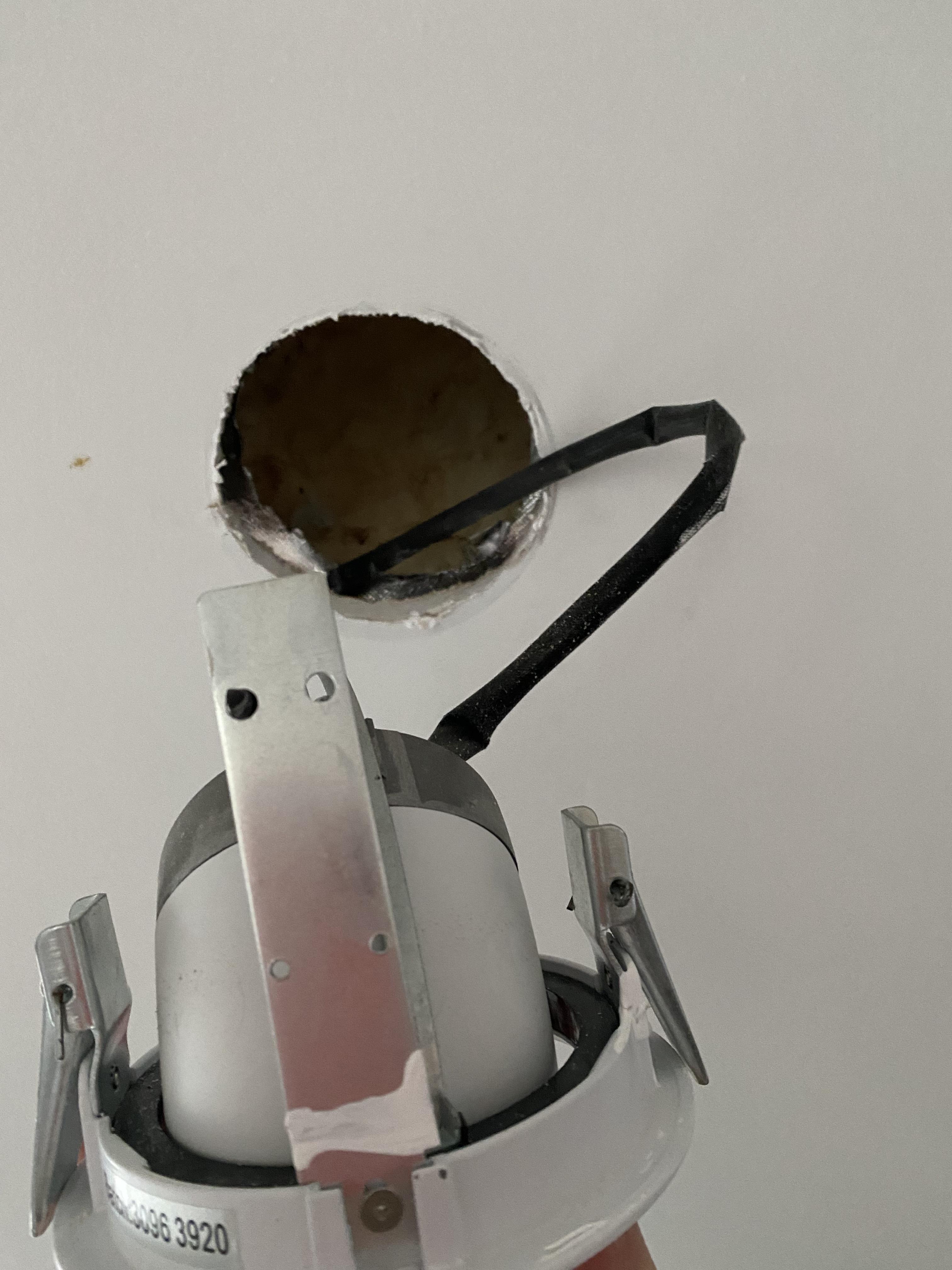

  1. Fortunately the wires run between the plasterboard and the membrane, so thinking I should be able to fit the hood/cowl directly into the insulation (dab of expanding foam to secure) and then tape the membrane around the edge?
  2. Thanks for your replies. The house was built during lockdown on the Isle of Mull, so we didn’t get the chance to inspect the build in detail and many details like these lights were left to the builder so as not to delay the build and we had no reason to think they hadn’t been installed correctly. There wasn’t a physical air-tightness test as far as I know - it was done using a simulation/estimate of 7m3/h/m2. I’ve seen some plastic cowlings, Thermahood, so will look to fit them.
  3. Been in our self-build 18 months and always noticed there being a slight draught on windy days and there’s sometimes a condensation ‘spot’ on one of the windows. House was built for us by local builder and has been signed-off by BC, completed EPC etc. We have 12 eyeball downlighters on an angled roof and curiosity got the better of me - dropped the light to find that they had been installed by cutting through the foam roof insulation and roof membrane, leaving a draughty void behind. Before I go back to my builder to ask them to put it right, what is the solution I need to ask for?
