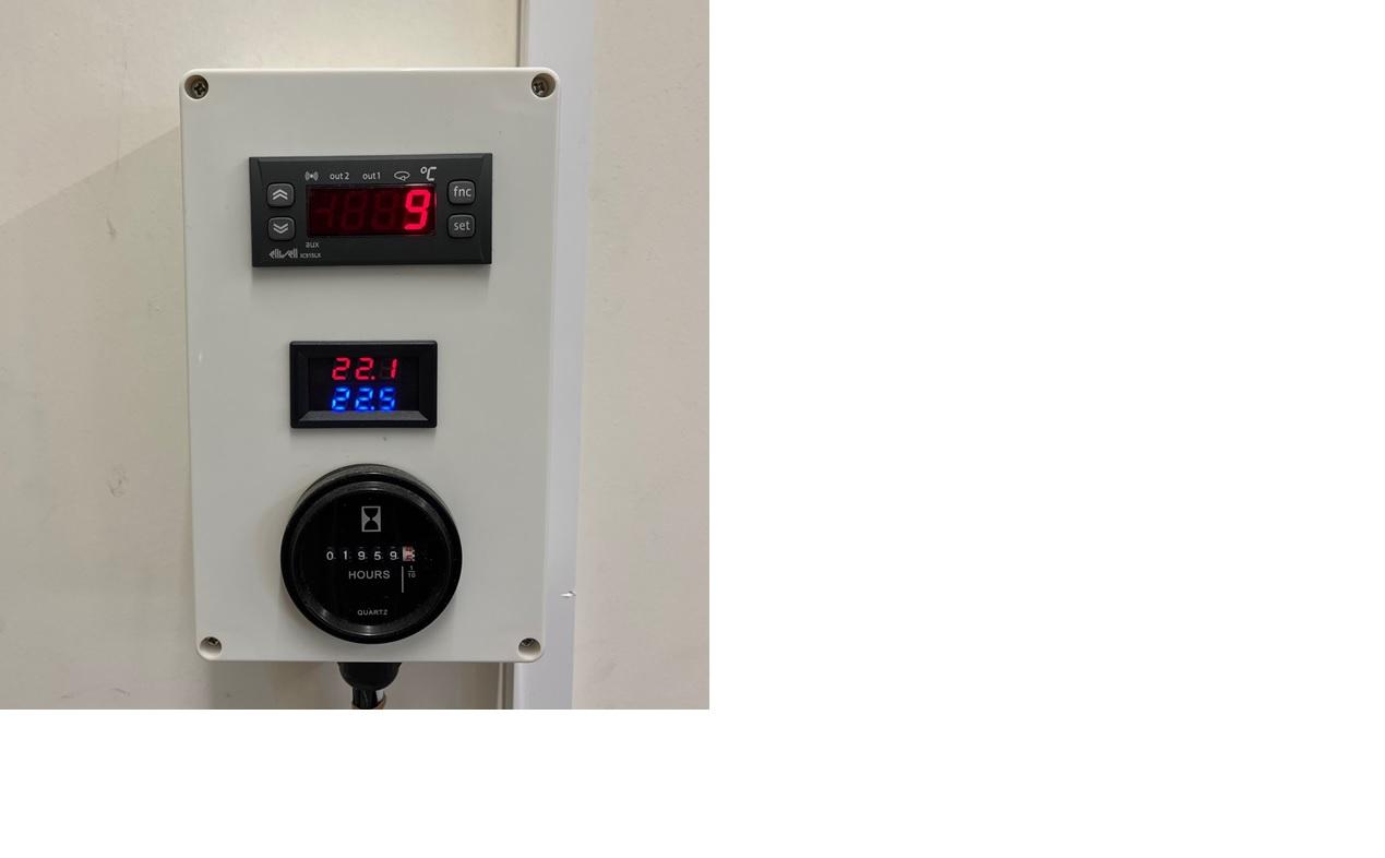

  25. I built one of these, ( disregard the number on the top unit I only powered it to take a pic briefly) . So the Elliwell unit controls the boiler and I run it until the flow reaches 60c where it the cuts out. I can then set a differential figure which I set to 14c in the autumn and spring and 12 or 10c in the winter depending on the weather, at 46c it restarts the boiler for another heat cycle, reaching 60c it shuts down again. My oil boiler runs both under flow and rads and these figures are the sweet spot for both. The under floor flow is set to 40c and again I increase it slightly if the weather is very cold. These figures give me a return flow of around 42c ish. The unit below the Elliwell is a Flow and Return lcd read out and the unit below is an hour meter that clicks on when the boiler is running. Boiler runs for 500 hours per heating season, we have a large PV set up the provides DHW from March until about early October.
