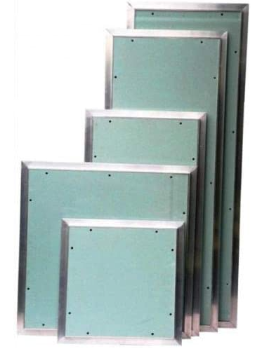

There are some plasterboard access panels that leave a very clean finish once skimmed and painted. The ones I have found use 12.5mm plasterboard and I have 15mm. Has anyone found ones for 15mm plasterboard?
They do look great. How much void do you need above the plasterboard for these?
