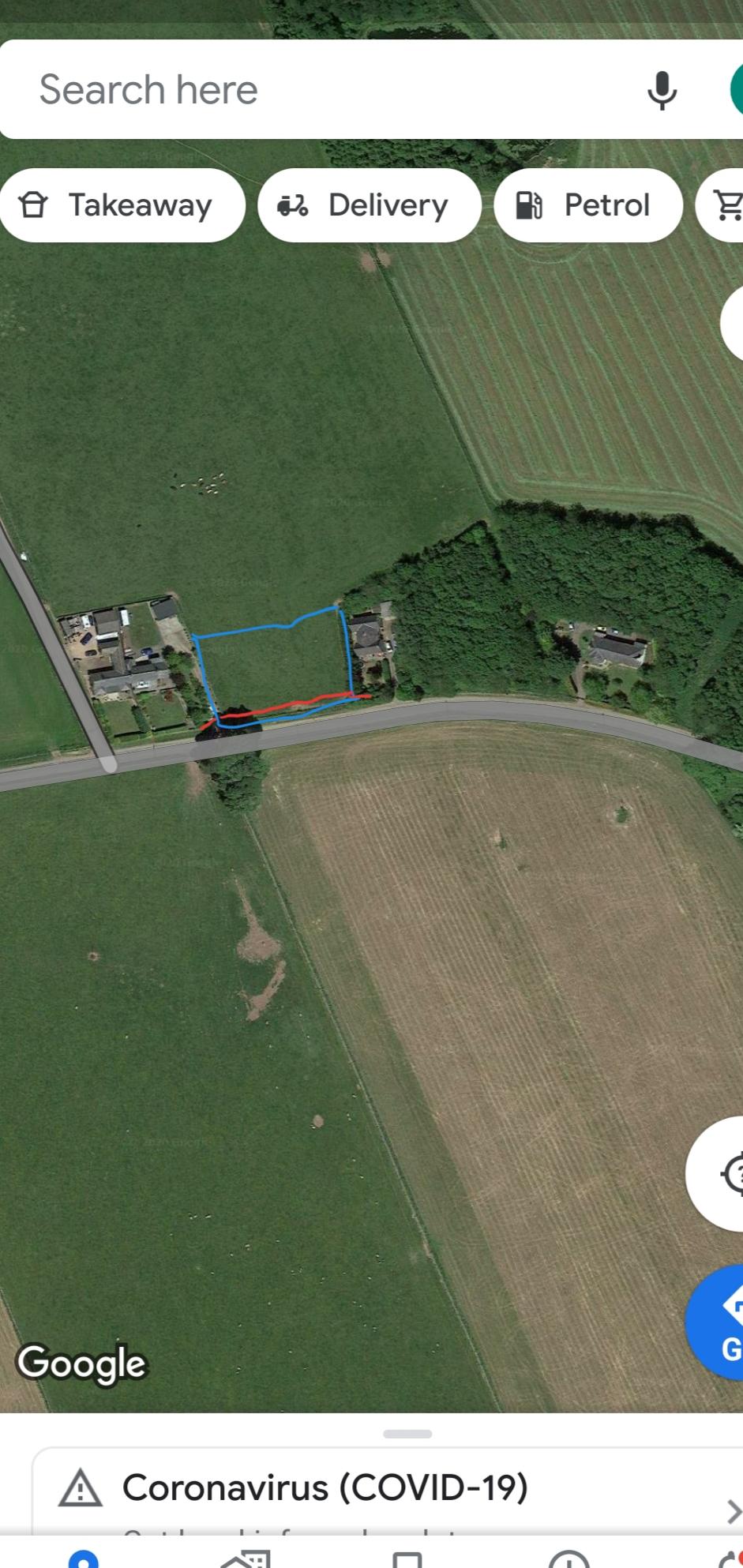

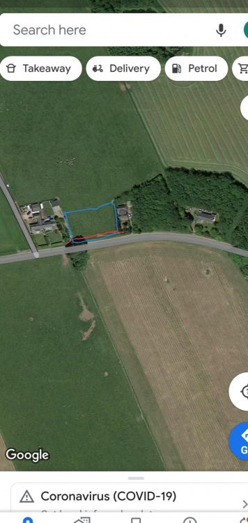

I should of done this from the beginning guys my apologies. The blue box is my plot boundaries. The red line is the pipe running through the south of my boundary, just inside my plot. as you can see that is were I will need to put my entrance as no other way in. The pipework runs from the left (west) to the right(east) through my plot collection effluent from the houses, my belief is it continues east to a nearby farm then I'm unsure.
I will try upload some photos, I cant fence it off it runs right along my south boundary and that's the only entrance to my plot.
No it's not that, it goes along a load of houses and away. It's going away from my plot.
Hi, From what I gather is the foul water comes out 2 x houses septic tanks along passed my plot and away somewhere likely into a field or something (one down the road that is able to soakway).... I'm assuming as the ground for soakway isnt the best were I am
Hi Peter, From what I believe is the pipe comes from his septic tank then runs past all the houses in the area to god nose were. Replacing the pipework would be out question I think as I'm not sure who would pay for it. I'm looking to just sure up an entrance then forget about it. This has recently just been brought to my attention I have only owned the plot for 8 months.
Hello, At our plot exactly were we will be making an entrance to begin work,the neighbours cesspit pipework runs through (it's just 1 pipe roughly 2ft down) right at the southern edge, hes said we need to watch if were bringing heavy traffic into the plot incase it breaks it as it has broken before with the previous owner(farmer) plowing his field etc. My question Is what can I do to protect it just concrete it ? Or? Thanks in advance.
