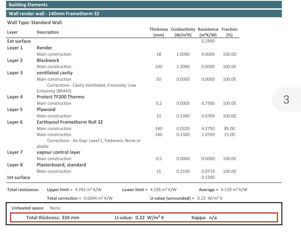

  2. Hi My builder saying he will change the walls to 140mm celotex pir at 0.023, what sort of u values will this produce? Currently 0.22 with 140mm of frametherm. Cheers Much Thanks Mike

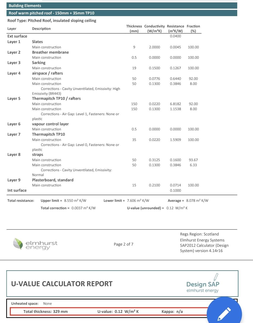

  4. The horiztonal part is to be 420mm(420mm in 2 layers over flat ceiling at F/F level) of wool i think and the sloping part is 150 PIR Insulation between rafters 20 PIR Insulation over rafters.
  5. Do you reckon add another 100mm of wool insulation to the walls? Or whats your suggestion? Is it floor and walls that need looked at? The roof is 0.12 but its a 1.5 storey sort of thing so that will be our walls upstairs.

  10. 145 i think it is Panels inc OSB to G/F Spandrel Panels inc OSB to F/F Panels inc OSB to F/F 145x45mm C16 solepate, headbinder etc 140 Frametherm 32 in ext walls Window stops / cavity closers Mid floor joists, assumed JJI's 150mm wool between joists 150 PIR Insulation between rafters 20 PIR Insulation over rafters 420mm in 2 layers over flat ceiling at F/F level 22mm V313 chipboard flooring to F/F Roof trusses 19mm Sarking to trusses
  11. Yeh i get it, We are going ASHP so want good insulation, we are coming in at 82B i think it is for SAP rating. 83Bfor environment. So for clarity if we put more insulation in it would perhaps be a 85B or such like? I have seen in one of the recommendations if we got a wind turbine it would increase us to 98A haha!

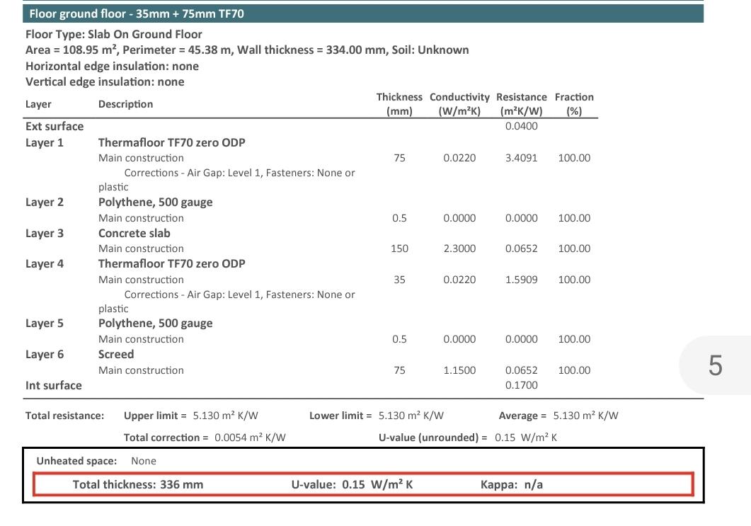

  13. Im not 100% sure yet its a TF definitely. What is the exposed floor meaning? TF with blockwork and render is think its 140mm of wool. Slab is 100mm pir below and 50 above. all relatively new to me so looking for advice.
  14. We got our u values back.... thoughts? Walls 0.22 (i think quite poor sounding) Ground - 0.15 0.14 exposed floor?? 0.12 - roof Any thoughts? Sound ok bar the walls.

  16. Is it better having 150mm in the concrete slab? Rather than above? I think they need insulation above to clip the UFH piping too.
  17. It is concrete slab i believe 150mm thick.
  18. Thanks bud, the 150mm pir is the floor.

  22. I think the house is going to be 140mm Frametherm in external walls and 150mm wool between studs? So im assuming thats 290mm altogether for walls - no osea U VALUES yet. 100mm in slab then 50mm under ufh? So 150mm in floors. 150 PIR Insulation between rafters then 20 PIR Insulation over rafters 420mm in 2 layers over flat ceiling at F/F level Any thoughts?
