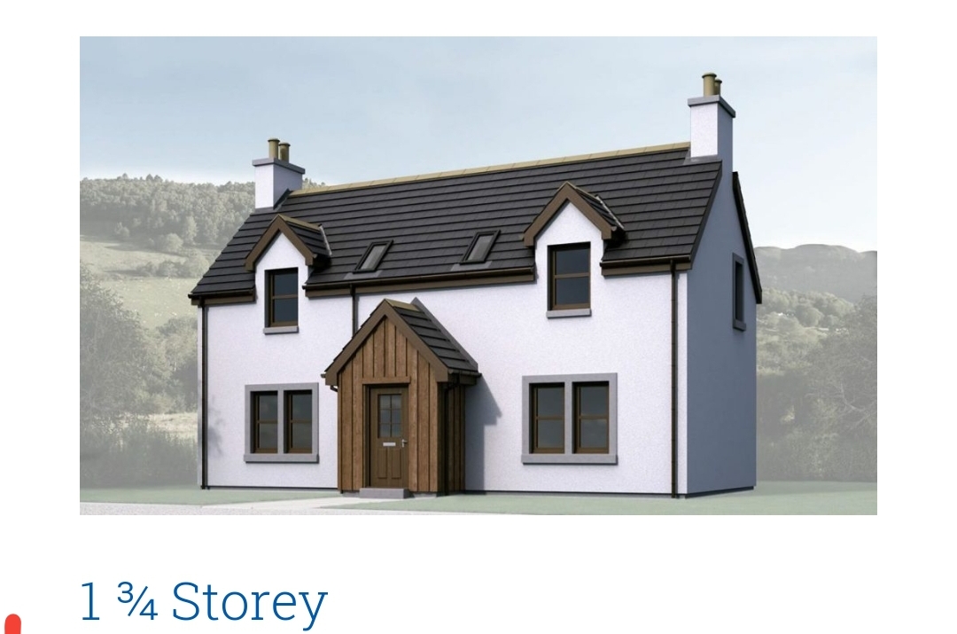

  5. https://scotframe.co.uk/house-style/pheasant/ something like this you mean, do you reckon that would be more cost effective to build than my current design? my wife doesnt like the wood cladding what do you think of one of these clad in sandstone instead? thanks

  8. Ill attach a similar one i saw on scotframes website what do you think of this compared to my design?
  9. These designs with all the glass etc are very expensive to build are they now? Cost is a big factor as well as design ill attach a pic i saw on the rob roy website of one with an arch it doesnt look that bad does it?

  14. The external finishes should reflect buildings in the vicinity and follow design guidelines in the PKC placemaking guide. E.g. is buff stone as proposed characteristic of the buildings in the area?Traditional materials such as slate roof and timber windows and doors would be appropriate heres what they said , we origionally thought barn style could please them but designer has adapted origional drawing to see what i thought as he has a lot of the detailed internal drawings etc already done for it
  15. ive been reading it again the planners didnt say specifically barn style they said The external finishes should reflect buildings in the vicinity and follow design guidelines in the PKC placemaking guide. E.g. is buff stone as proposed characteristic of the buildings in the area?Traditional materials such as slate roof and timber windows and doors would be appropriate so the designer has changed these materials on the drawing and lowered the ridge height from 2 storey and added these arches, like you say though mabye we should change the arches back and make it white render with possibly some stone features? one of the ideas behind going all sandstone was that its one trade rather than 2

  21. ive been looking they look like simple designs but it seems the cost is way over my budget
