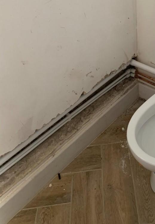

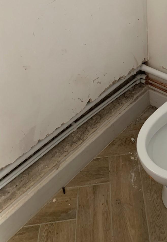

Chasing pipes into the wall and structural integrity

yeah only managed to get down there today. It’s mostly 30 to 40mm with the a small section at 50mm. -

I don't mind if the strength is retained but agree losing a couple of inches isnt a problem. -

Anyone know if they can be safely refilled? If a concrete block was refilled with concrete would that be ok? I'm guess it is not that simple. -

I'm not a structural engineer but if there was only a small piece of the wall removed I wouldn't be so worried. Why oh why is it so hard to find good people. -

It's a standard cavity wall. -

Yeah they are planning to fill -

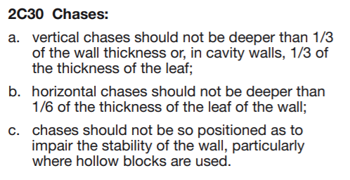

Well I guess the block work will have to be replaced. ffs. Unless I have misunderstood the building regulations. -

Yeah that was my concern, they blocks are 100 thick but I'll have to get back down there and measure the depth. -
