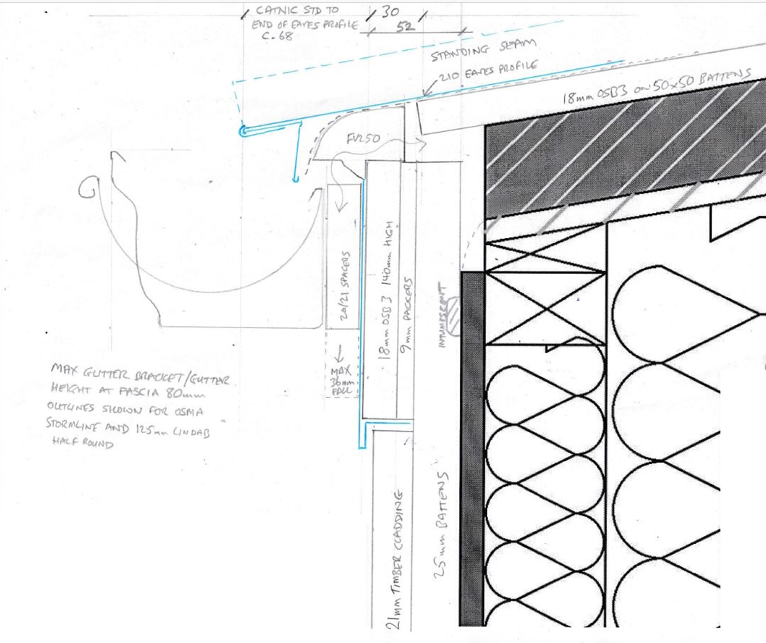

  4. thank you both for your thoughts - very helpful. 99% certain concluded as per sketch. Fascias first and clad over in trim to match roof. Cladding to underside of fascia (of any type!). No additional roof overhang with fascia planted on cladding which means not pushing beyond limits of OSB / standng seam. I can't be only one to have had this headache - move one thing to correct and something else is then wrong! It was more than just about wonky fascias on feather edge! please let this be my last conundrum!
  5. Evening all, We need to fix barge boards and fascias direct to horizontal timber cladding. If cladding is feather edge (visually our current preference) there isn't a flat surface to connect to - is that a problem or am I overthinking this? (if we use a lapped cladding it will be flat). any thoughts appreciated please many thanks

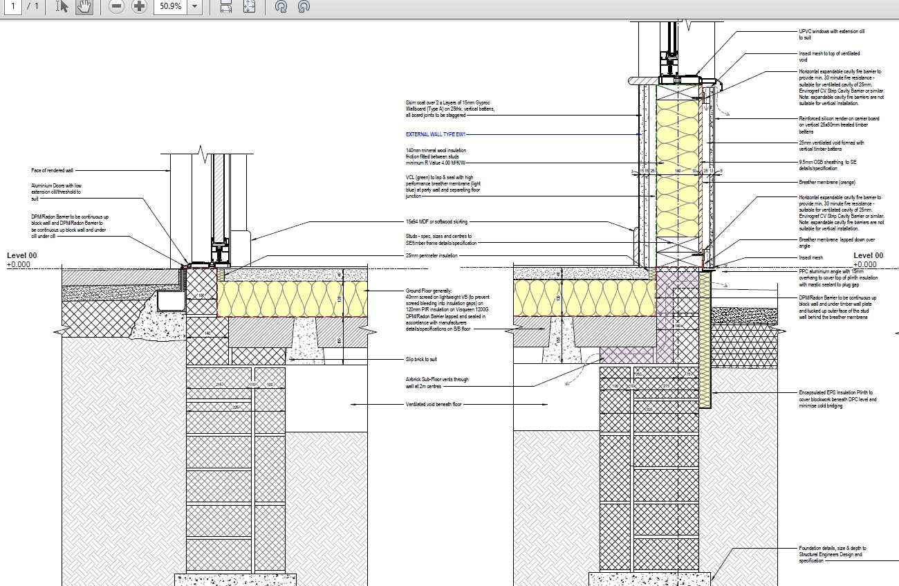

  16. Morning all, opinions and experience please on type / thickness of screed.....? beam and block; DPM wrapped up and over perimeter supporting walls sealed to DPC; 150-175mm PIR in 2 layers staggered joints and taped + upstands; membrane; UFH pipes; floating screed current intent is 150mm PIR + 75mm reinforced floating screed (type / spec tbc) Screed will be laid before walls and roof are on - timber frame company also building internal non load bearing stud walls straight onto screed. Reduces risk and grief! Continuous build with no option to down tools for a week or two whilst a screed goes in after roof on. Confusion and lack of trust now klcking in - screed companies quite excitable about liquid screeds and keeping to a minimum thickness and increasing insulation - which is fine. However, I'm now losing confidence as it seems the ones I had narrowed down to simply didn't listen with regard to the fact this would be open to the elements. Appreciate can't do any of the options in rain, but moving air (wind) and sunlight is unavaoidable! One has now suggested I put up a temporary roof which is bonkers! Sounding like I may need to revert to original intent? Which would be a shame as liquid screeds sound very good and also less cost! guessing I'm not the first person with this conundrum!
  17. block and beam in + course of 140mm marmox thermoblock (have a few left over to be ebayed!) + 2 courses of 140mm coursing bricks directly above 140mm fundation blocks below beams - ready for timber frame (larsen truss) soleplates. DPC wrapped up from under beams and will be lapped and sealed over top course with DPM which will be directly on beam and block. Then 150 or 175mm PIR (2 layers joints staggered and taped) + vertical upstand sections to screed level. Membrane over, open zone UFH pipes, 50 or 75mm screed. Outer skin of block/brick just to look nice and holding 75mm extruded insulation and sub-floor vents. Also keeps 'ground' away from supporting walls. Once timber frame installed the gap over bricks and 'foundation cavity' insulation will have horizontal section of extruded polystyrene - maintaining gap to underside of larsen truss and then sealed with precompressed tape. Then timber cladding................... BCO/structural warranty company happy.........

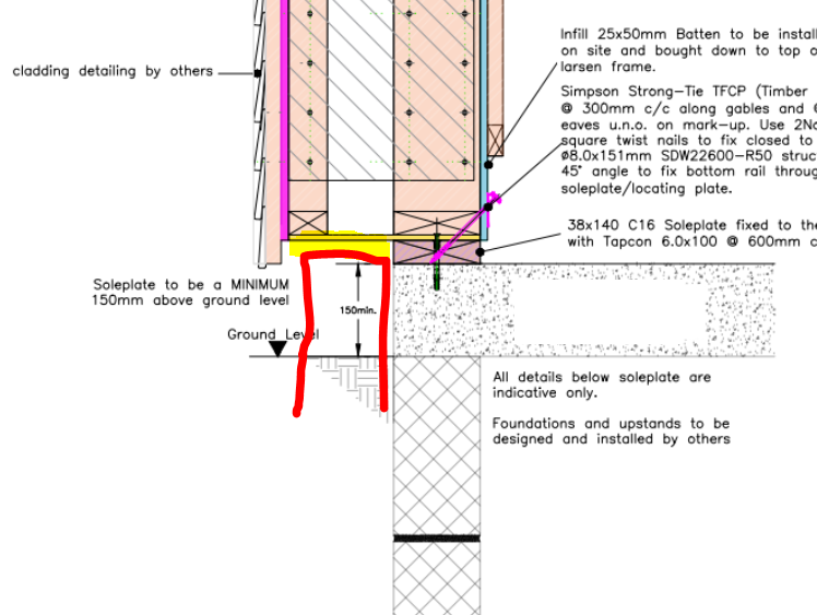

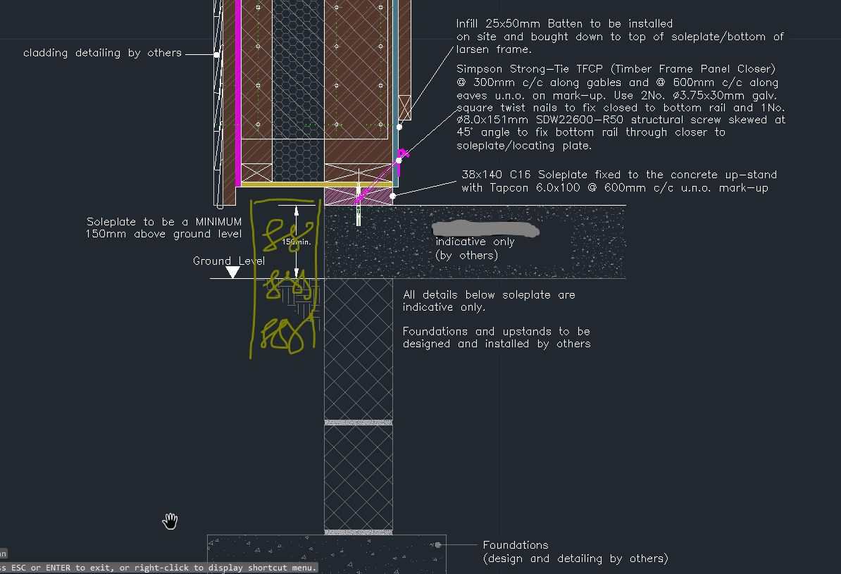

  19. everything on the 140mm. manufacturers response to question about gap: We’d expect a circa 10mm gap (for your yellow highlighted section) to the underside of the Larson so it wasn’t loading the brick / insulation cover. This could be closed with a compressible foam (compriband or similar). thermal bridge free - absolutely! if you've done this would appreciate seeing a detail please? for increased thickness we'll need to go down as height restriction in relation to adjacent stable block. hence wondering about beam and eps

  21. just found this which looks reasonably sensible (actually replicating one of my thoughts but hadn't got any further!) - be interesting to see the other section with beam ends. and not sure what happens structurally at the sub-floor vents!?

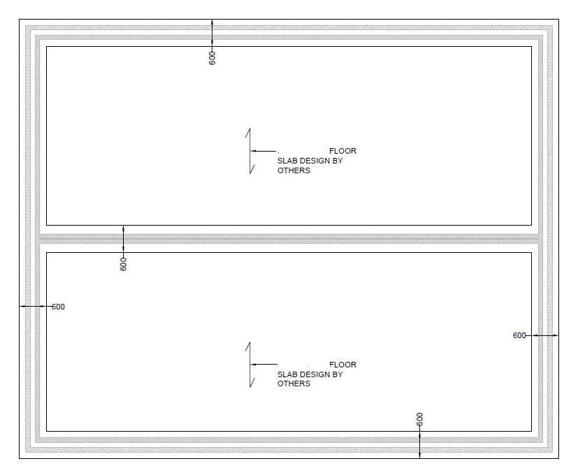

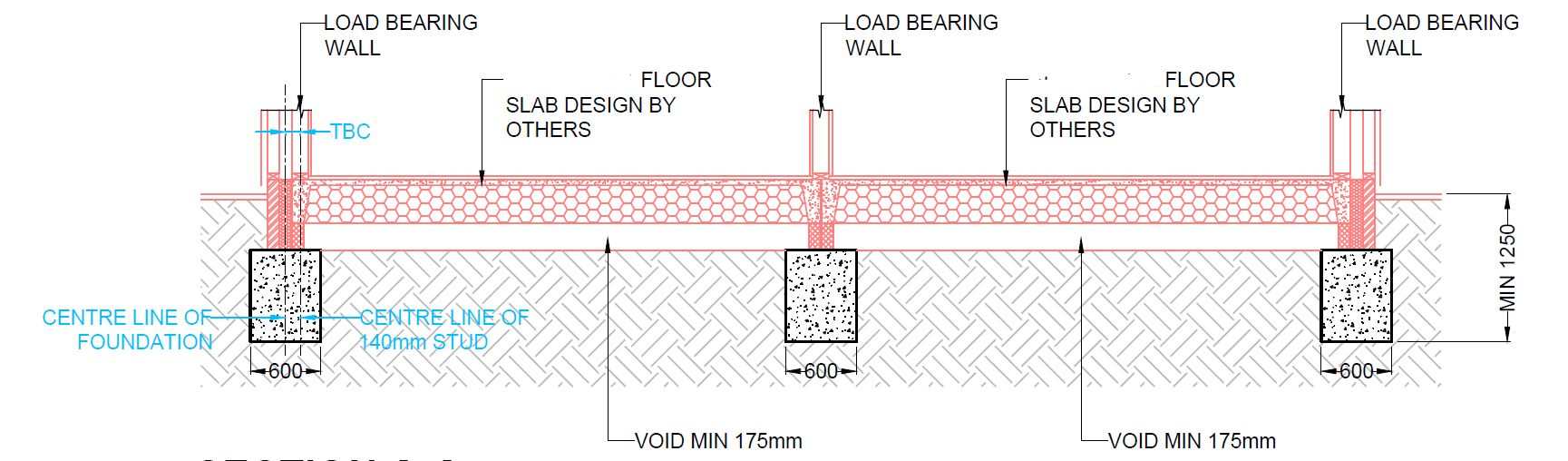

  22. nothing built. commence spring once ground dried up! but need to get ahead........... extracts of drawings herewith. 1. timber frame section (ordered) - scribbled bit will be insulation bonded on. May add brick plinth? But probably just insulation as you would with raft and rendered over, or bitumen, or a capping of some sort. 2. SE foundation design (strip footings) - not final, subject to the design drawings for the insulated precast planks - which are overdue and getting nervous! 3. strip footings on plan with direction of planks.
  23. Good afternoons, I have also asked same question on an old post, but thought it worthwhile adding a new one too! We are using a larsen truss system from Timber Innovations (ie all the load on inner 140mm stud) and have to have suspended floor due to heavy clay, trees, hedges. We are at passivhaus high performance (won't quite meet certified due to form factor - not huge and single storey). Current plan is preinsulated planks (avoiding screeds etc) with timber frame sitting directly onto edge - so almost replicating a raft, but suspended. But getting very nervous due to long delays with design (need for coordinated drawings for submission to building control), therefore now urgently exploring other options. Seems to be a few beam & EPS products out there - but how to detail edges with no traditional masonry/brick, where to sit timber frame, and prevent/minimise thermal bridging. Plus dpc/dpm/ventilation detailing.......... I'm probably not the first one to be doing a lot of head scratching on this topic! Would appreciate any pointers please... many thanks kr.........ma
