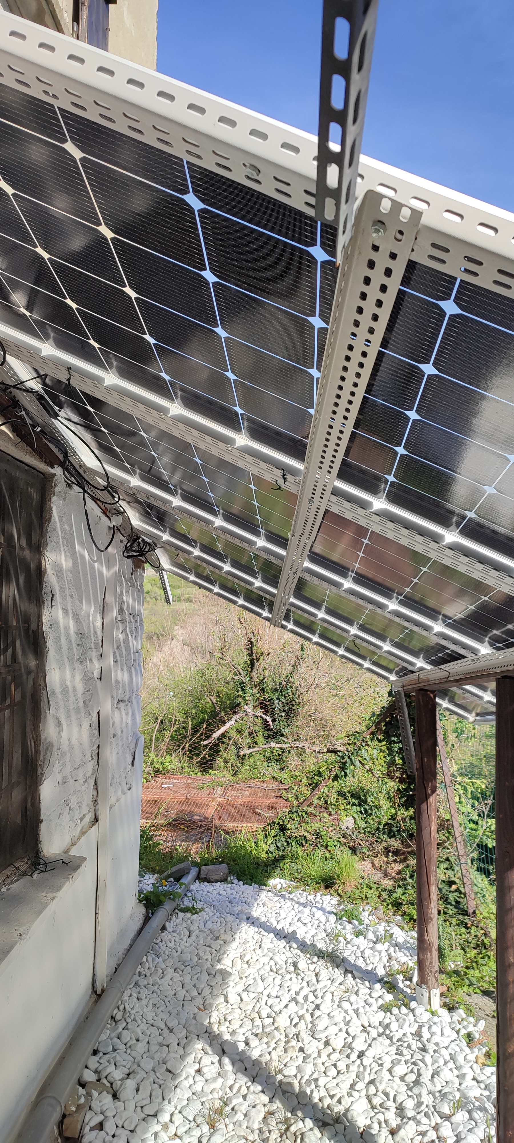

Luckeyly,I mounted my panels on the ground,where I can easily clean and service them....15 bifacial's on east-south strings.Today 17kw and my hot water boiler is 75°C.Northern italy,though🥰

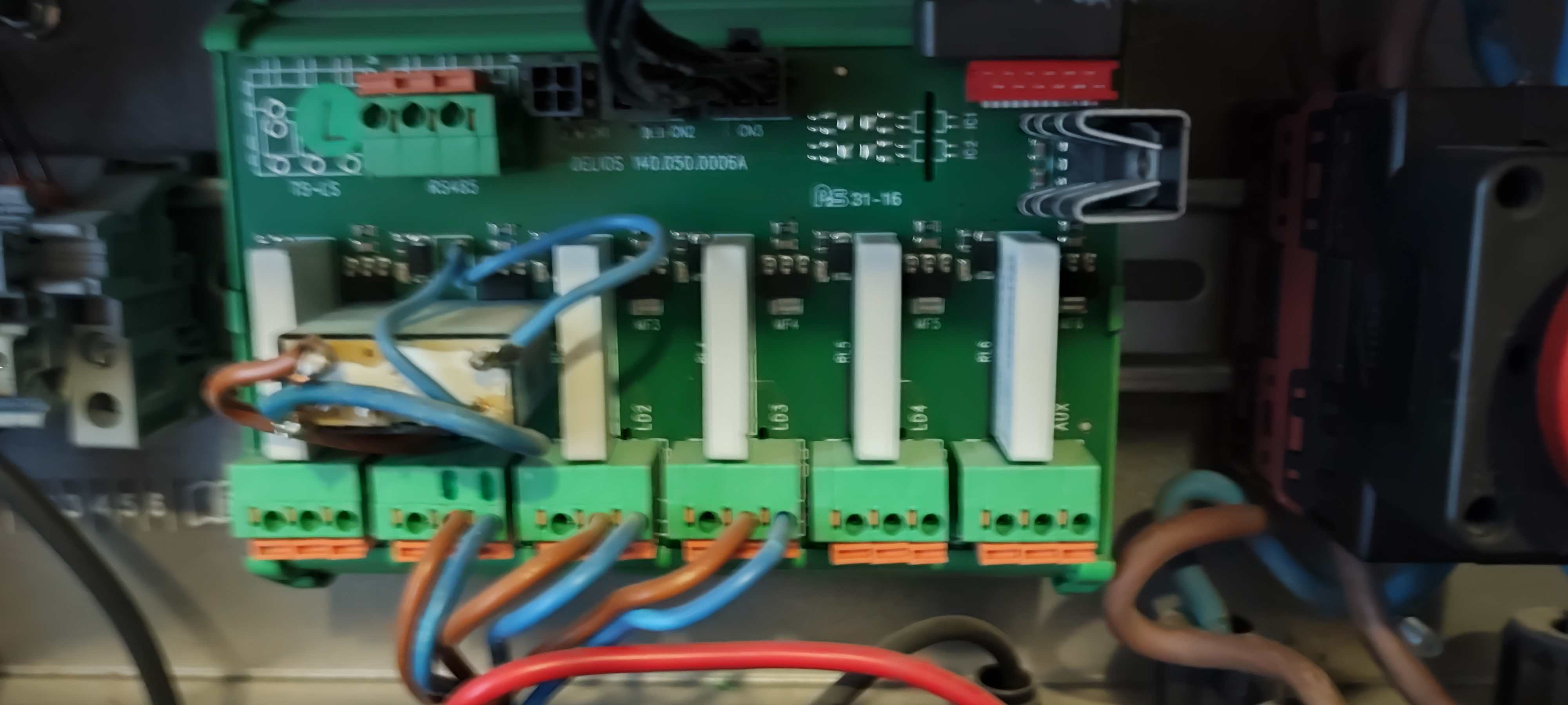

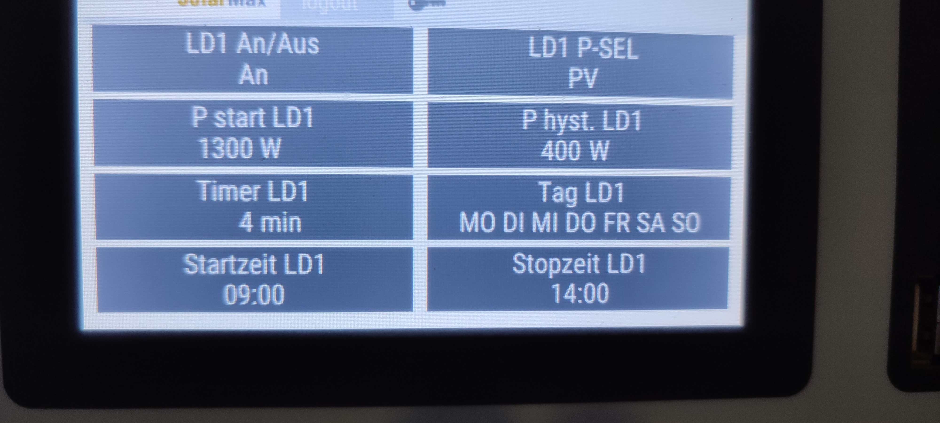

Hi there,I can control the switching of excess solar into my thermal-electrical water heater directly with my inverter .There's a relay card and from there I use 3 relays to swich a single heater with 3 elements,each one separately .As I couldn't find another inverter which does this,I brought my inverter "up to date" as it converted about 30MW and I was given the option either to change completely or change the parts which usually fail first,i.e. bus link filter caps,fans,relays etc....Frank
