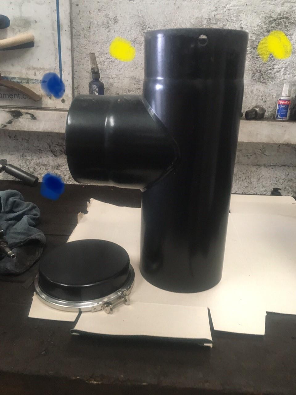

Stupid question time Presuming the yellow dots is the top as the female end of my flue pipe slides over it nice an snug. How do you attach the soot box cap?????? It wont slide over the bottom of the tee and theres no lip for the clamp to hook over. It slides over the yellow dot bit nice n snug but then the flue has to slide inside the tee if its used the other way up which cant be correct?
