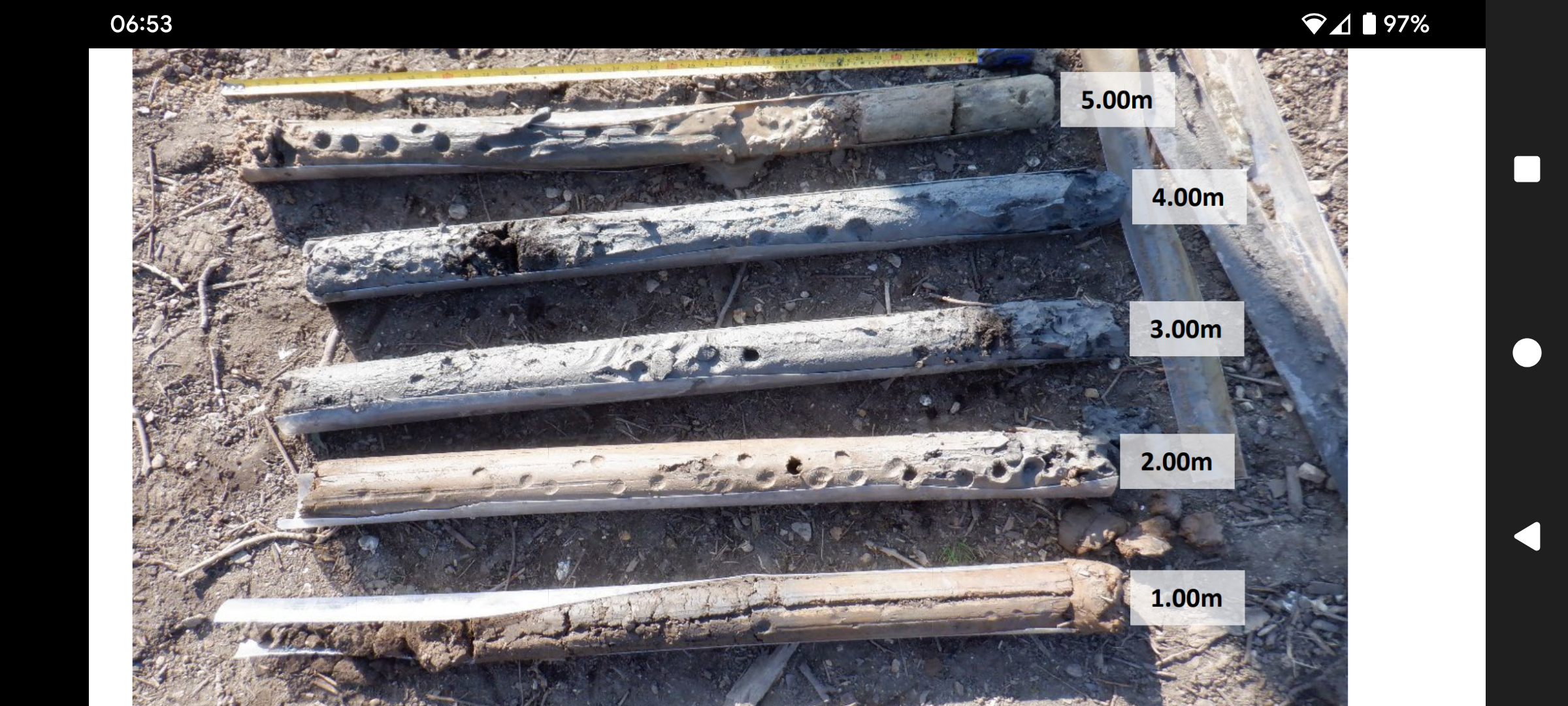

  13. Hiya I have been told by my structural engineer that his standard soil test depth is 3m but some warranty companies want deeper tests. Has anyone seen this. I can't see anything in the policy etc. Thanks
