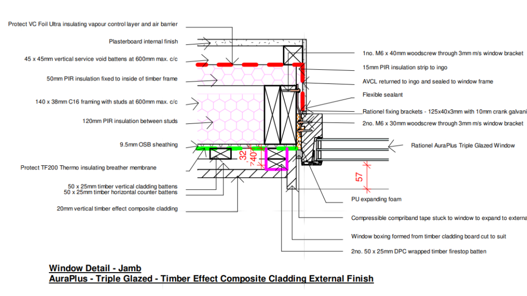

Hi all We are pondering how to get the best finish for our windows at the intersection of the window frame and the cladded wall. The timber frame house is erected "wind and watertight" with the windows and doors installed by the timber framed erectors. The windows will sit within the frame, then we have a 50mm void with cladding on top. We will have approximately 50mm of space between the window frame and the cladding that needs filling, and this seems impractical to cut such a small piece of cladding then use the required fixing strips etc. Has anyone found an elegant way to sort this out, or am I destined to spend hours cutting up cladding. The image shows my predicament. Thanks

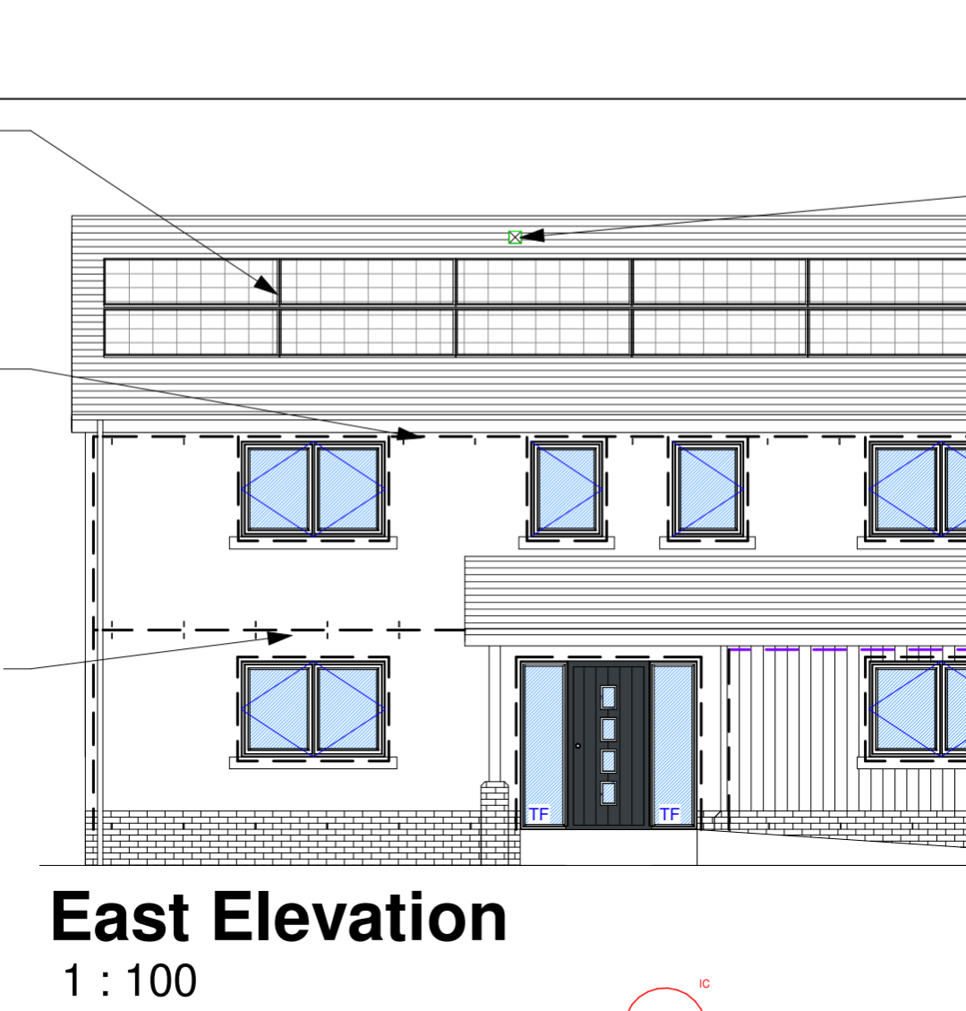

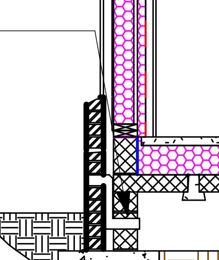

Composite Cladding intersection with brick plinth
Lincolnshire Ian posted a topic in General Joinery
Hi We are trying to work out whether we should do something about the intersection of the cladding below with the chamfered brick. The drawing isn't clear, but we intend to have a 10mm ventilation gap between the end of the cladding and the start of the chamfered brick. We are also planning to install some insect mesh. Should we have some sort of cill underneath the cladding? Even though the cladding overlaps the chamfered brick by around 15mm there is still the potential for water either running down the cladding, or during driving rain to enter the cavity. For content, the build-up on the TF house is Protect TF200 Thermo Insulating Timber Frame Breather Membrane over OSB board. Should we be concerned about this, or is this just how cladding works on timber-framed houses? Thanks -
