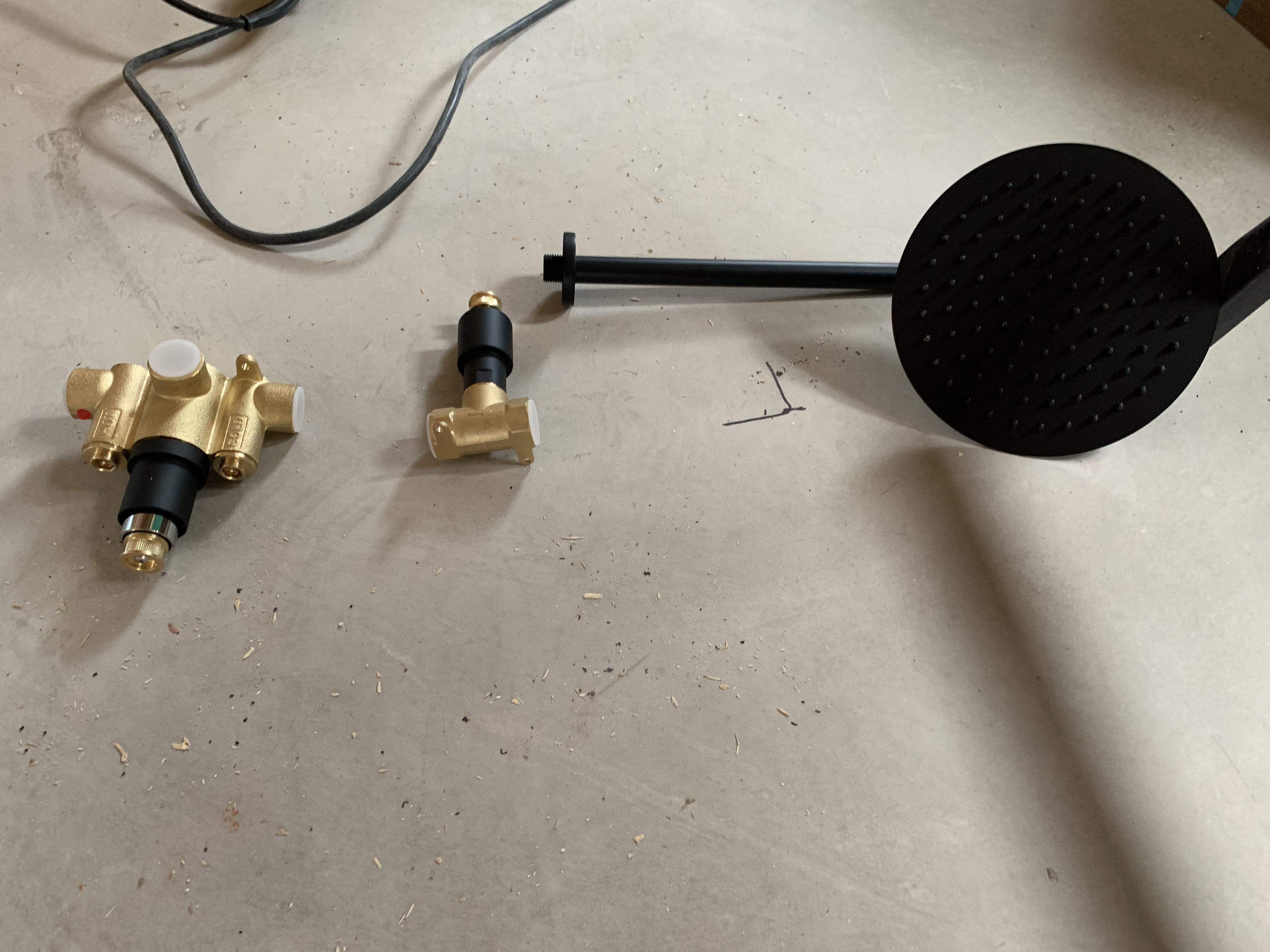

  16. Good to know. I'm replacing the existing radiators on the first floor and installing UFH on the ground floor, so I can oversize as needed. I'm running 100% off of my cylinder element at the moment, so maybe that's why I'm running out of water...

  19. Ah, interesting. I see you’ve mounted the valve and shower to the sheathing instead of the joists. Good idea! How did you secure your shower arm? My arm says you’ve got to use a back nut, but the thread is only 14mm. How are you supposed to get the thread through tiles, plasterboard, back nut, and compression fitting on 14mm!? ?
